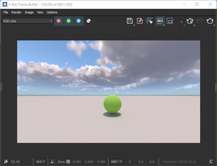

An example image of Clouds with "Ground Shadow" switched On:

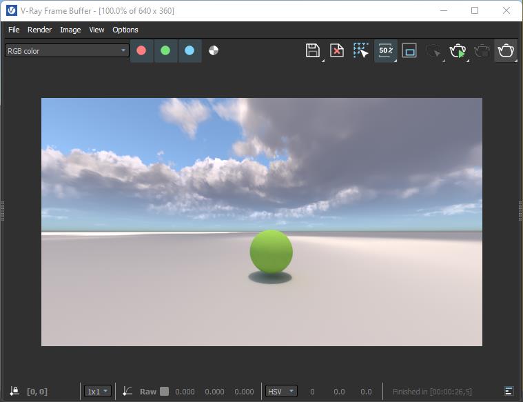

An example image of Clouds with "Ground Shadow" switched Off:
