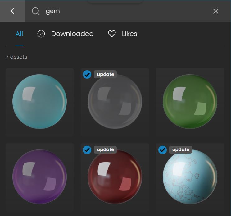

The Chaos Cosmos offers pre-made materials for a wide variety of purposes and this scenario is no exception. Both gem presets, as well as variants of precious metals, such as gold, silver and copper can be found in it. In addition to this, the scene will be lit using HDRIs from the Cosmos Browser.

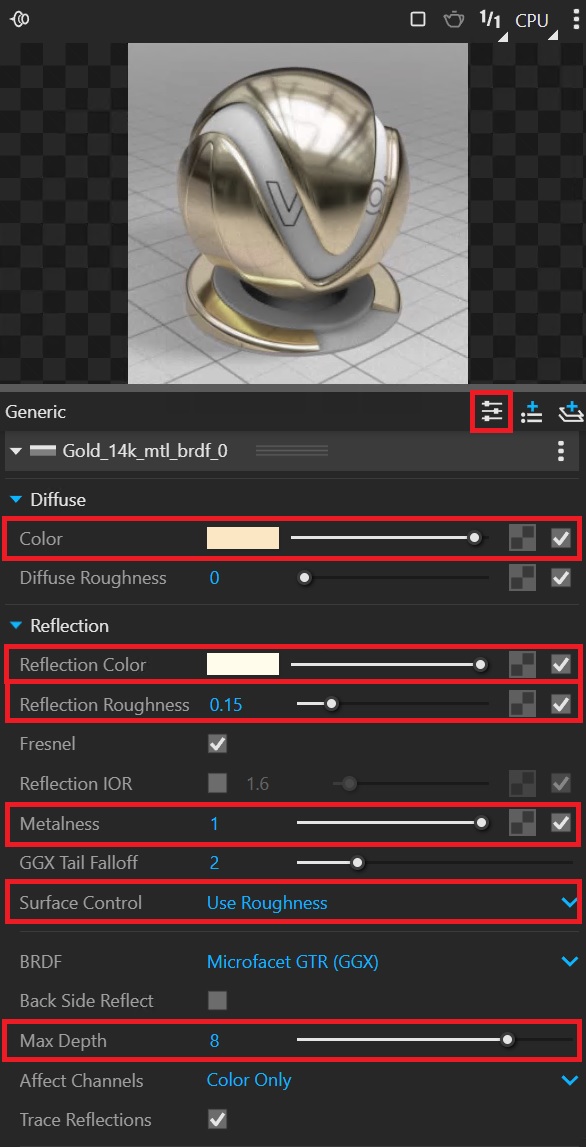

"Gold" is a relatively straightforward material to create. In this example, the goal is the creation of a "14k Gold" material. The starting point is the base ‘Generic’ V-Ray material with enabled ‘Advanced Settings’ and the settings are as follows:
  • The ‘Diffuse Color’ should be set somewhere between yellow and orange. In this example, that would be 251, 231, 196 on the 0-255 RGB color code;
  • The ‘Reflection color’ slider moved to almost 100%;
  • For the slightly blurry effect of the gold to be achieved, the ‘Surface Control’ should be switched to ‘Use Roughness’ and the ‘Reflection Roughness’ set to a 0.15 value;
  • For the metallic look of the material, the ‘Metalness’ slider should be moved to 1;
  • Finally, the ‘Max Depth’ is to be increased to a value of 8.

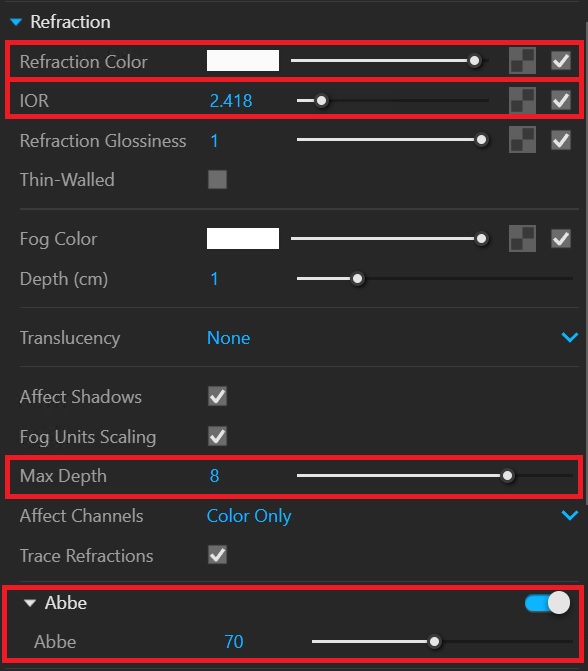

The gemstone is slightly more complex, but still a rather easy material to create. The starting point is the ‘Generic’ V-Ray material with expanded ‘Advanced Settings’ once again. The settings are as follows:
  • The ‘Diffuse Color’ set to black;
  • The ‘Reflection Color’ set to almost pure white;
  • The ‘Max Depth’ option in the Reflection increased to 8;
  • The ‘Refraction Color’ set to almost pure white;
  • The ‘IOR’ is an important value, which must be specific, rather than arbitrary. Since this will be a diamond material, the IOR is set to 2.418, as this is a diamond’s IOR value. Different materials have different IOR values and reference sheets are easily found on the internet. Their use is strongly recommended for more accurate results;
  • The ‘Max Depth’ option in the Refraction settings is set to 8;
  • Finally, another important parameter is the ‘Abbe’, which will give the material the distinctive iridescent effect. A value of 65-70 would be appropriate.

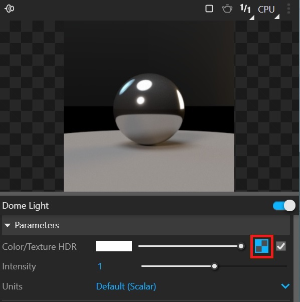

For the “Studio 007” to be applied to the scene, a  Dome Light will be created, which will be pasted into its ‘Color/Texture HDR’ texture slot.
Note: V-Ray and Rhino allow for rotation of the Dome Light to be made through the viewport and it is recommended to take advantage of this for the optimal lighting angle.

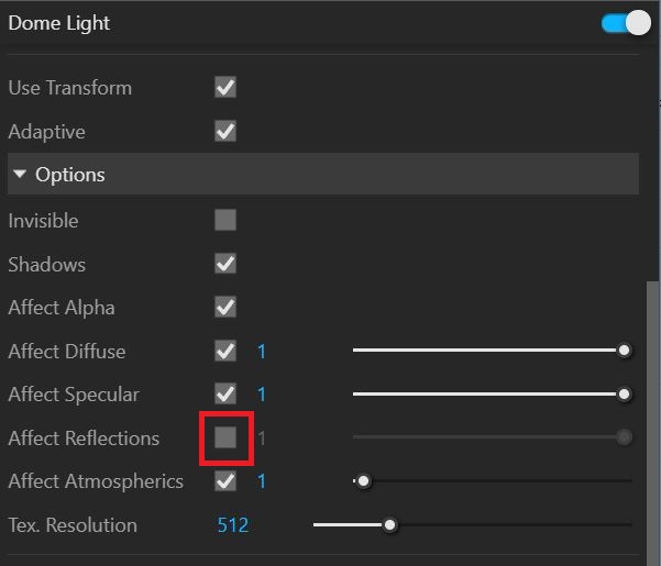

Environments can be mixed through a combination of the Dome Light’s Options menu and the V-Ray Asset Editor > Render Settings > Environment parameters. As an example, a different HDRI can be used specifically for for Reflections parameter, while every other aspect of the environment will be controlled by the Dome Light’s HDRI:
