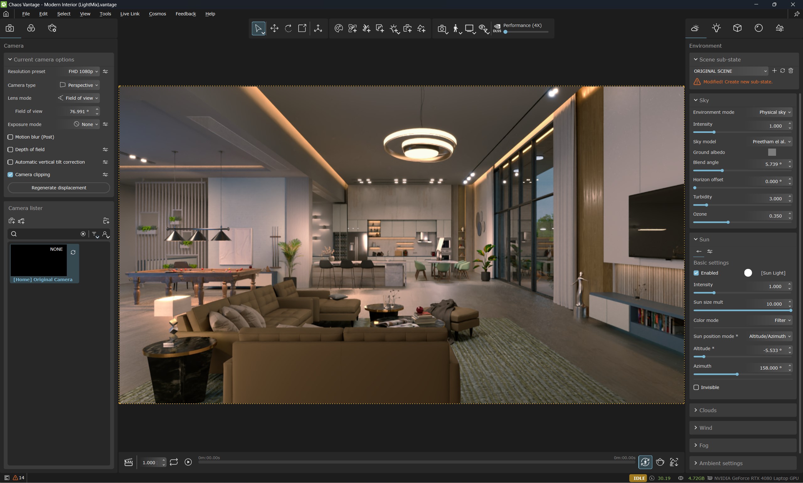

A Corona scene rendered in Vantage

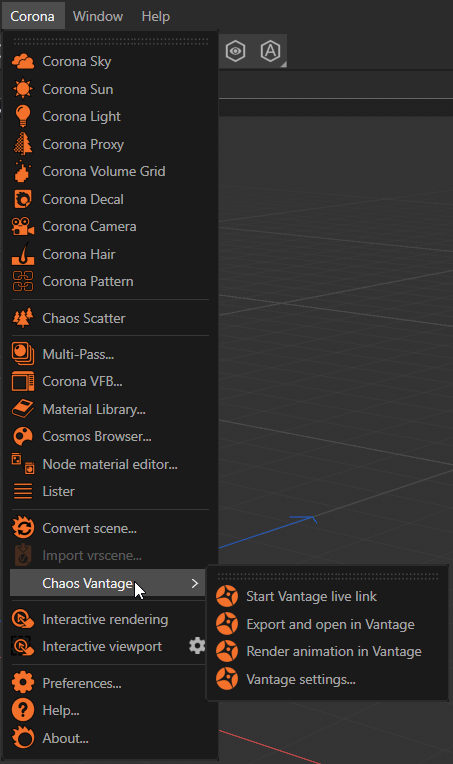

Corona offers multiple ways to export your scenes:
1. Start Vantage live link - Starts or stops the Vantage Live Link. In this mode, scene changes are automatically synced to Vantage, similar to interactive rendering.
2. Export and open in Vantage - This option exports the scene data directly to Vantage and automatically starts rendering in Vantage. A scene exported using this option does not require both software to remain open; you can safely close Cinema 4D once it's open in Vantage. In this case, the live link is not created, so the scene does not get updated automatically in Vantage.
3. Render animation in Vantage - Starts or stops exporting your animation to Vantage. This sends the current frame and timeline data from Cinema 4D to Vantage. In Vantage, you can then choose which frames to include. Once rendering begins, Corona automatically uploads the selected frames to Vantage.
For more information about this mode, see: How to Render Corona for Cinema 4D Animations in Vantage
4. Export scene - Exports the scene data for rendering in either Corona Standalone or Vantage.
The "Chaos Vantage" sub-menu is in the Corona menu. Exporting the scene from Cinema 4D to load it later in Vantage using the "Corona VrScene" file format.
Start Vantage Live Link:
  1. Open your Corona scene in Cinema 4D.
  2. Go to the Corona menu, click on the Chaos Vantage sub-menu, and then on the Start Vantage live link.
  3. Your Corona scene will now be exported and loaded in Vantage, ready for real-time exploration and rendering. The live link is already enabled, so any update on your scene project will be automatically ported to Vantage.

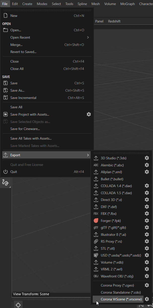

To export your scene:
  2. Go to the File menu > Export > Corona VrScene (*.vrscene) option.
  3. Using the gear icon, you can access additional options for the exporting process, like the "Open exported scene in vantage" checkbox, which automatically launches Vantage and loads your scene after the export process completes.
