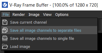

If you would like to export render elements from the multi-channel EXR file as separate images, you can easily do it from V-Ray VFB following the steps below:
  1. Load the EXR file from the Chaos Cloud in the VFB by File > Load image.
  2. Then from File > Save all image channels to separate files you can save render elements in the file type you would like.
