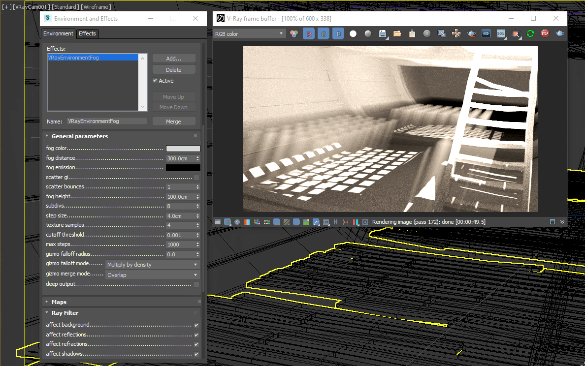

Add VRayEnvironmentFog effect from: Rendering menu > Environment > Atmosphere rollout > Add button > VrayEnvironmentFog

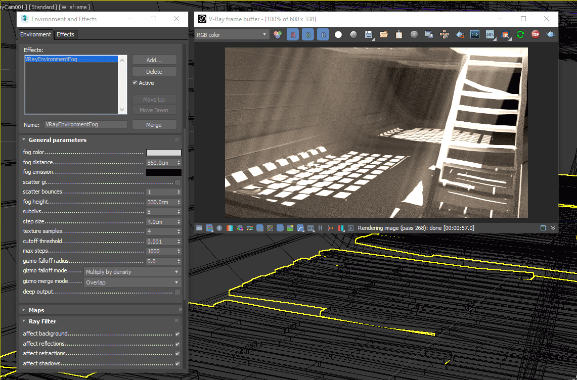

At this point, Environment Fog should be visible in the rendered image. To achieve a more convincing effect, adjust Fog Color, Fog Distance, and Fog Height parameters accordingly.
Fog Distance and Fog Height parameters operate in Scene Units. For easier setup, it is
recommended to know the size/scale of the scene.
4. The fog color parameter determines the color of the fog.

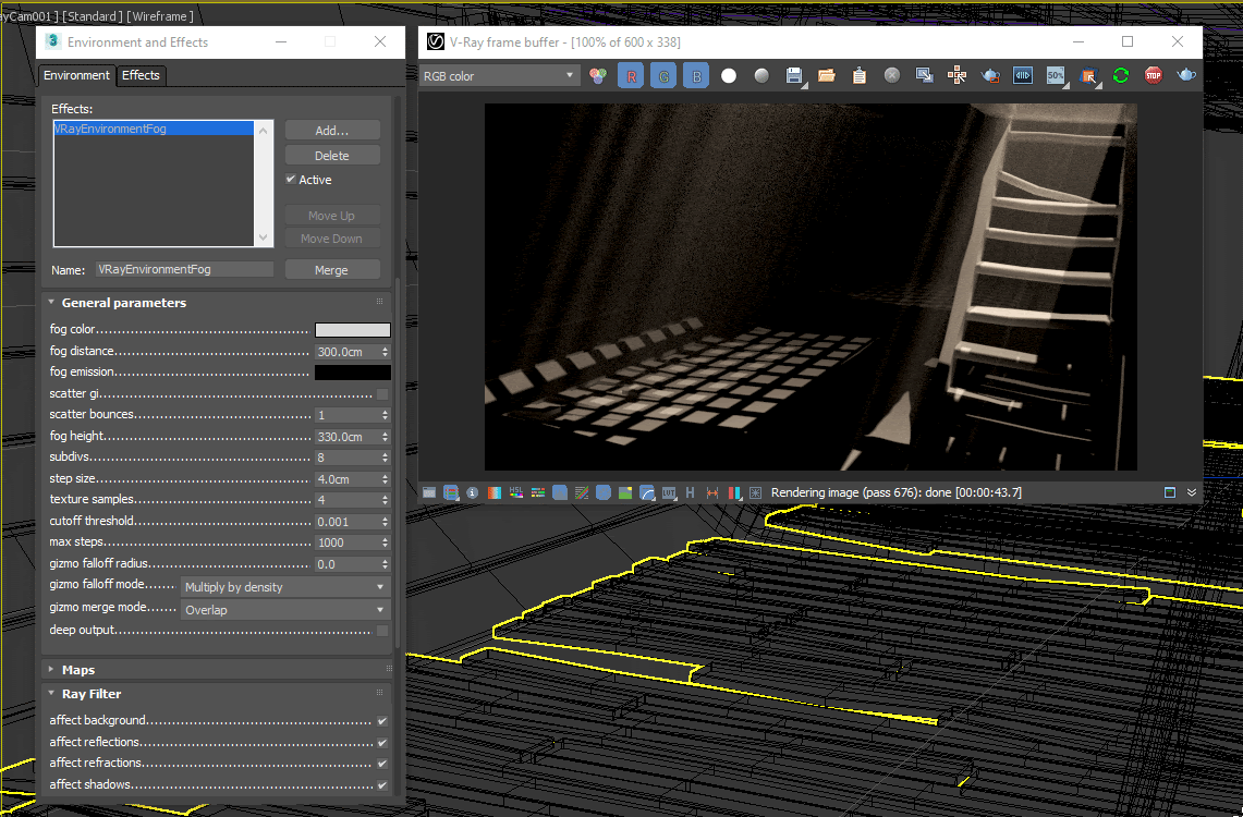

5. The fog distance parameter controls the fog density. Larger values make it more transparent, whereas smaller values make it denser.
6. The fog height parameter determines the height of the fog.

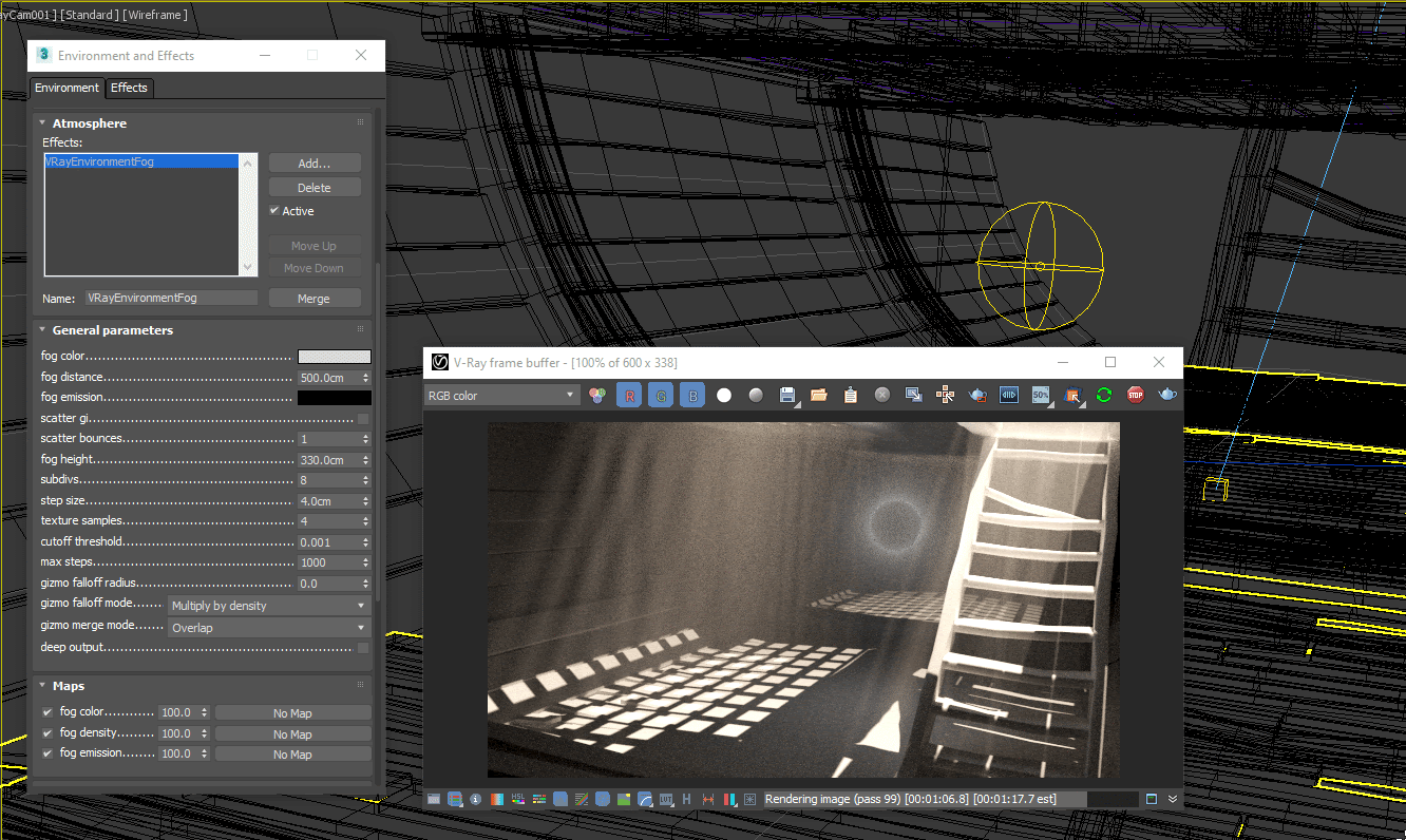

When multiple lights are present in the scene but you want only some of them to be responsible
for the god rays effect, you can include or exclude light sources by disabling the Use all
lights option in the VrayEnvironmentFog nodes rollout and clicking on the Add button.
For a more realistic effect, set the fog height to be higher than the position of the camera,
and if the scene allows it, to cover any visible part of the scene.
