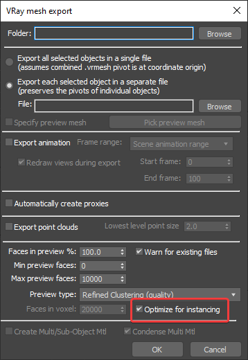

V-Ray Proxy export setting in 3ds Max

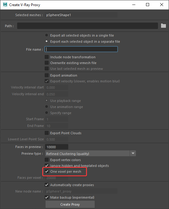

V-Ray Proxy export setting in Maya

2. After the geometry is imported in the DCC application, export it again to a V-Ray Proxy file with Optimize for Instancing enabled as shown in the previous section.
