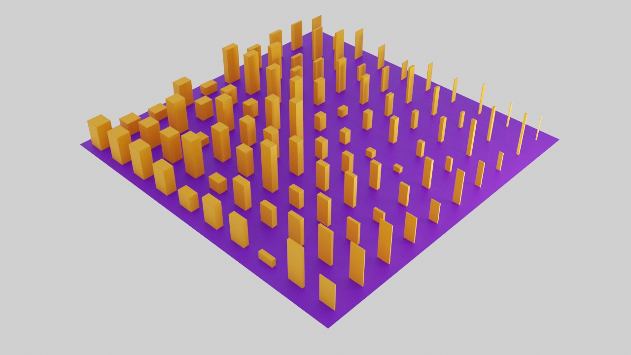

We have a scene created with Corona 3, with Corona Scatter set up with 3 different textures controlling the scaling of the scattered objects in 3 different axes:
This is what it looks like when rendered with Corona 3:

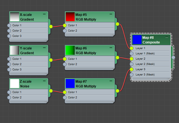

Since in Corona 4 and newer the scaling axes are controlled by RGB values of the scale map, we will have to combine the 3 maps that we are using into one. We will use RGB Multiply and Composite nodes for this:

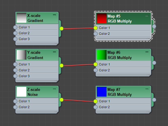

1. Create an RGB Multiply node in the material editor, and duplicate it 2 times to get a total of 3 nodes.
2. Plug each of your scale maps into each of the RGB Multiply nodes' "Color 1" slots.
3. The RGB Multiply nodes now need to be set up:
For the first RGB Multiply node (used to control the X scaling axis), set its "Color 2" to pure red (RGB: 255,0,0).
For the second RGB Multiply node (used to control the Y scaling axis), set its "Color 2" to pure green (RGB: 0,255,0).
For the third RGB Multiply node (used to control the Z scaling axis), set its "Color 2" to pure blue (RGB: 0,0,255)
4. Create a new Composite node, and add two extra layers in it, to have a total of 3 layers. Use the "Add A New Layer" button for this.
5. Plug your RGB Multiply nodes as Layer 1, Layer 2, and Layer 3 of the Composite node.
6. In the Composite node's options, change each layer's blending mode to "Addition".
7. Plug the resulting Composite map into the Corona Scatter's Map slot.
8. Make sure that Mode is set to "Legacy".
9. Make sure that Adequate checkboxes controlling which axis the map is applied to are ticked. The checkboxes should be ticked only for those axes which are controlled by the map. For example, if the Z axis was not controlled by a map in Corona 3 or older (the Z scale slot was empty), then the Z checkbox should be left un-ticked under "Map:" in Corona 4 or newer.
If you have followed the above steps correctly, the result of Corona 4 or newer rendering will be exactly the same as the original result of the Corona 3 rendering:
