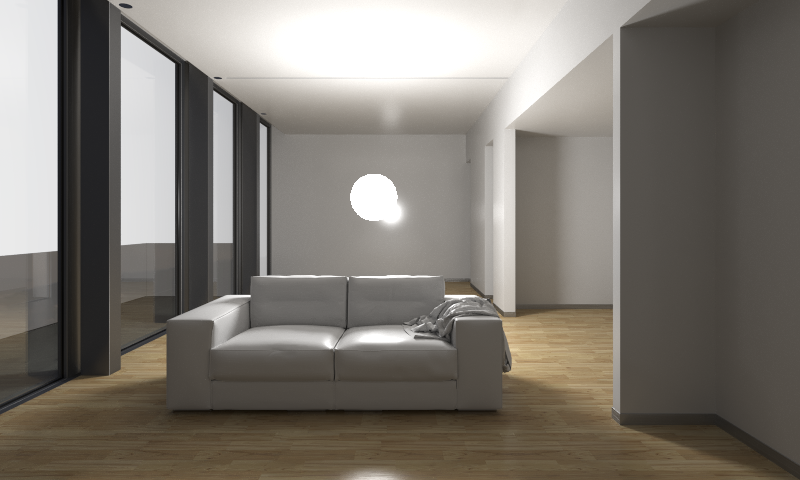

Test scene lit by a default Corona Light set to Object (Sphere)

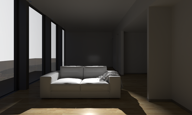

Test scene lit by a native Cinema 4D Spotlight
