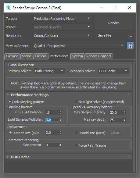

- If you can see that there is visibly more noise in the CESSENTIAL_Direct pass:
This might suggest that your scene needs more direct light samples. To have more direct light samples rendered per each render pass, go to:
3ds Max:
Render Setup > Performance > Performance Settings > Sampling balance and slightly increase the Light samples multiplier. The default value is 2, and it is not advised to increase this value above 4.
Cinema 4D:
Render Settings > Corona > Performance Settings > Sampling balance and slightly increase the Light samples multiplier. The default value is 2, and it is not advised to increase this value above 4.

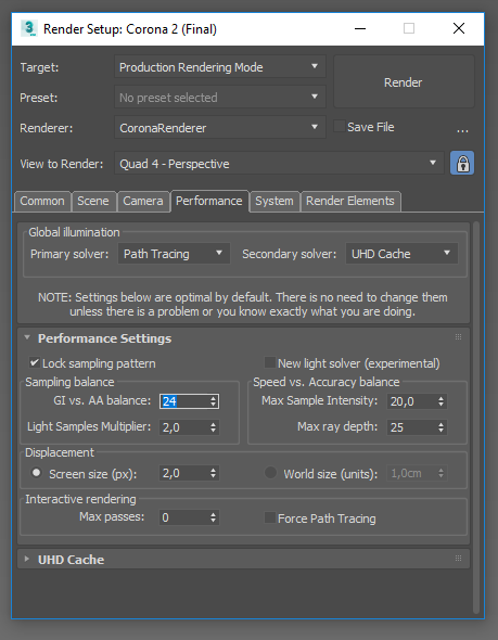

- If you can see that there is visibly more noise in the CESSENTIAL_Indirect pass:
This might suggest that your scene needs more GI samples. To add more GI samples per each render pass, go to:
3ds Max:
Render Setup > Performance > Performance Settings > Sampling balance and slightly increase the GI vs. AA balance. The default value is 16, and it is not advised to increase this value above 64.
Cinema 4D:
Render Settings > Corona > Performance Settings > Sampling balance and slightly increase the GI vs. AA balance. The default value is 16, and it is not advised to increase this value above 64.

- The total amount of samples is dependent on the Light samples multiplier and GI vs. AA balance values.
- If the Light samples multiplier is set to 1 and the GI vs. AA balance is set to 16, this means that 16 GI samples and 16 direct light samples will be used for each pixel per pass.
- If the Light samples multiplier is set to 2 and the GI vs. AA balance is set to 16, this means that 16 GI samples and 32 direct light samples will be used for each pixel per pass.
- In some situations, it makes sense to reduce one of these values and increase the second one, or even to reduce both. Typically, there is no need to increase GI vs. AA balance above 64 and Light samples multiplier above 4.
- GI vs. AA balance should never be lowered below 2.
The default value of 16 works well in most cases, but sometimes it should be increased if there is more noise in indirect light areas, or decreased if there is strong DoF (3ds Max | C4D) or motion blur (3ds Max | C4D) in the scene.
Note: GI vs. AA balance works in correlation with Light Samples Multiplier.
Read more about getting rid of excessive noise.
