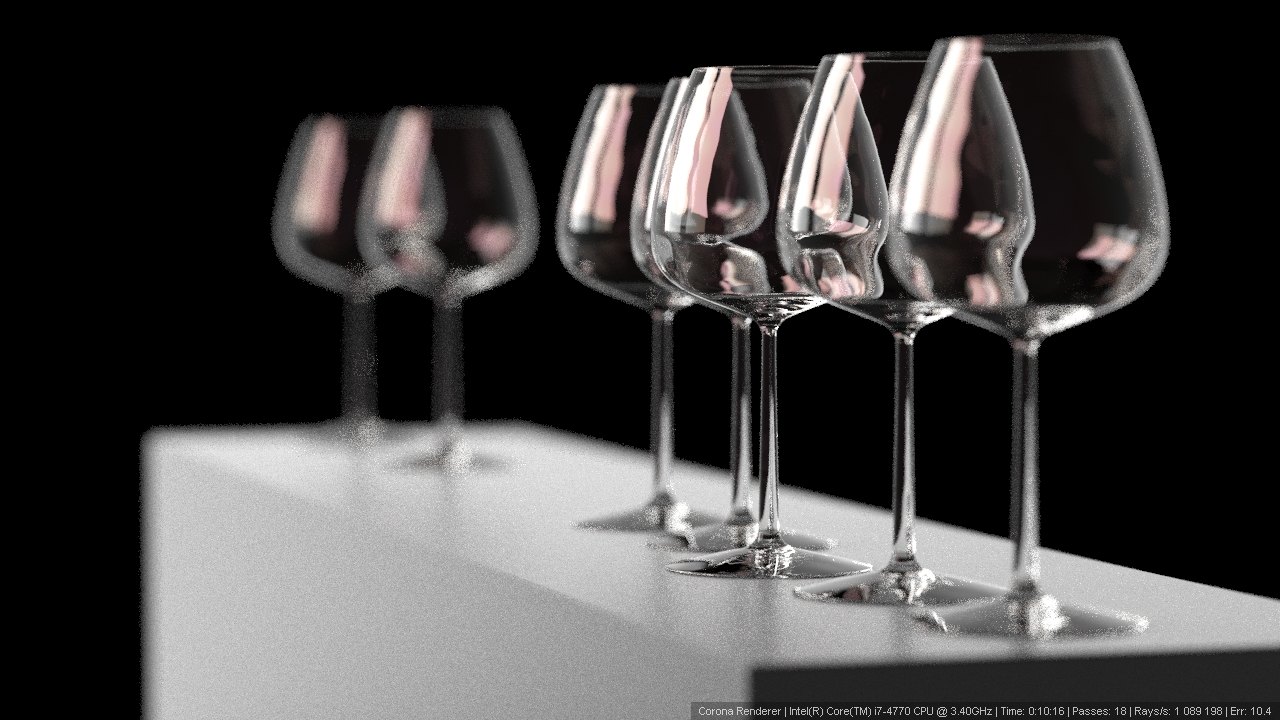

1. Adaptivity only
1.1. Strong DOF - adaptivity on - 10 minutes.
(click to enlarge)
1.2. Strong DOF - adaptivity off - 10 minutes.
(click to enlarge)
