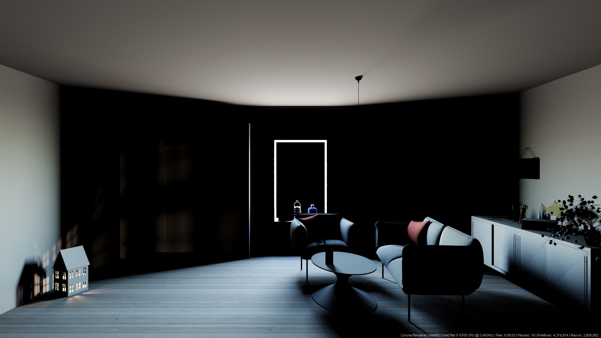

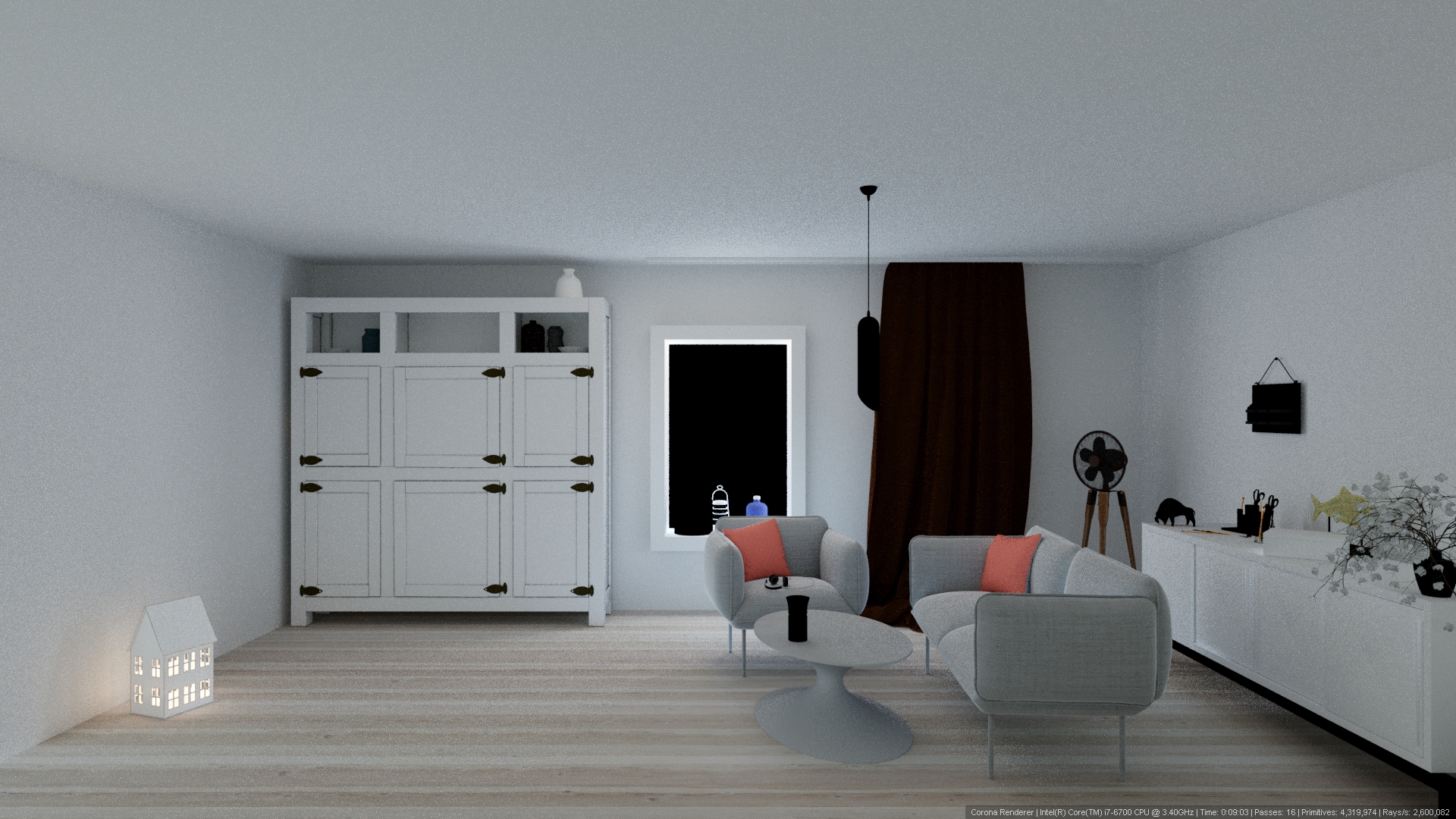

Direct lighting pass:
(click to enlarge)
Global illumination pass:
(click to enlarge)
