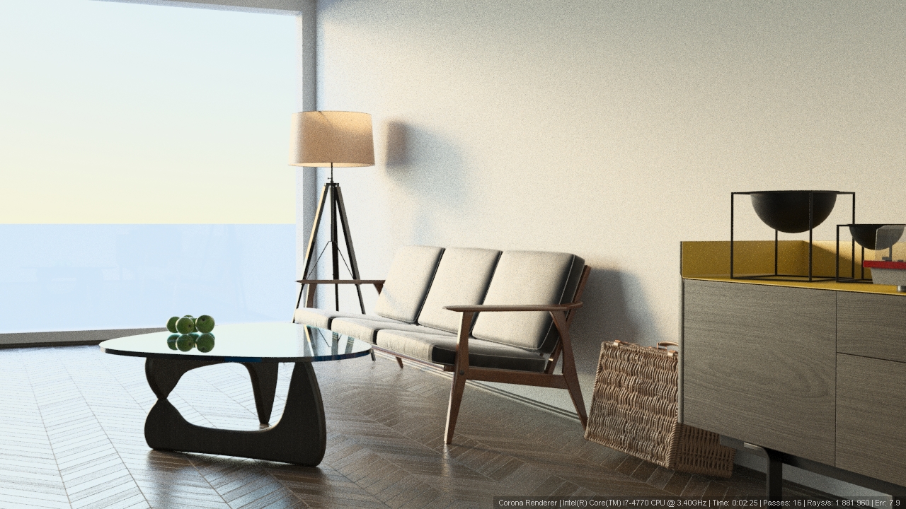

1. Clamping = 0 (default value)
No highlight clamping occurs. Bright highlights and "jagged" edges are visible (lamp leg).
