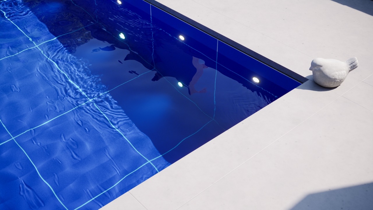

Pool with caustics. Dispersion disabled.
Pool with caustics. Dispersion enabled and Abbe number set to 20. Note that caustics are also affected by dispersion.
Pool with caustics. Dispersion enabled and Abbe number lowered to 5 to exaggerate the dispersion effect. Note that caustics are also affected by dispersion.
