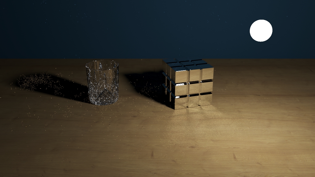

1. Caustics solver enabled in the Performance tab. "Generates caustics" enabled in the light object.
Both reflective and refractive caustics are generated as expected:

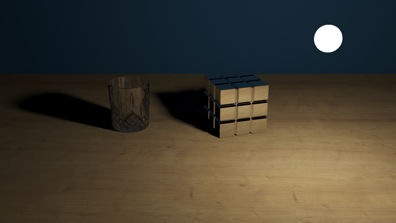

5. Caustics solver enabled in the Performance tab. Both "Visible in reflections" and "Visible in refractions" disabled in the light object.
In this case, no caustics are visible at all, and the light is also invisible in reflections and refractions.
