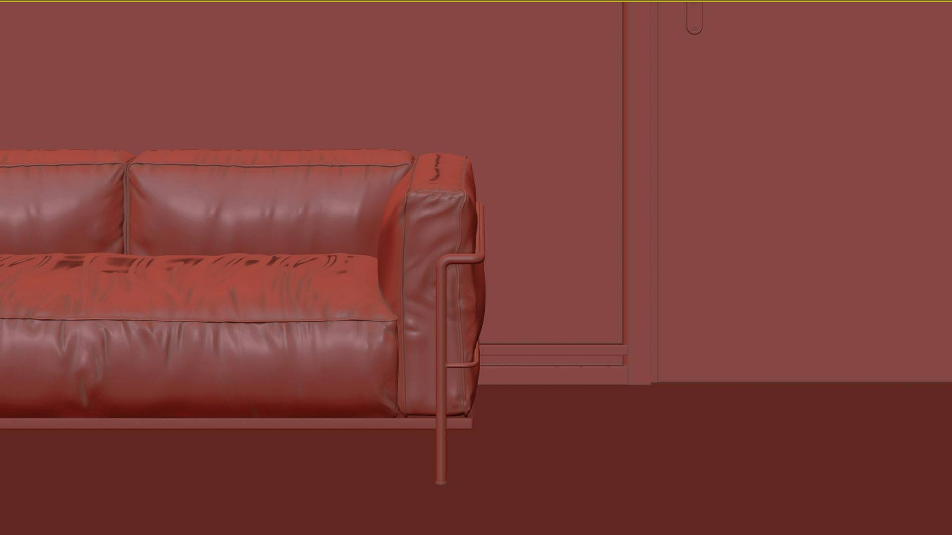

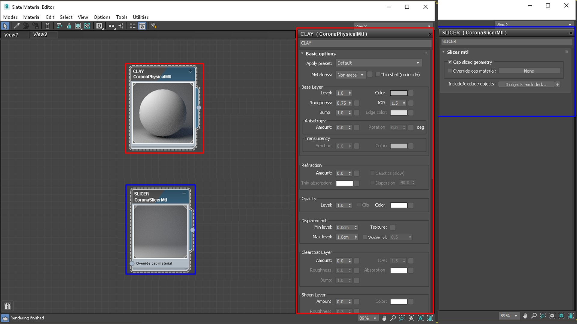

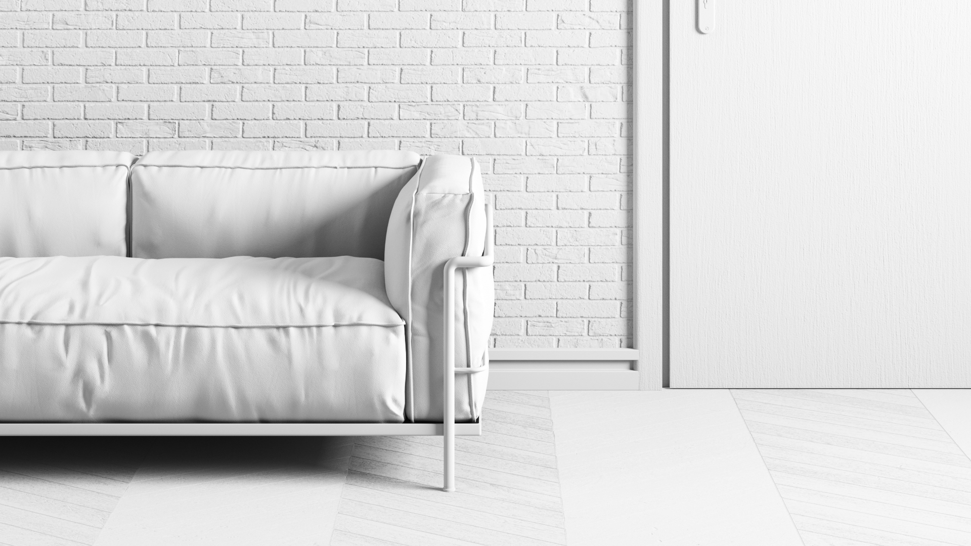

Example 1: In this scene, we are using a Corona Physical material to create clay material and use it in Material Override. Also, to make the interior visible we are using a simple box as slicer mesh with Corona Slicer material. To avoid Material Override affecting the Slicer mesh we enable the Preserve Slicer Material option.
Scene Setup:
Material Setup:
Render:
