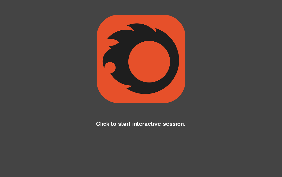

To enable it, right-click on the name of a viewport of your choice (for example [top], [left] or [perspective]) and select Extended Viewports > Corona Interactive:
This will set your current viewport as an Interactive Rendering window:
To start rendering, simply left-click anywhere inside that window. You can resize your interactive window by resizing the viewport layout.
