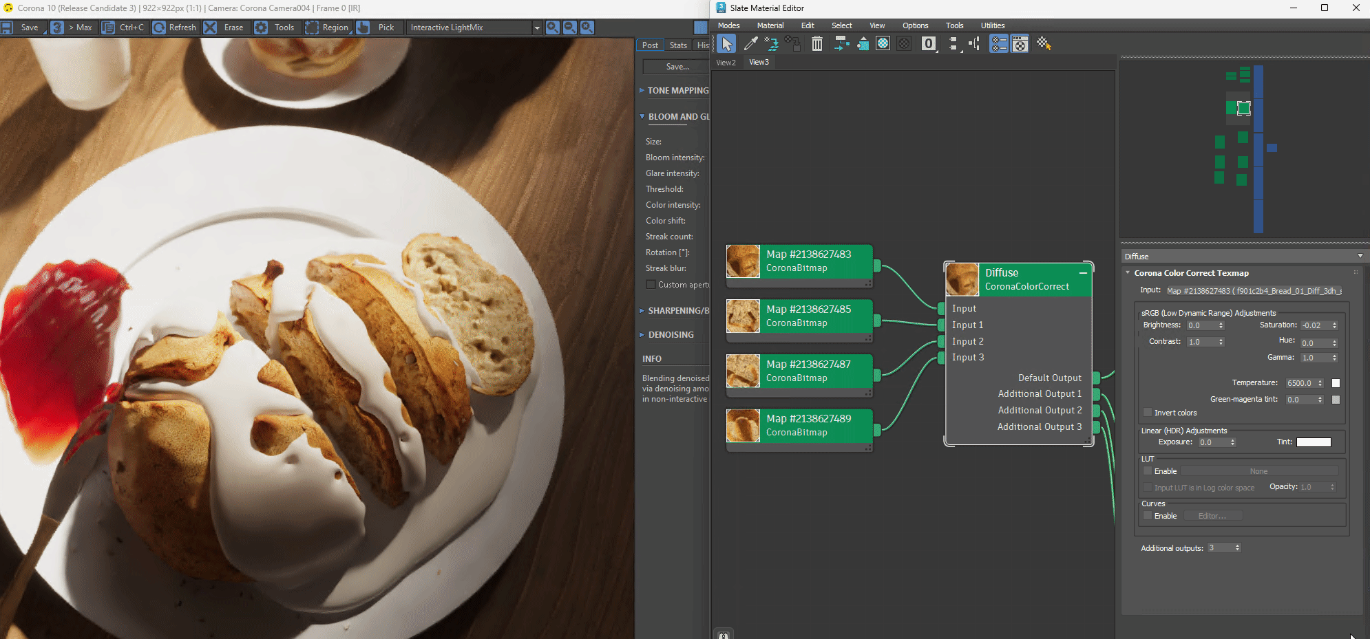

Example 1: Using Corona a Color Correct Map with Multiple Output Maps:
Material setup:
Additional outputs value set to 3 in the Corona Color Correct map.
Changing
In this example, we are using a single Corona Color Correct map to affect all the diffuse textures of the bread object thanks to the multiple output maps feature.

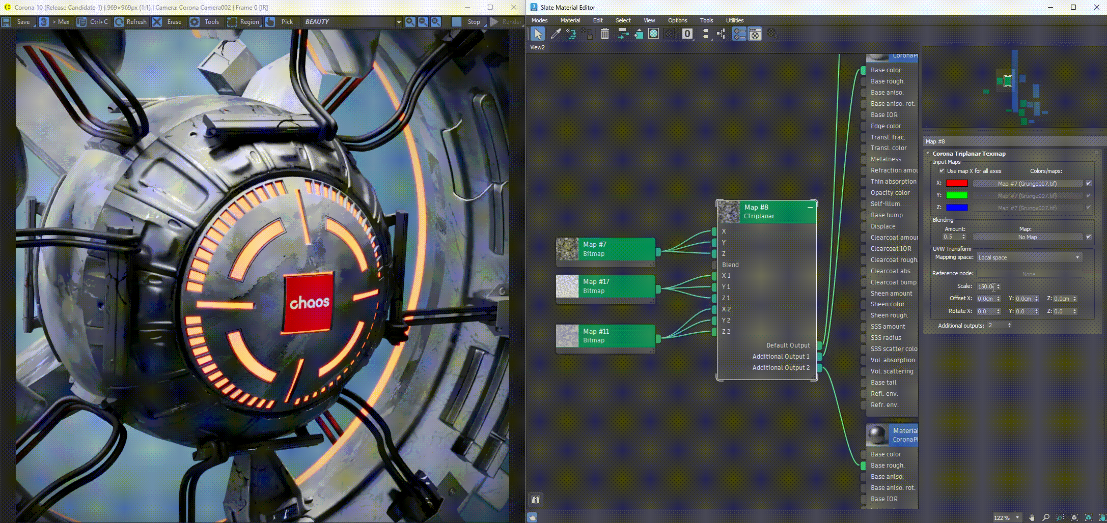

Example 2: Using a Corona Triplanar Map with Multiple Output Maps.
Corona
Material setup:
Corona
Additional outputs value set to 2 in the Corona Triplanar map.
Corona
In this example, we are using a single Corona Triplanar map node to affect all the textures thanks to the multiple output maps feature.
