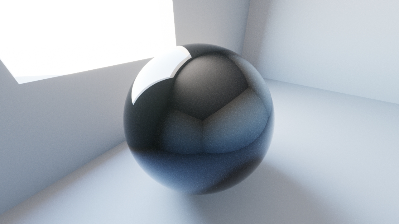

A simple black material with Fresnel IOR set to 1.52 in its properties (this is the default value):
Material setup:

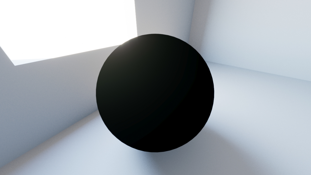

If we connect the Corona Color map to the Fresnel IOR map slot of our material, it will generate some unexpected results. This is because the Fresnel IOR does not accept standard color input:
Fresnel IOR using a Color Color map with pure white color set:
Material setup:
Setting Fresnel IOR to a darker, gray color does not seem to clarify the situation either:
Material setup:

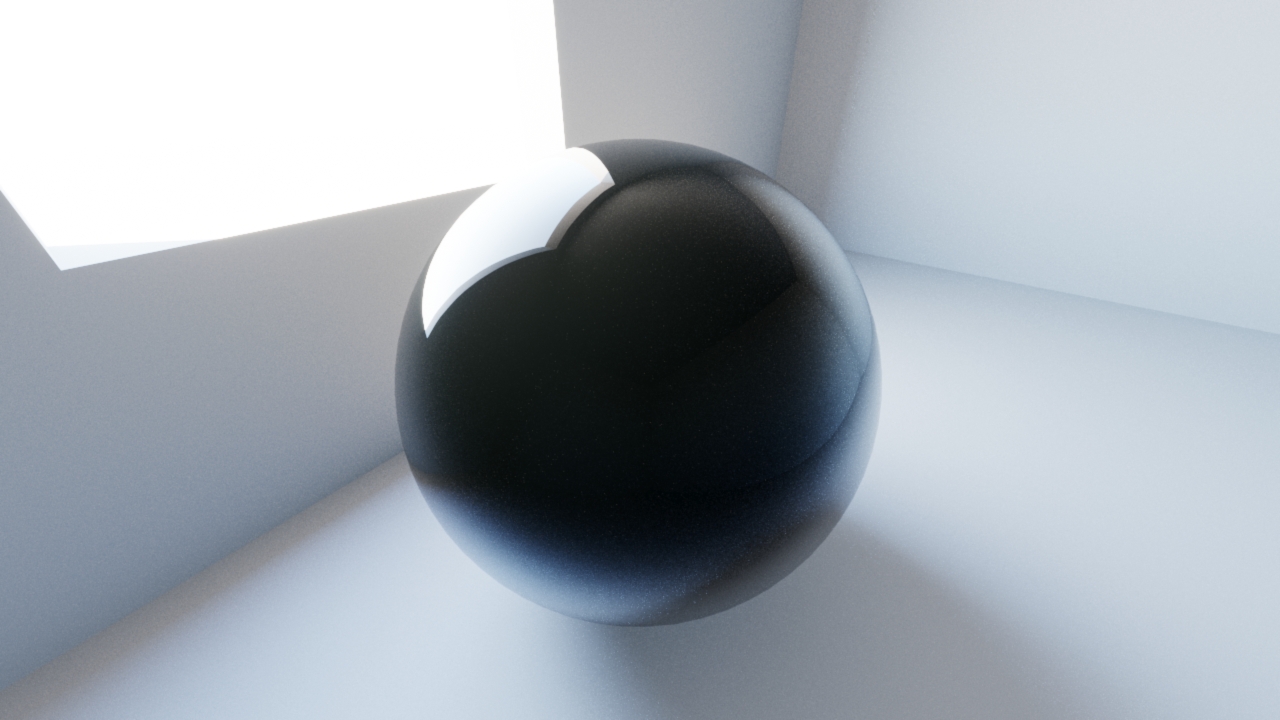

To overcome this, and correctly set a custom Fresnel IOR value we can set the Corona Color map to pure white, and then use its Output multiplier parameter:
Custom Fresnel IOR value set to 1.52. Note that the result is identical to a Corona Material using Fresnel IOR set to 1.52 visible in the first image example:
Material setup:

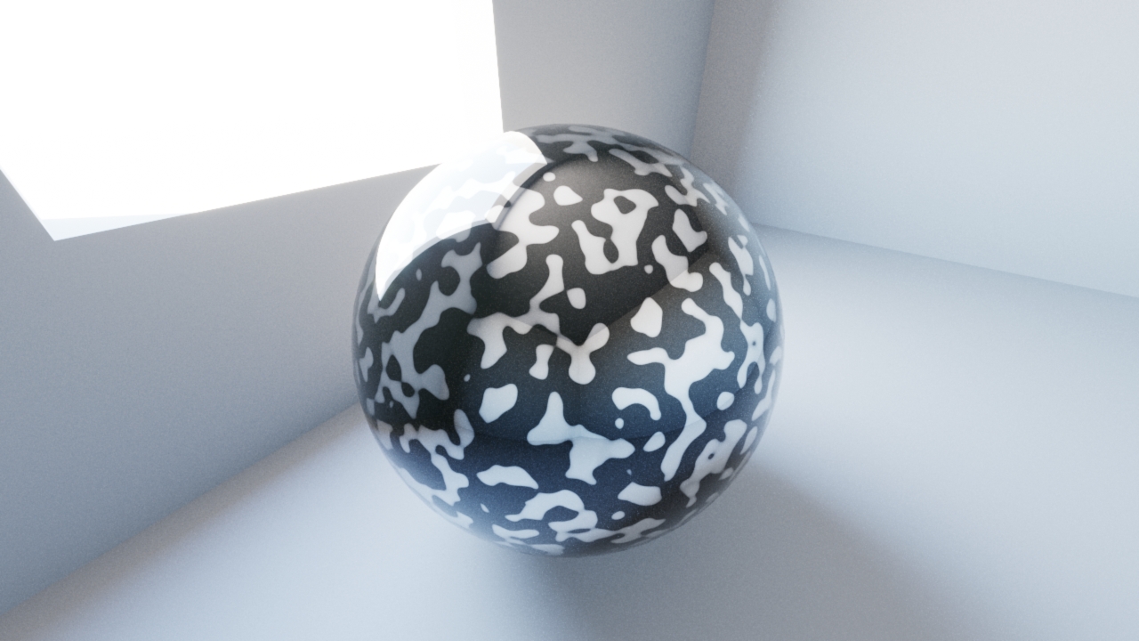

This method can be used to create a single material where the Fresnel IOR value varies across its surface:
A Noise map is used to define where the Fresnel IOR value is lower (darker material) and where it is higher (brighter, metallic material):
Material setup:
(Corona Color 1 - Output multiplier 1.52; Corona Color 2 - Output multiplier: 32)
