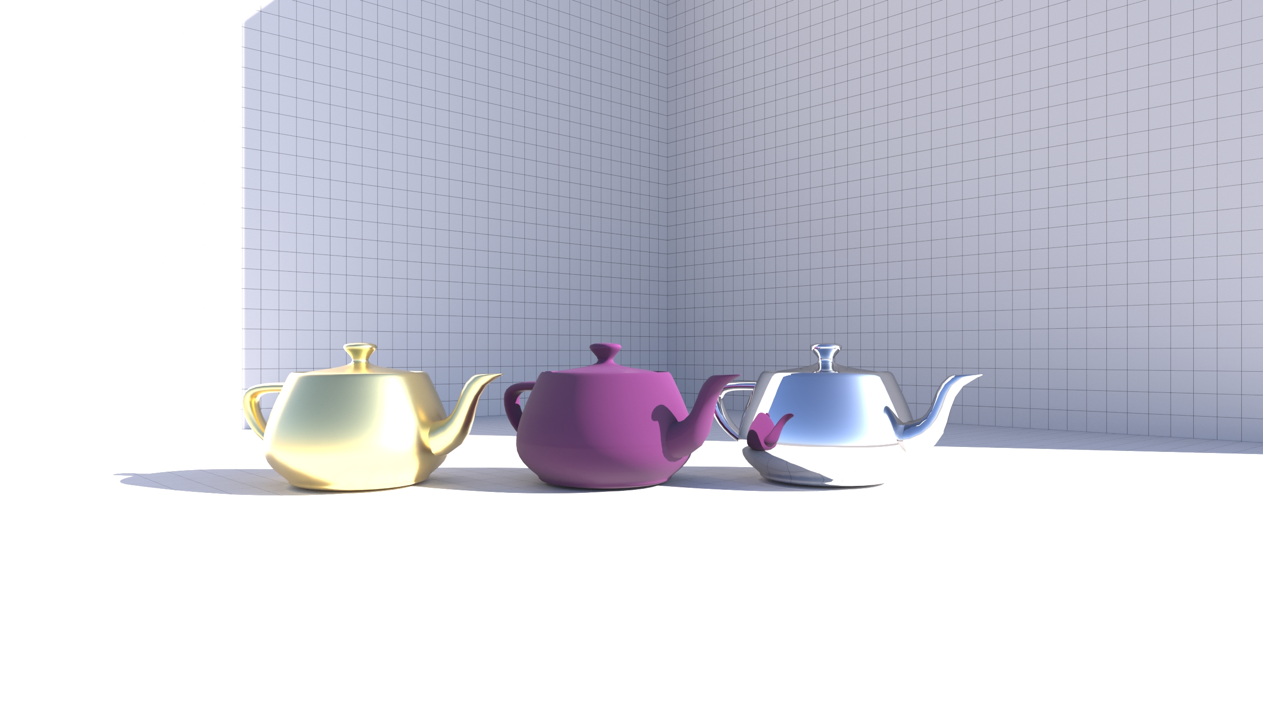

Examples
Highlight compression = 1 (default value)
There are very bright areas caused by direct light and refractions.
Highlight compression = 2
More detail is recovered from brightest areas.
Highlight compression = 3
Brightest areas are becoming "flat".
Highlight compression = 100
The image lacks contrast as bright areas are becoming less pronounced.
Highlight compression = 0,5
There is a lot of burning in brightest areas of the image.
