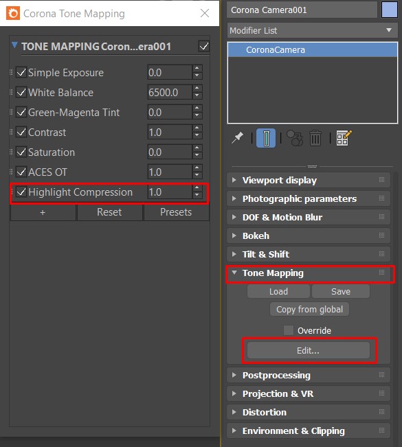

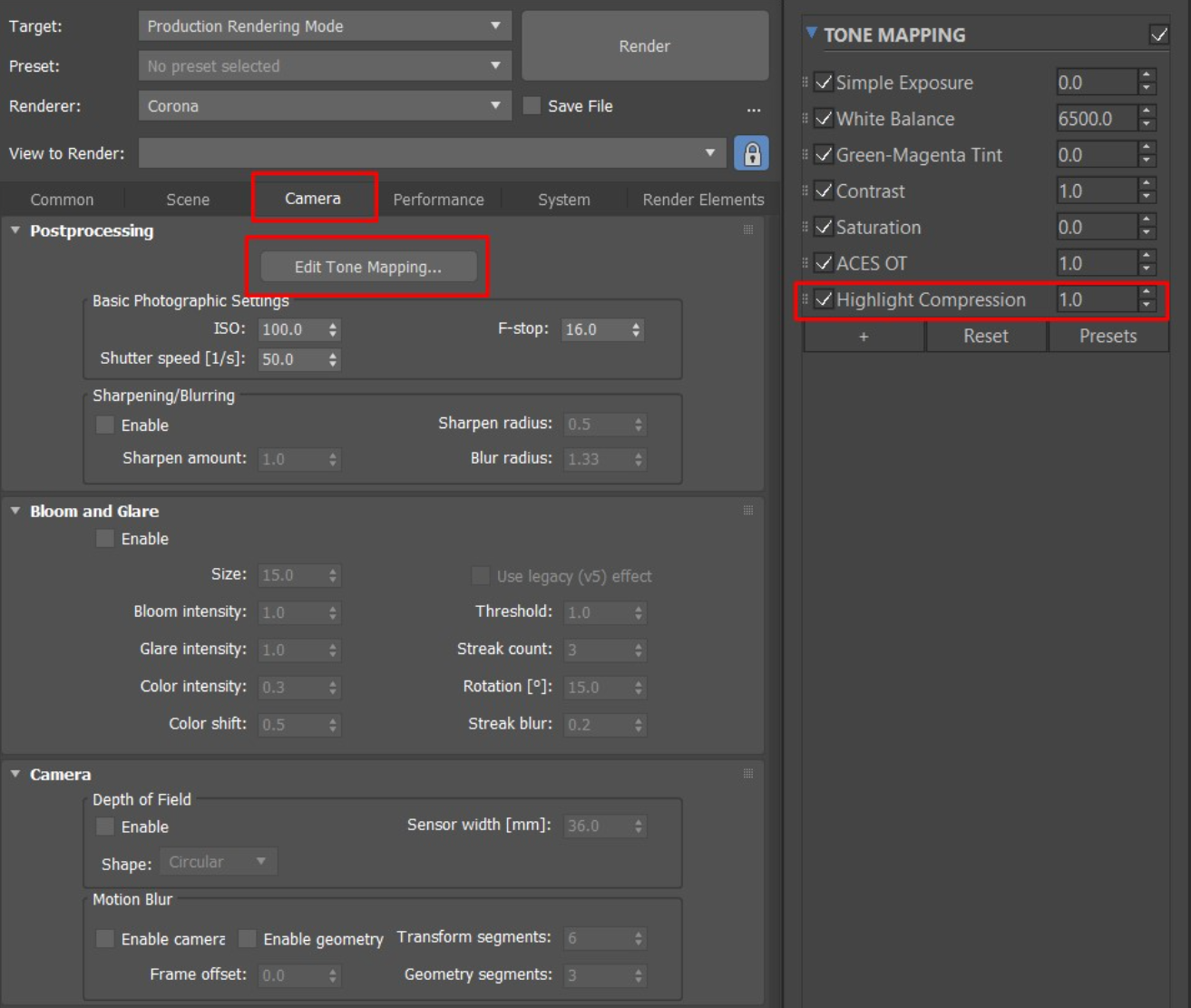

You can find Highlight compression parameters in:
  • 3ds Max:
    • Render Setup > Camera > Edit Tone Mapping > Highlight Compression
    • The Tone Mapping rollout in a Corona Camera

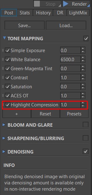

  • Both 3ds Max and Cinema 4D:
    • Post tab in the Corona VFB:
