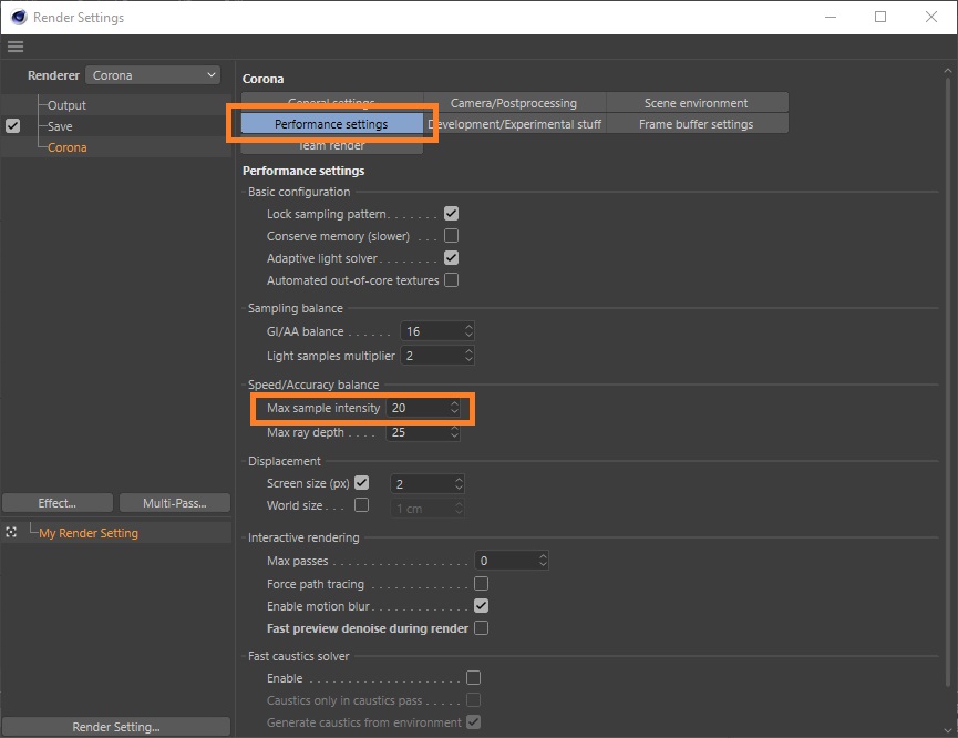

Max Semple Intensity in C4D
"Max Sample Intensity" is a parameter you can find in Render Setup > Performance > Performance Settings > Speed vs. Accuracy balance. As its name suggests, this parameter controls the maximum allowed intensity of GI samples. Lowering it will result in clamping of light bounced off objects, including reflective and refractive caustics, significantly reducing noise at the cost of realism. Increasing this value will reduce amount of clamping but also increase the noise level. Default value of 20 should work well in most situations.
Setting this value to 0 enables a special unbiased mode where no clamping occurs. This mode will, however, often introduce fireflies that may never converge.

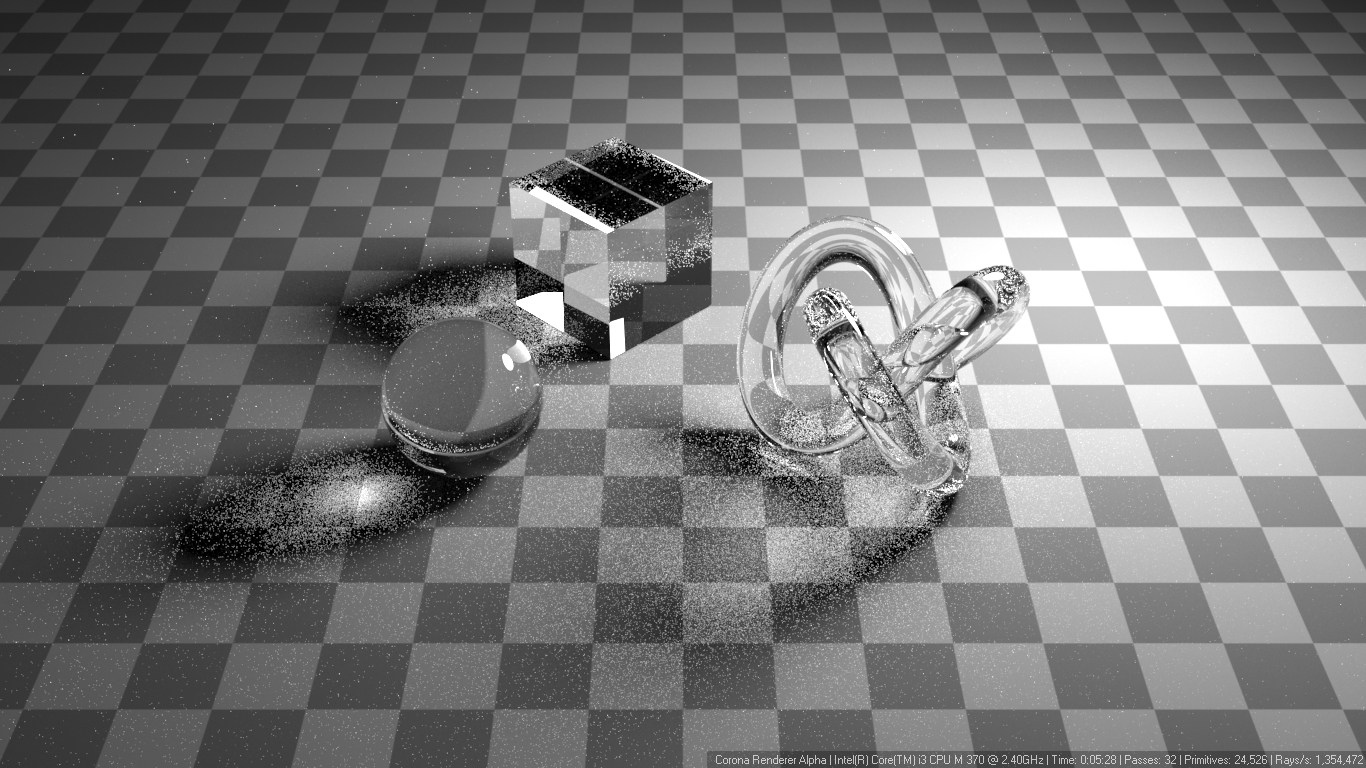

MSI and path-traced caustics
MSI also affects reflective and refractive caustics, which are generated with the regular path tracing solver:
Note: MSI does not affect caustics generated with the new fast caustics solver.
MSI = 20 (default value)
A balance between caustic visibility and noise level.
MSI = 0 (unbiased mode)
Intensive caustics but more noise.
MSI = 2
Samples are heavily clamped so caustics are barely visible.
