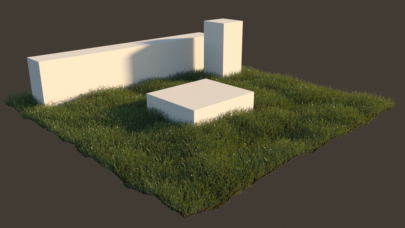

Example of bright pixels visible in grass:
glossiness = 1.0

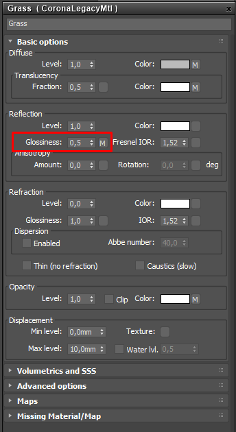

1. Lower glossiness value of the grass material:

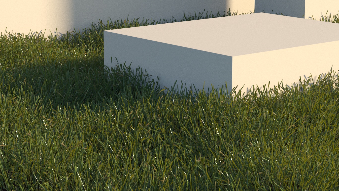

Glossiness lowered from 1.0 to 0.5 in 3ds Max and Cinema 4D:
After lowering material's glossiness to 0.5, sun reflections became "softer" and more realistic:

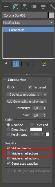

2. Disable reflection visibility for Corona Sun in 3ds Max and Cinema 4D:
Result of disabling sun's reflection visibility:
There are no bright pixels but the grass looks less realistic. Using this option will globally disable sun reflections for all objects.
