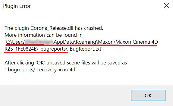

When C4D crashes, it usually displays "C4D Bug Report" window. To find the location of your minidump file:
1. Do not close the error report window just yet
2. Take note of the location mentioned as this is also where the minidump can be found

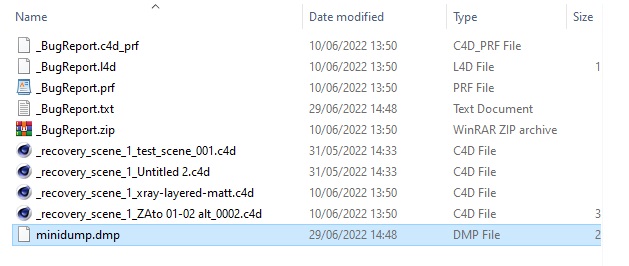

3. Go to that location and find the .dmp file.
4. Before sending, compress your minidump files into a single archive (formats such as .zip, .rar, or .7z are all acceptable). Archiving can reduce the file size by up to 10 times, which makes uploading and downloading much faster and easier.
5. Attach the archived minidump files together with your problem description using the support ticket submission form. If you cannot attach the files for any reason, simply submit your message without them. Our support team will then guide you on how to send the files later.

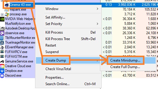

1. Simply download and use this tiny application to obtain the minidump file:
Process Explorer
2. When the error message appears, or during the freeze, run Process Explorer, find "Cinema4d.exe" process, right-click it, and go to Create Dump > Create Minidump..., then save the file in a desired location.
3. Archive the file using software of your choice (.zip, .rar, .7z will work fine) - this way the dump file may get even 10 time smaller!
4. Attach the archived minidump files together with your problem description using the support ticket submission form. If you cannot attach the files for any reason, simply submit your message without them. Our support team will then guide you on how to send the files later.

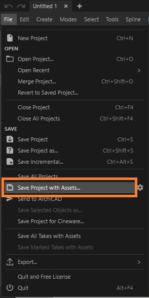

The best way to save the whole scene with all models, textures and other assets is using the "Save Project with Assets" option in C4D. If your scene is still big after archiving it, it is best to simplify it as much as possible while still preserving the problem. You can then attach your files in our ticket submission form.
Save Project with Assets option in C4D:
When submitting your support ticket, attach your problematic scene.
We provide an option to attach large files in our support ticket submission form. If you do not have any files that you could attach, or if you think something isn't working right, please skip this step and send us your message without any files. Our support team will ask you for files later and will explain how to attach them.

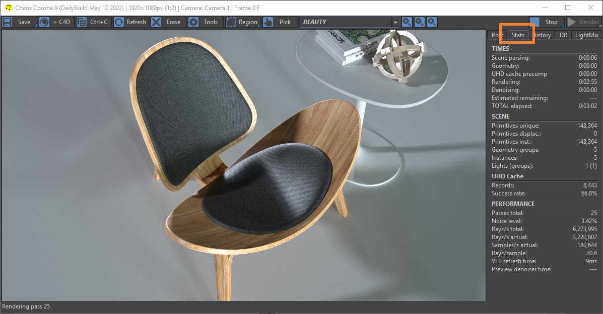

4. Exceptionally Slow Rendering
If your rendering is unusually slow
  • Please include a screenshot of the Stats panel from the Corona VFB when submitting your bug report.
  • The information shown there can be crucial for identifying the cause of slow rendering.
