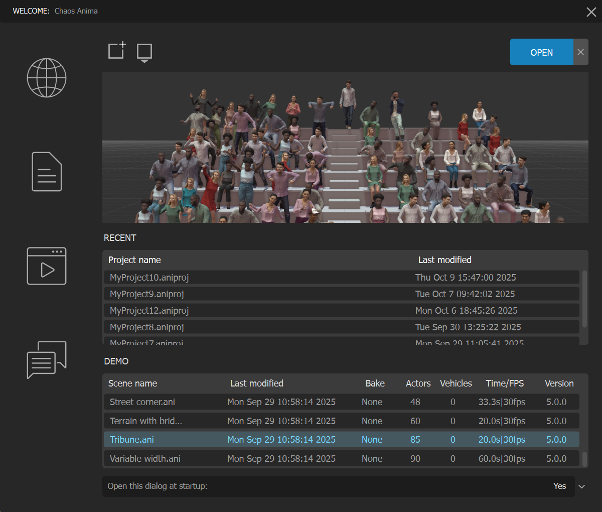

For theaters, Anima includes a demo scene called "Tribune" which can be loaded from the Welcome dialog:
This scene uses Socialization Areas with a particular setup (cheer animations, grid mode, and adjusted spacing between seats). It showcases how the Area tool works and how quickly you can build a large number of people distributed in a regular grid of seats.
