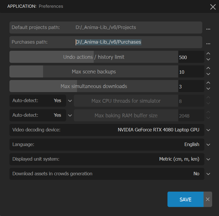

You can set up Anima to use a centralized library folder on a network path by following these steps:
  1. Go to Menu > Edit > Preferences
  2. Change the Purchases path to a shared folder location of your choice and click SAVE.

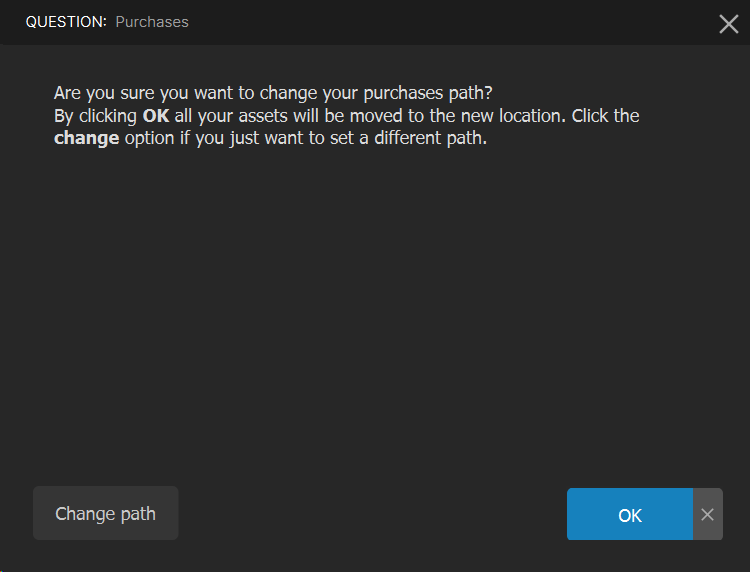

When clicking SAVE, the following dialog appears:
By default, the OK option is selected. When using that OK option, all the content present in the original Purchases folder is automatically moved to the new location.
If you want to change your Purchases folder to a location that already has content inside, use the Change path button from the left instead. That will leave the content from the original folder untouched, and load into Anima the resources already available in the new folder path.
