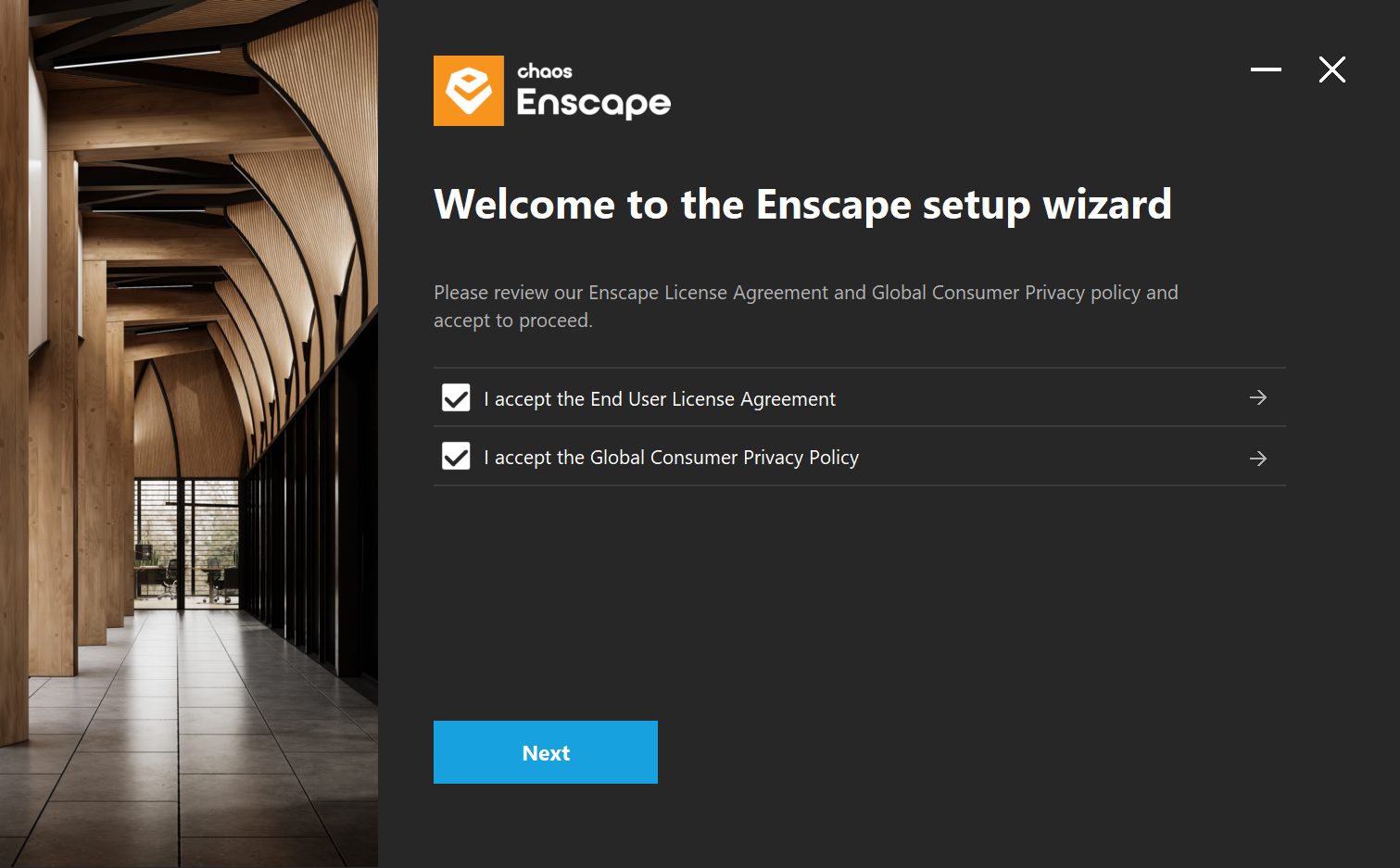

  2. Accept the license agreements and click Next.

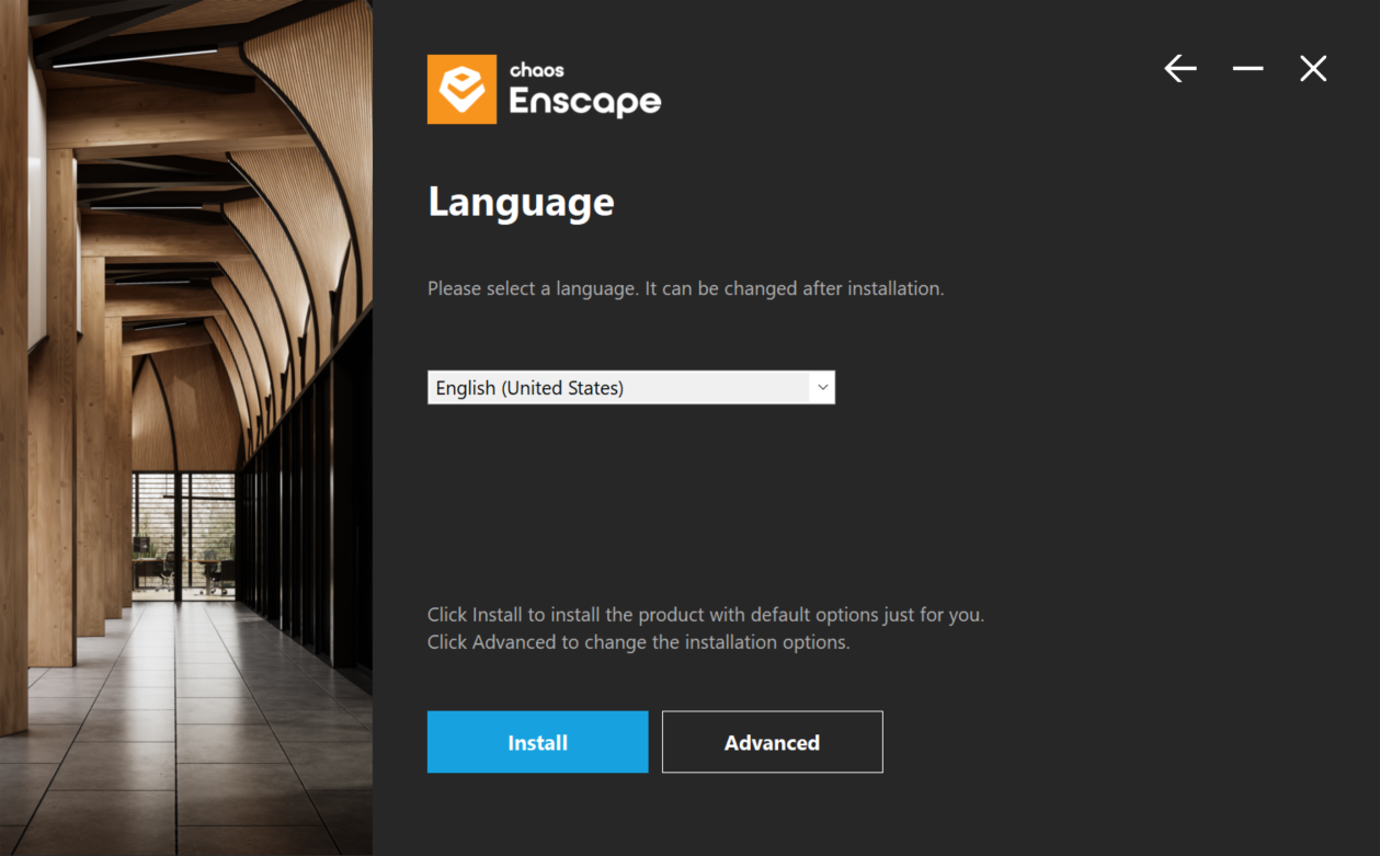

  3. Select your preferred language and click Install. The installation will proceed. Selecting language during Enscape installation

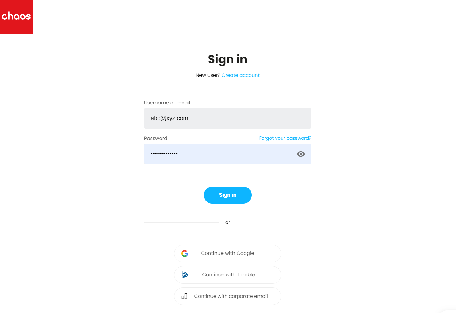

Sign in to your Chaos account

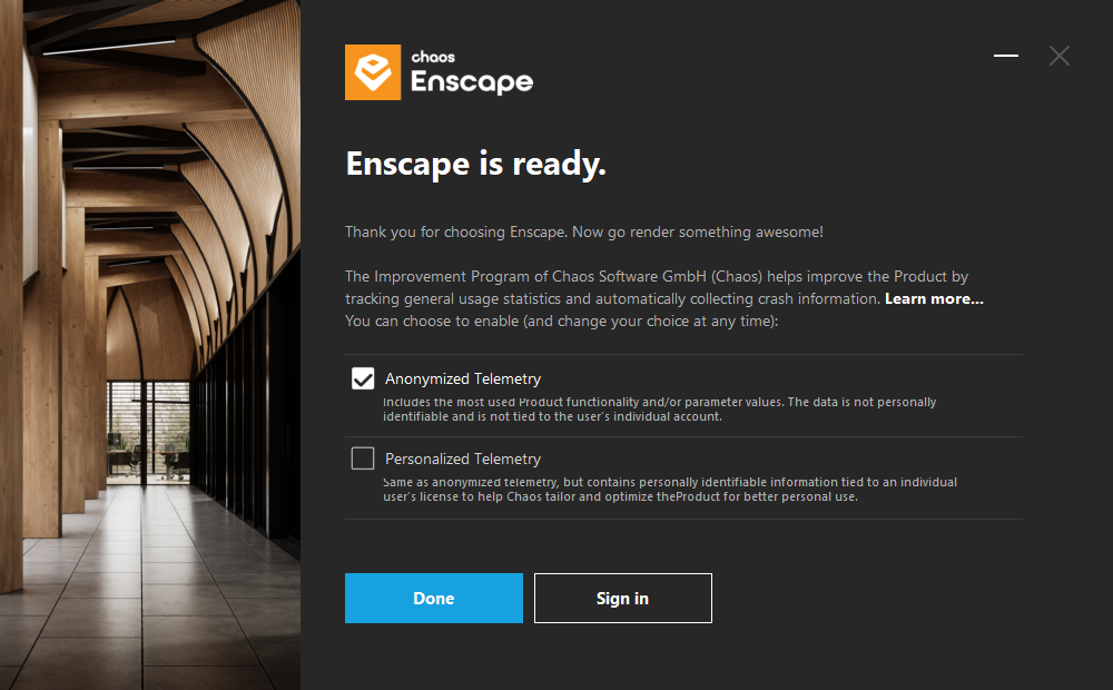

  1. When prompted, sign in to your Chaos account that holds the Enscape licenses. Chaos account sign-in prompt
  2. Use the credentials for the account with the Enscape license. If you have an existing Enscape login, you may use it here. Entering Chaos account credentials
  3. After signing in, you can close the webpage.

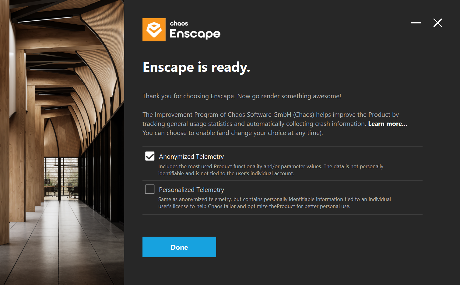

  1. Return to the Enscape installer and select your telemetry options, then click Done to complete the installation. Finalizing Enscape installation
  2. Your license is now active and can be shared with others on your local network. Remember, only one person can use a license at a time. For multiple simultaneous users, additional licenses are required.

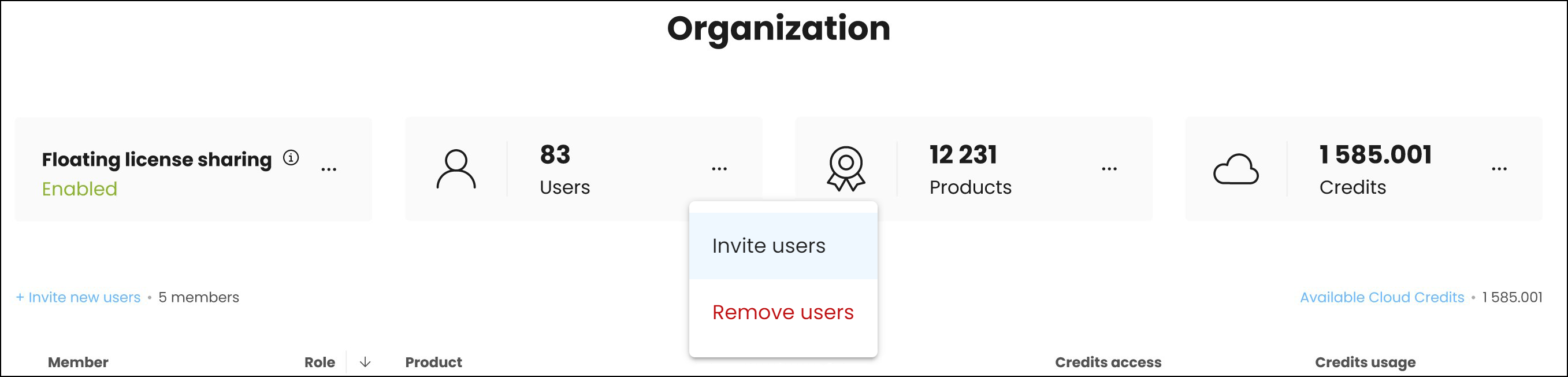

Administrator adds users

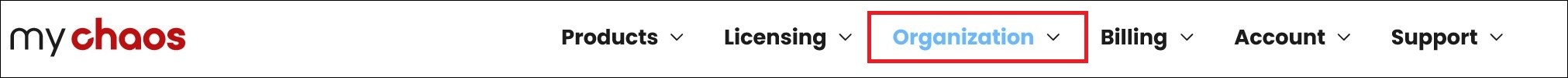

  1. The admin logs into my.chaos.com and navigates to the Organization tab. MyChaos Organization tab
  2. Go to the three-dot menu next to Users and select Invite Users. Inviting users to MyChaos Organization
  3. Invite users to your Organization. For detailed instructions, refer to the My Chaos Guide page. To enable Floating license sharing, click Enable in the three-dot menu.

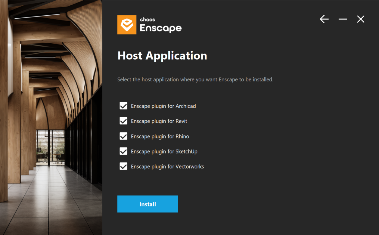

  2. Choose the CAD software you wish to install Enscape for and click Install. Allow the installation to complete. Selecting CAD software during Enscape installation
  3. At the end of the installation, select your telemetry settings and click Done. You do not need to sign in as you are already connected to an active license.
