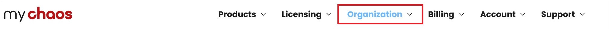

1. Log into my.chaos.com and go to the Organization tab on the toolbar.

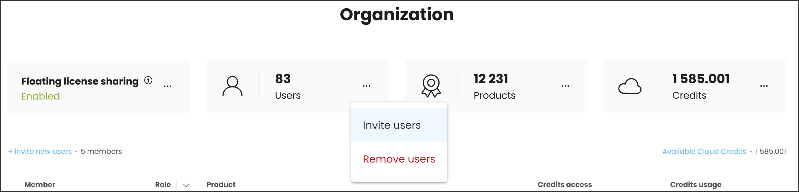

2. Go to the three-dot menu next to Users and select Invite Users.
3. Invite users to your Organization. For instructions on this step, see the My Chaos Guide page.

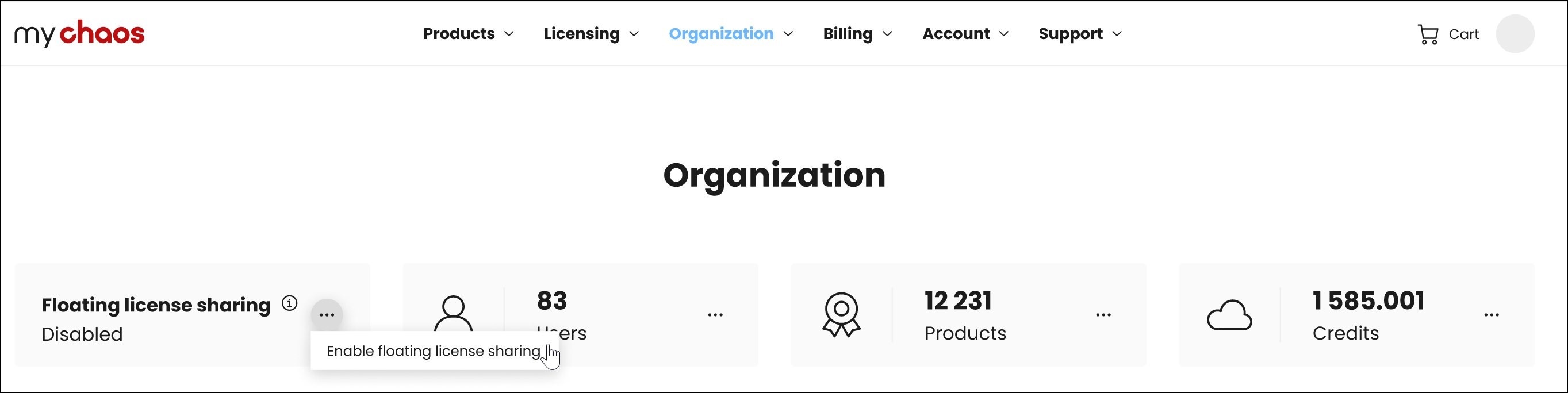

4. To enable Floating license sharing, open the three-dot menu next to the option and click Enable Floating license sharing.
At this point, any user within the Organization can use a shared floating license.
