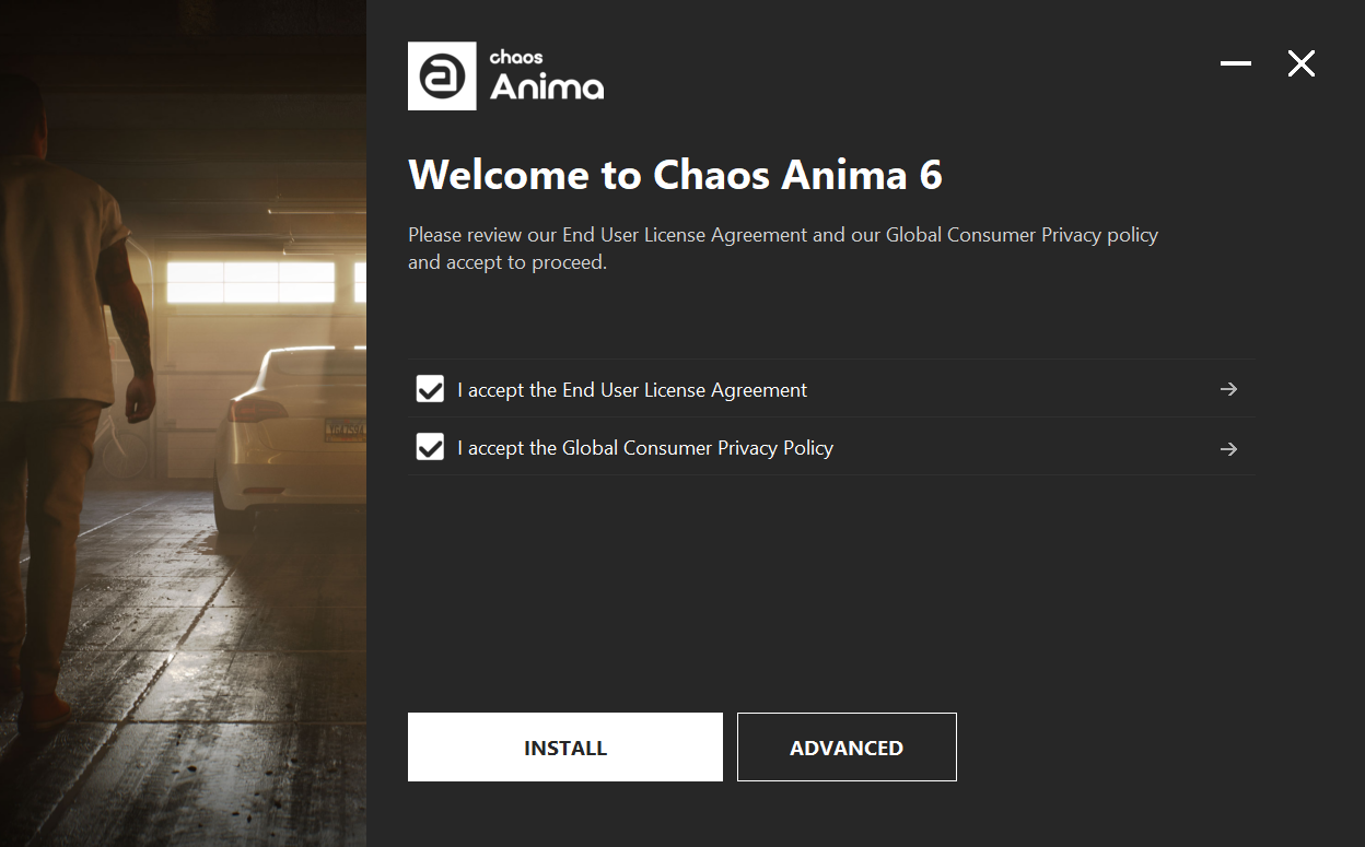

You can download Anima from here. After starting the installer, you will see the Anima installation wizard, which will guide you through the various steps of the installation process.
Once you accept the EULA and the Consumer policy, clicking on the ‘Install‘ button will proceed to install Anima and all its plugins. Using this option, the installer will try to detect the DCC applications already installed that are compatible with the plugins and automatically install them.

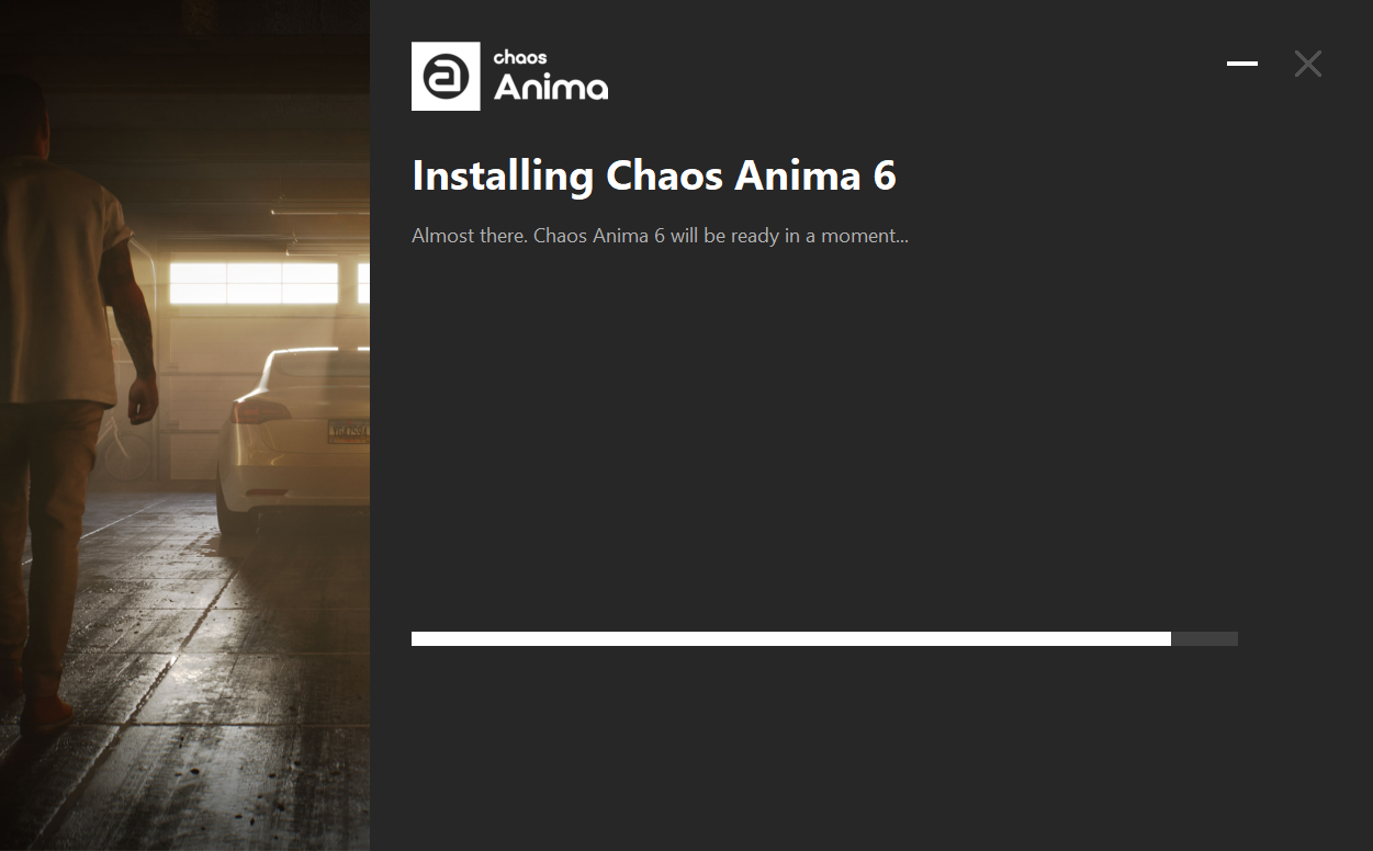

Your Anima 6 and auto-detected plugins will then be installed.
When the installation process is completed, you can select whether you want to start the Anima application automatically, and close the dialog by pressing the button DONE.

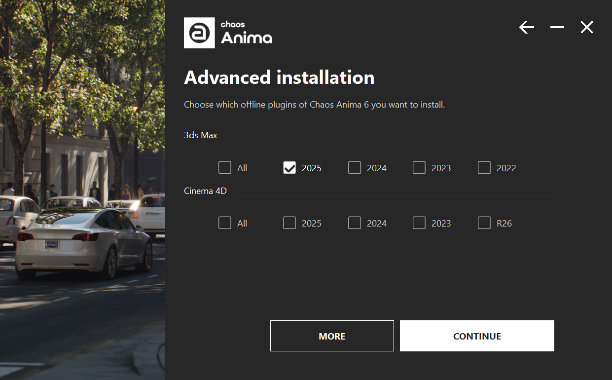

After that, you can select which versions of 3ds Max and Cinema 4D you would like to install Anima on:
By default, the installer will automatically select all the plugins compatible with the applications that are already installed in that device.

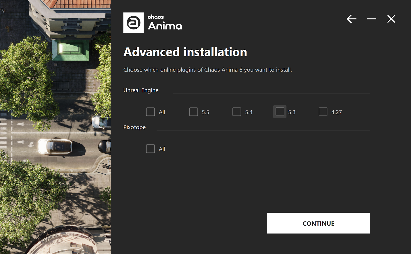

To select the Unreal Engine and Pixotope plugins, click on the MORE button:
Important note: The Maya plugin is removed in Anima 6. Customers with subscriptions using Anima 5 in Maya cannot update to Anima 6.

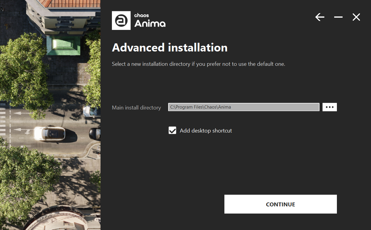

During this next step, you can choose the root installation directory for the Anima application:

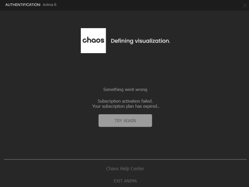

Issues with the license
The following error message might appear if no licenses are available for the email logged in to Anima:
When that dialog is closed, the licensing dialog will also show that no license is available and offer the following options:
- Manage my Chaos account: Opens an internet browser and loads the Chaos License server page.
- Sign out: Signs out the current account so you can use another one.
- Try to obtain the license again: Checks again if a license is available right now, which might be useful if other users from your company have released their own Anima license recently.
- Exit: Closes the application.
