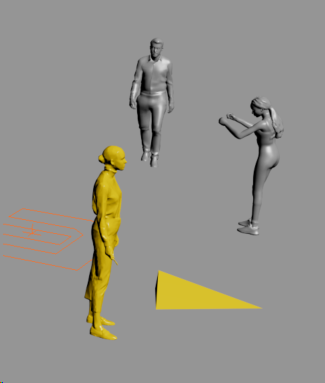

Sometimes, especially if you have used the Anima Drop panel, instead of "Missing Actors" you may see little triangles or arrows instead of the models you added.

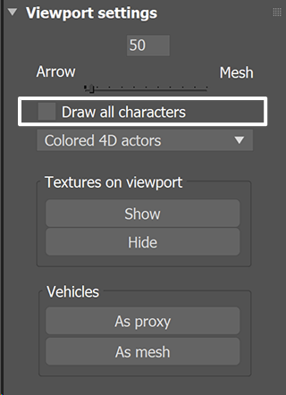

If this is the case, first make sure you the arrows are not used as an optimization for the viewport. This can be easily confirmed by selecting the Draw all characters from the Viewport settings:
If the actors still do not appear when that option is selected, then it means something went wrong with the resource cache and it needs to be regenerated.
