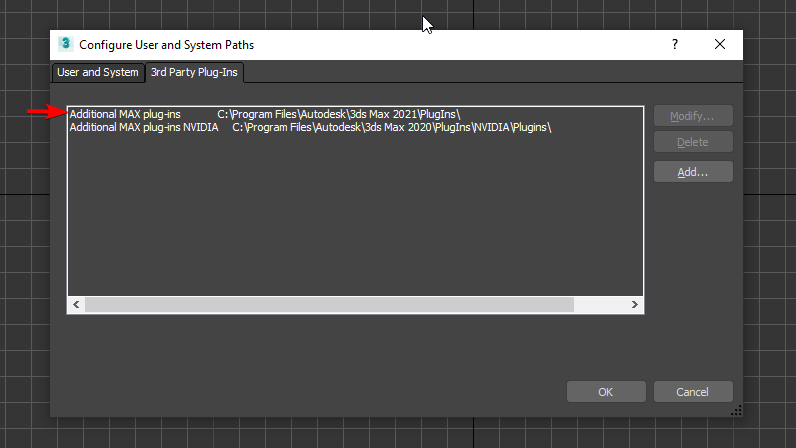

Solution 4:
In 3ds Max, go to Customize > Configure User and System Paths...
Then go to the "3rd Party Plug-Ins" tab and make sure that the "Additional Max plug-ins" path is set to your 3ds Max installation folder\PlugIns (e.g. C:\Program Files\Autodesk\3ds Max 2021\PlugIns).
If the path is different, modify it and point to the correct path.
If the path is not on the list, then add it:
