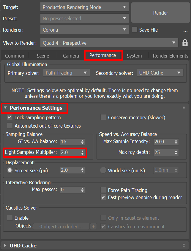

3ds Max:
Render setup > Performance > Performance Settings:

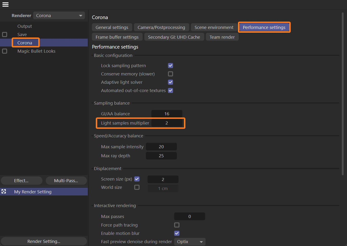

Cinema 4D:
Render Settings > Corona > Performance Settings > Sampling Balance section:

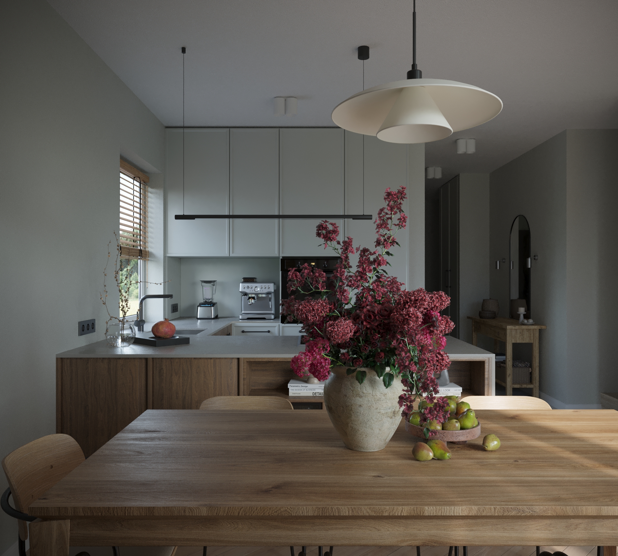

Default settings
GI vs. AA balance = 16
LSM = 2
30 passes
Render time: 05:46
16 samples are used for GI and 16 x 2 = 32 samples are used for direct light. These are the default settings of Corona Renderer, which offer a good balance between GI and direct light quality. They will work fine in most interior and exterior scenes.

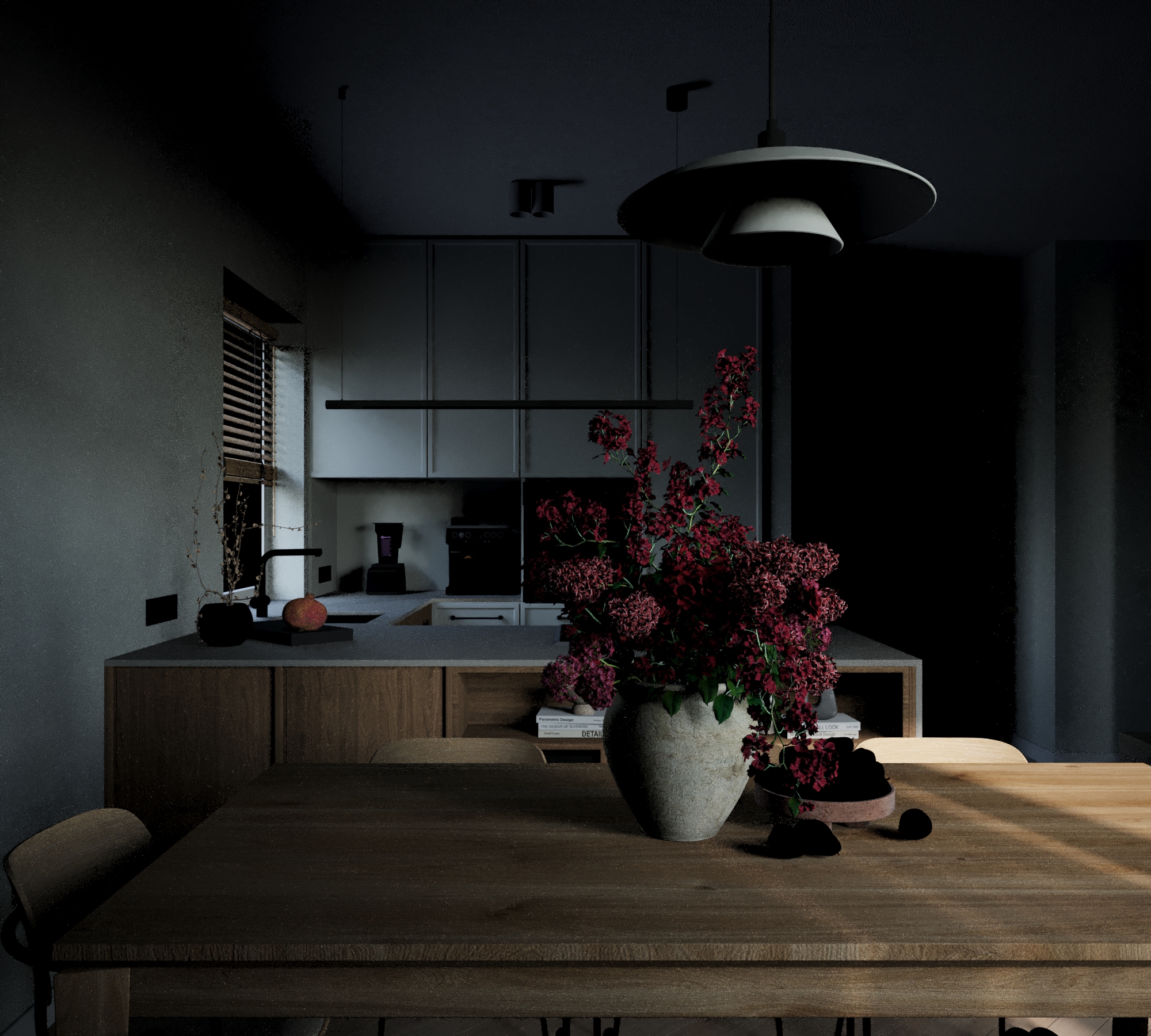

Direct lighting pass:
(click to enlarge)
Global illumination pass:
(click to enlarge)

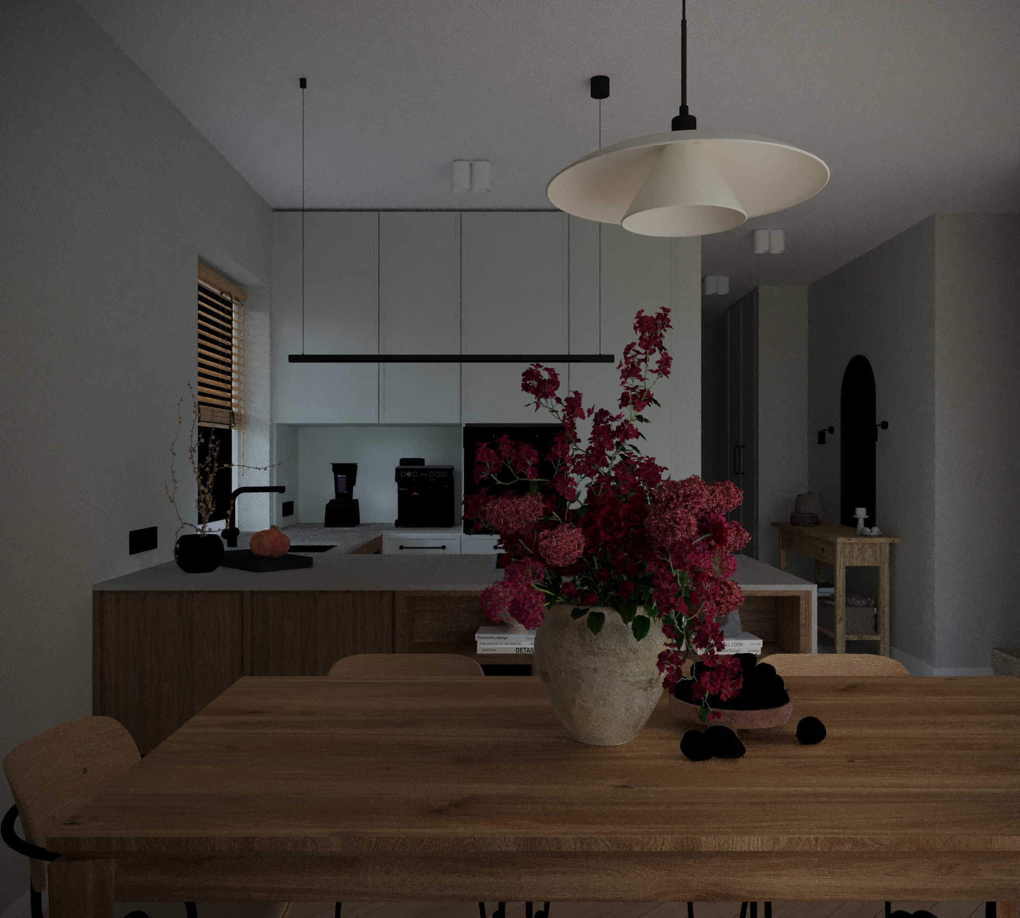

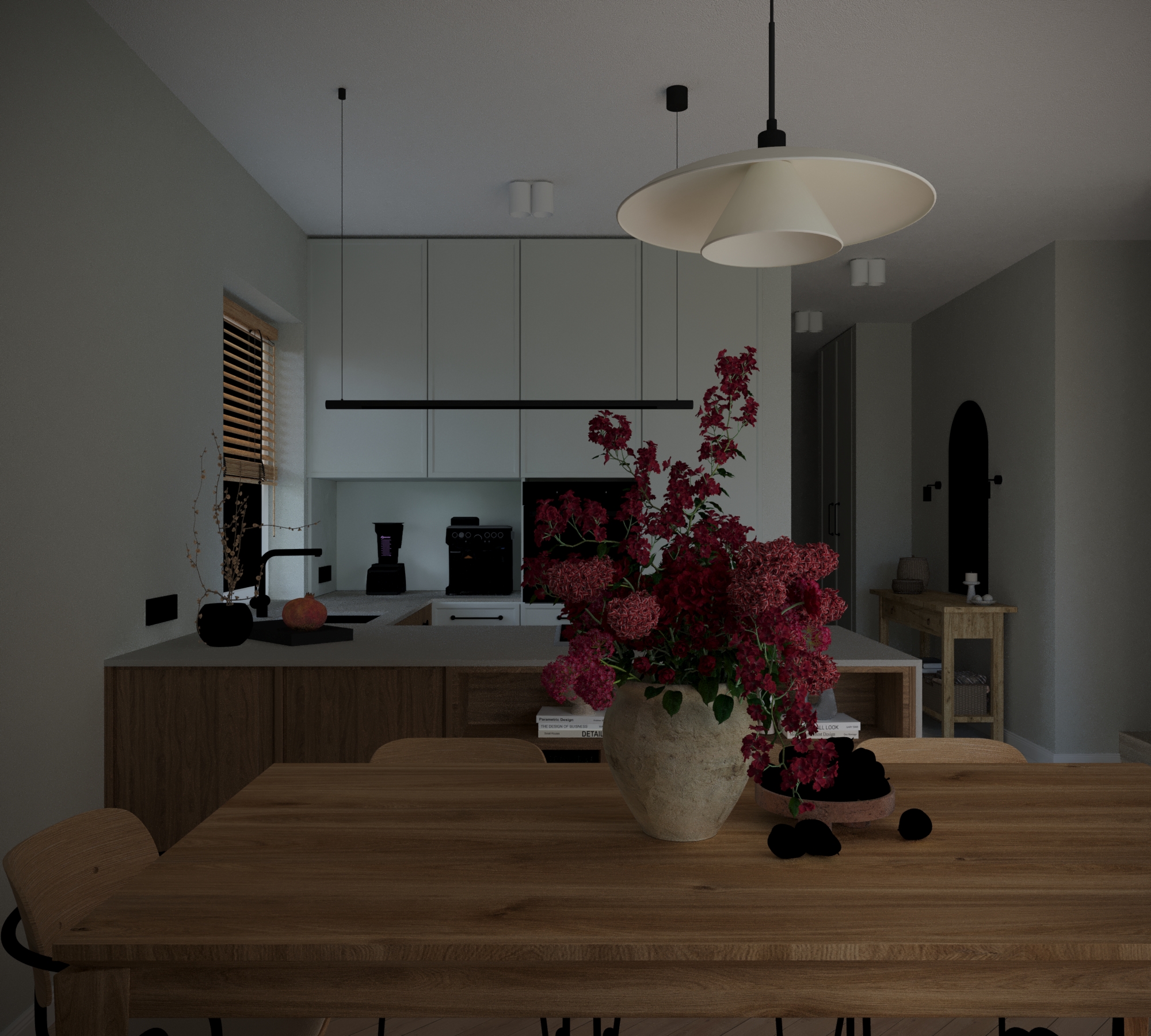

Lowered LSM
LSM = 1
30 passes
Render time: 05:05
The same number of samples (16) is used for both GI and direct light. Note that the quality of GI the GI pass remains the same as when using the default settings, but the quality of the direct lighting pass is lower. Render time is also slightly lower.
