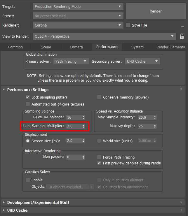

This might suggest that your scene needs more direct light samples. To have more direct light samples rendered per each render pass, go to:
- 3ds Max:
Render Setup > Performance > Performance Settings > Sampling balance and slightly increase the Light samples multiplier. The default value is 2, and it is not advised to increase this value above 4. - Cinema 4D:
Render Settings > Corona > Performance Settings > Sampling balance and slightly increase the Light samples multiplier. The default value is 2, and it is not advised to increase this value above 4.

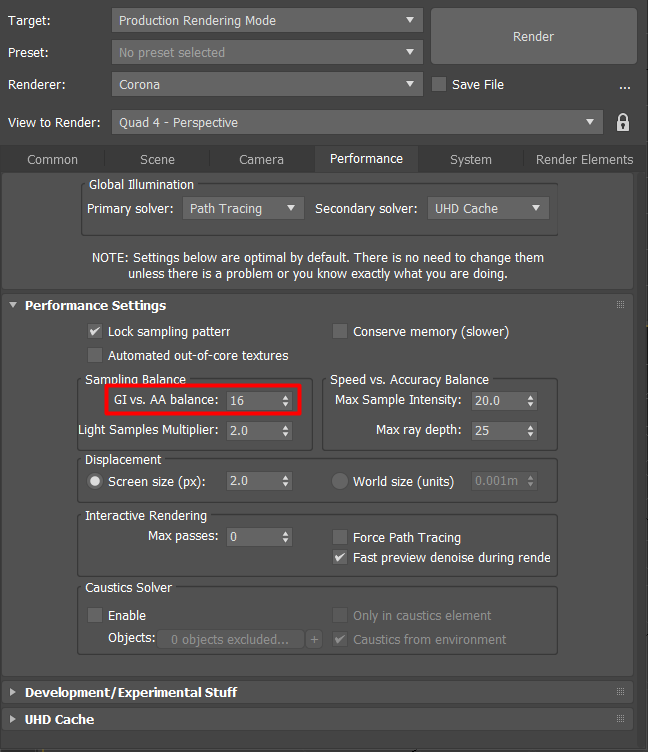

This might suggest that your scene needs more GI samples. To add more GI samples per each render pass, go to:
- 3ds Max:
Render Setup > Performance > Performance Settings > Sampling balance and slightly increase the GI vs. AA balance. The default value is 16, and it is not advised to increase this value above 64. - Cinema 4D:
Render Settings > Corona > Performance Settings > Sampling balance and slightly increase the GI vs. AA balance. The default value is 16, and it is not advised to increase this value above 64.
