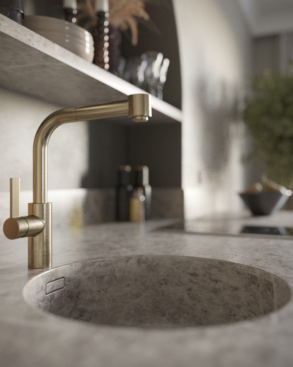

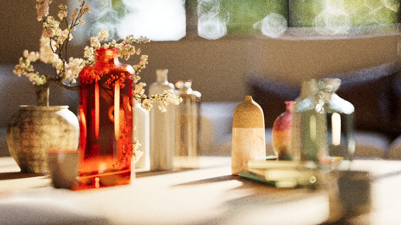

1. Strong depth of field (3ds Max | C4D). Note that while some parts of the image are less noisy with adaptivity off, the overall noise is more uniform with adaptivity on.
1.1. Strong DOF - adaptivity on - 5 minutes.
1.2. Strong DOF - adaptivity off - 5 minutes.

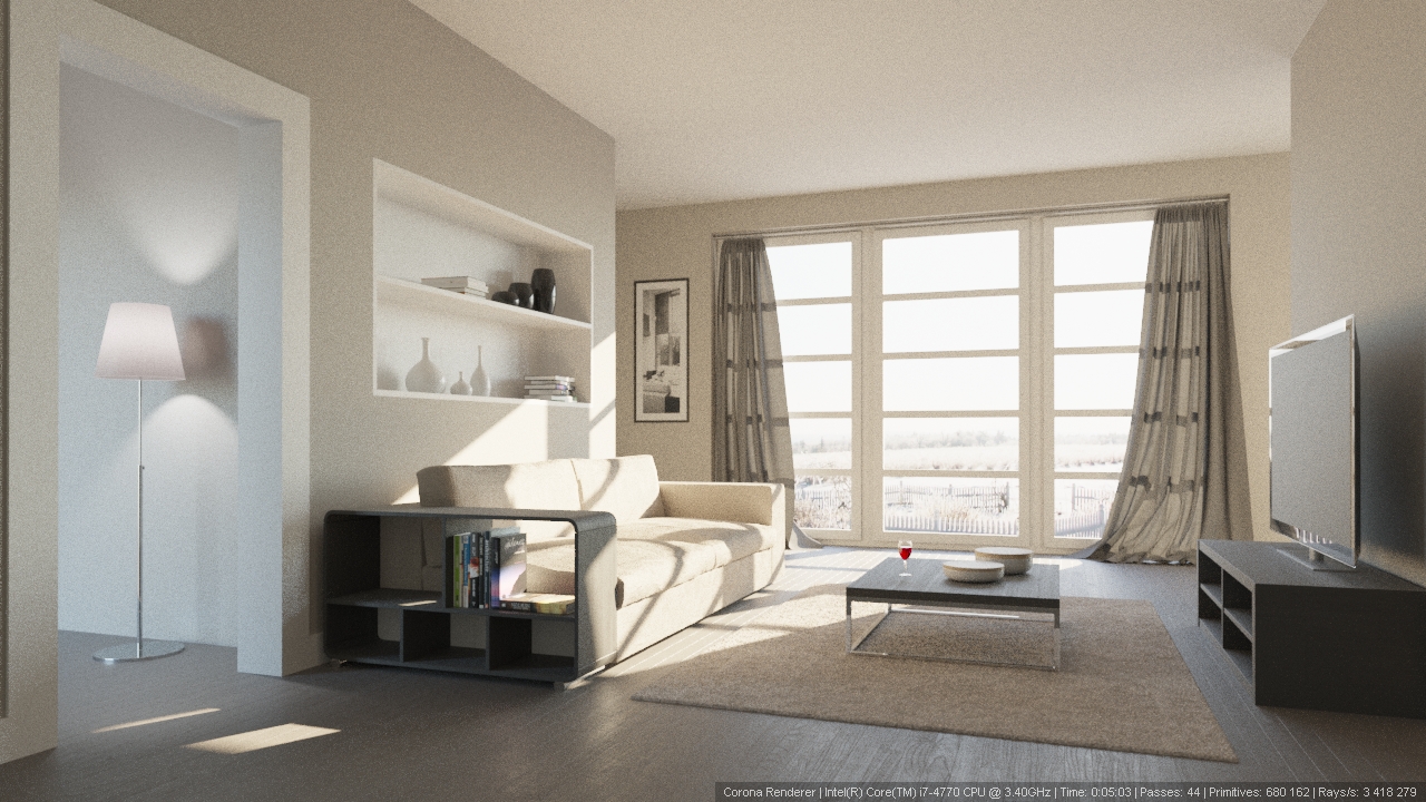

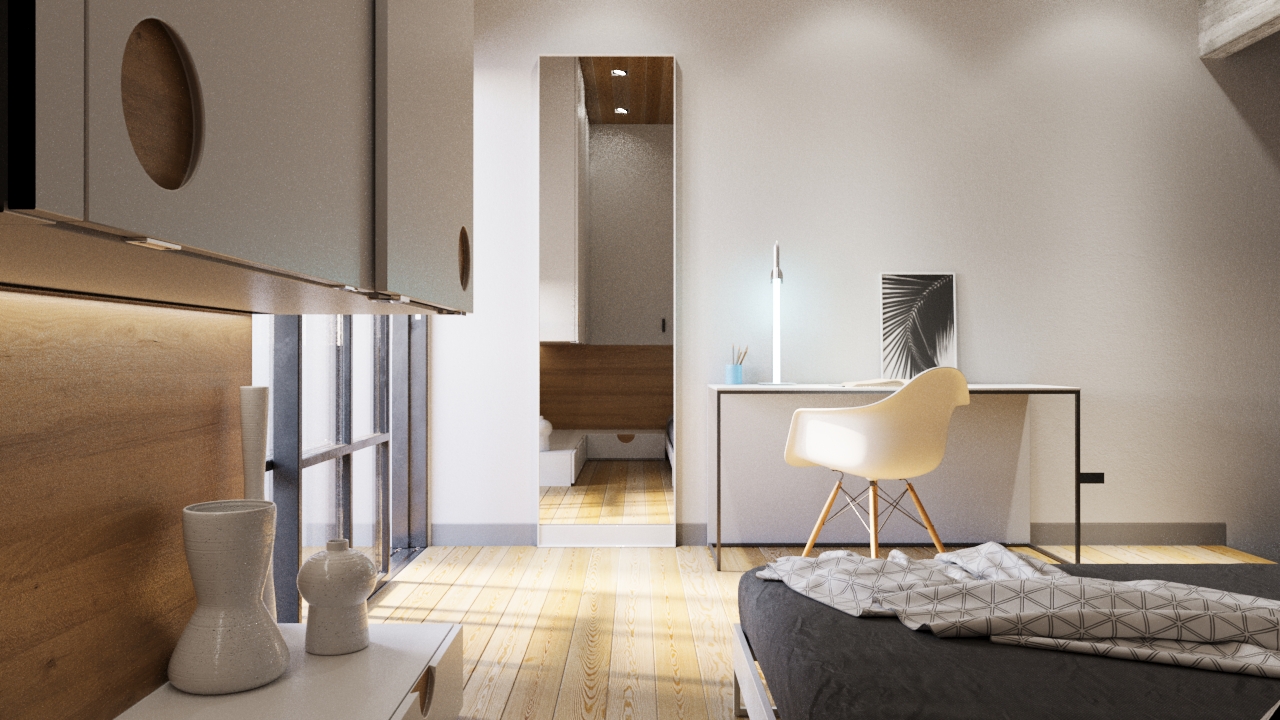

2. Interior scene. With adaptivity off, noise is visible especially under the ceiling lamp in the mirror.
2.1. Interior scene - adaptivity on - 5 minutes.
2.2. Interior scene - adaptivity off - 5 minutes.

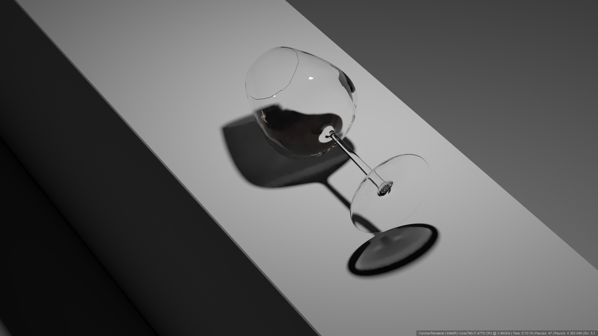

3. Adaptivity and denoising (3ds Max | C4D)
3.1.  Path tracing caustics - adaptivity on, denoising on - 10 minutes.
3.2. Path tracing caustics - adaptivity off, denoising on - 10 minutes.
