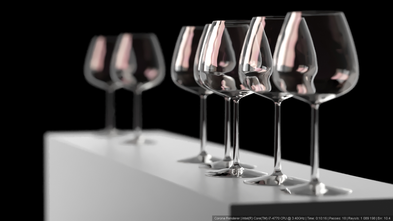

1.3. Denoising on - strong DOF - 10 minutes.
(click to enlarge)
1.4. Denoising off - strong DOF - 10 minutes.
(click to enlarge)
