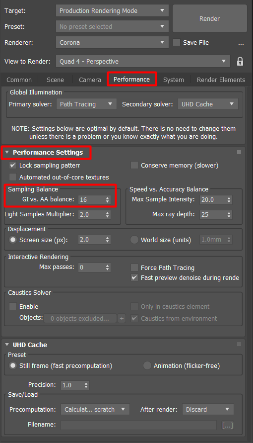

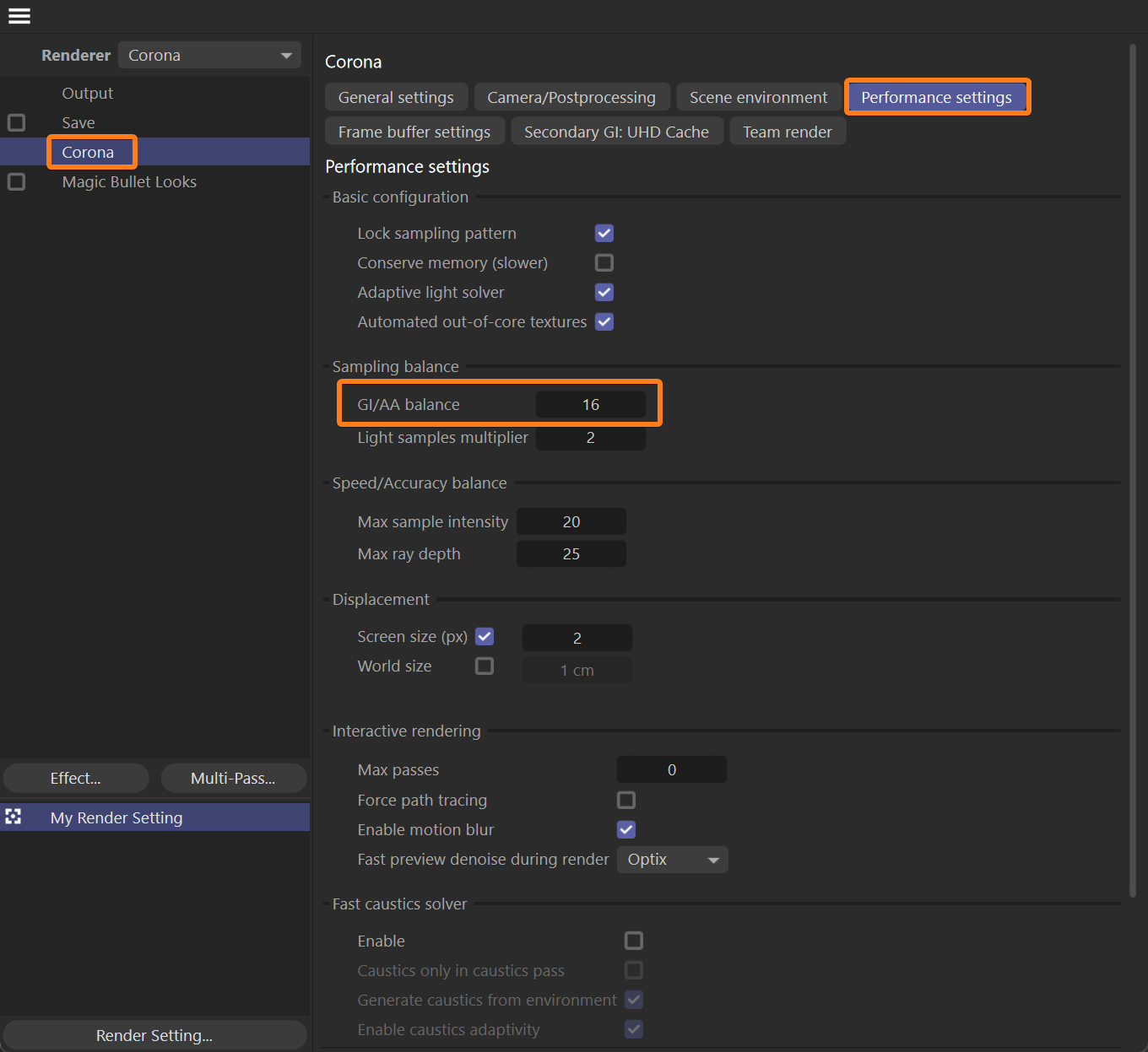

You can find the GI vs. AA balance parameter in:
3ds Max:
Render setup > Performance > Performance Settings > Sampling balance:
Cinema 4D:
Render Settings > Corona > Performance Settings > Sampling balance:

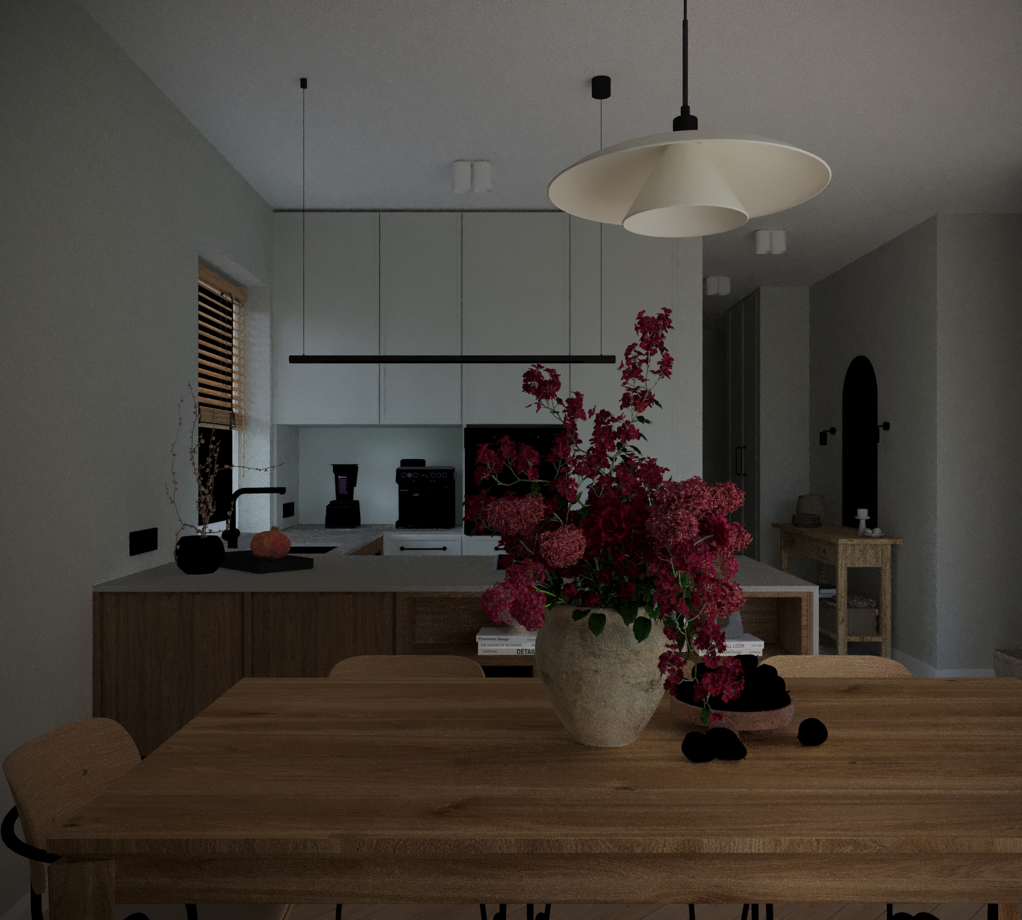

Examples
Default settings
GI vs. AA balance = 16
LSM = 2
30 passes
Render time: 05:46

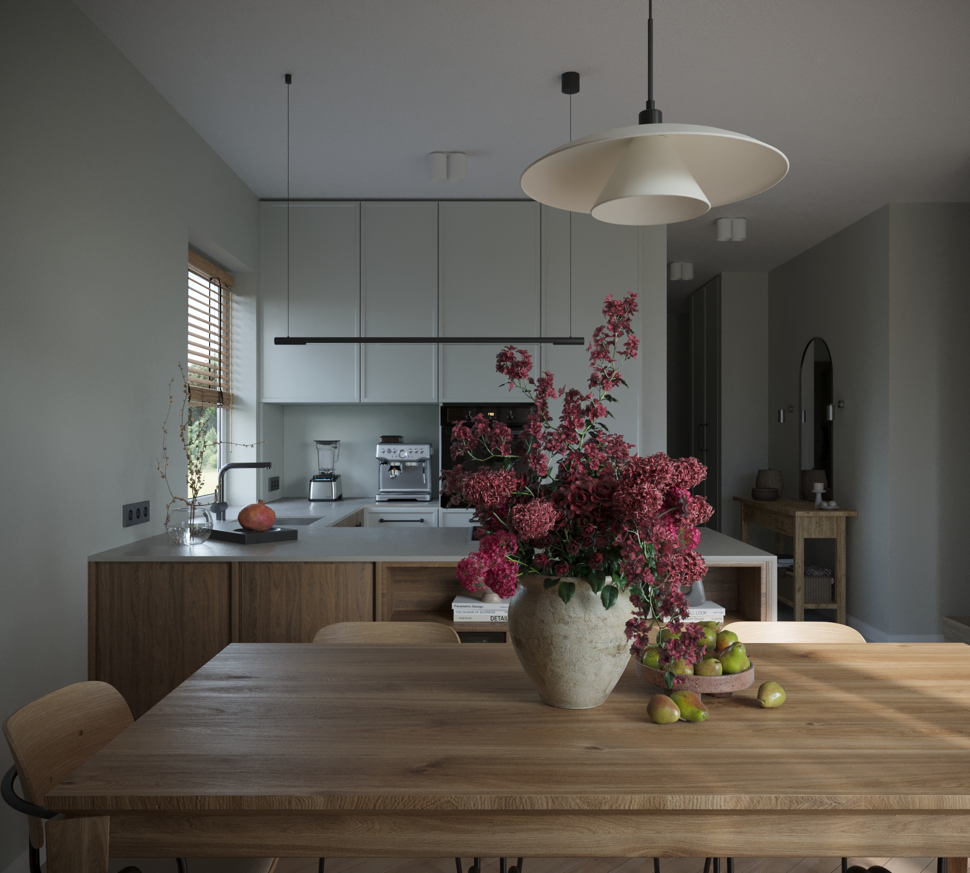

16 samples are used for GI and 16 x 2 = 32 samples are used for direct light. These are the default settings of Corona, which offer a good balance between GI and direct light quality. They will work fine in most interior and exterior scenes.

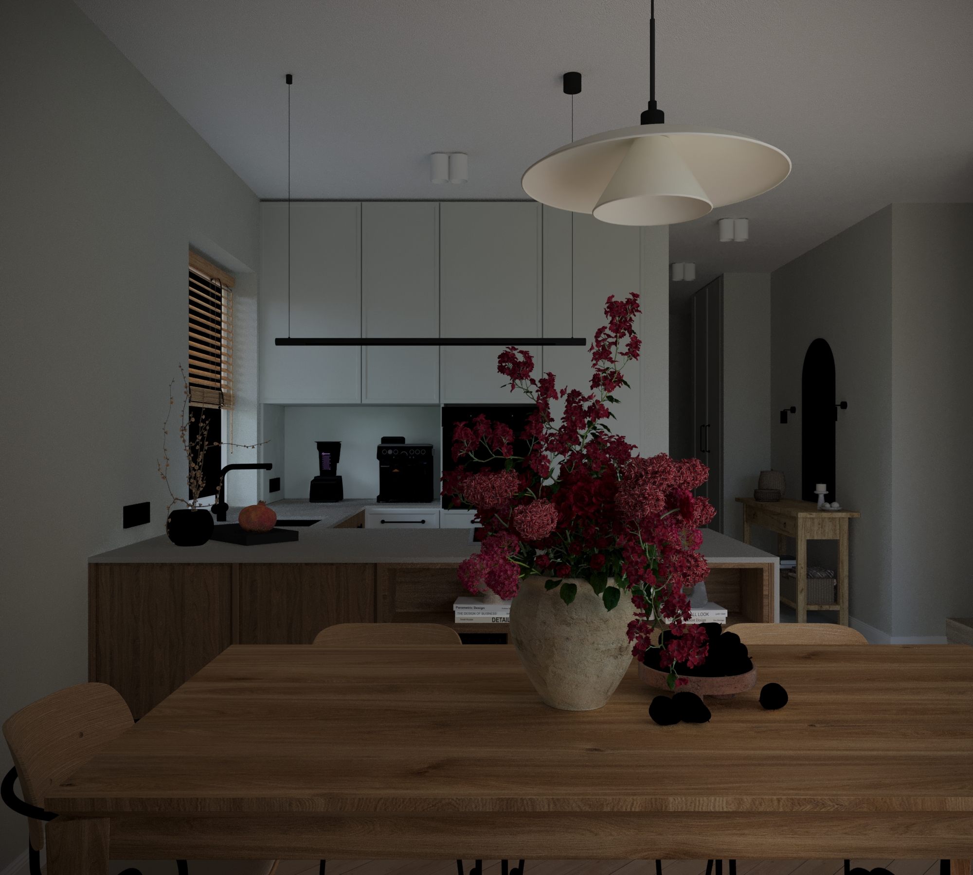

Lowered LSM
LSM = 1
30 passes
Render time: 05:05
The same number of samples (16) is used for both GI and direct light. Note that the quality of GI the GI pass remains the same as when using the default settings, but the quality of the direct lighting pass is lower. Render time is also slightly lower.

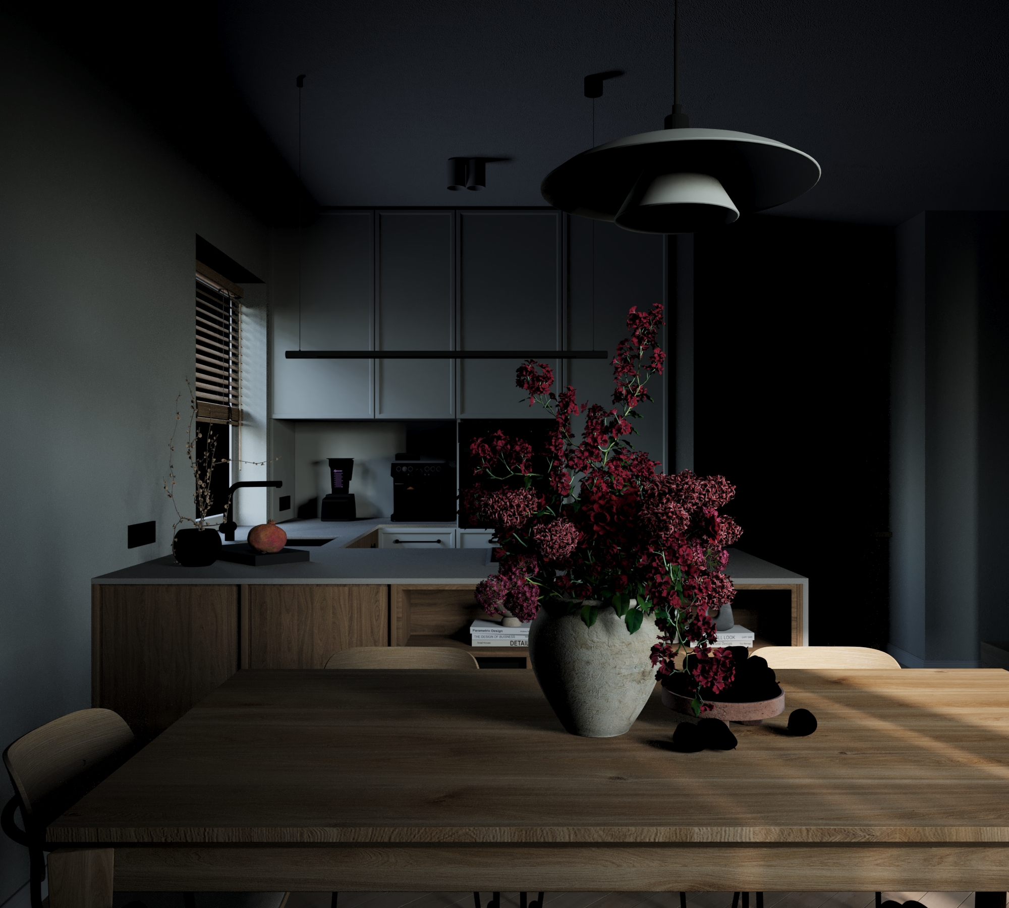

Lowered GI vs. AA balance and LSM
GI vs. AA = 4
LSM = 1
30 passes
Render time: 02:00
The same number of samples (4) is used for GI and for direct light. Note that the overall quality of the image is much worse than with the default settings, even though the number of rendered passes is the same (30). Render time is much lower.

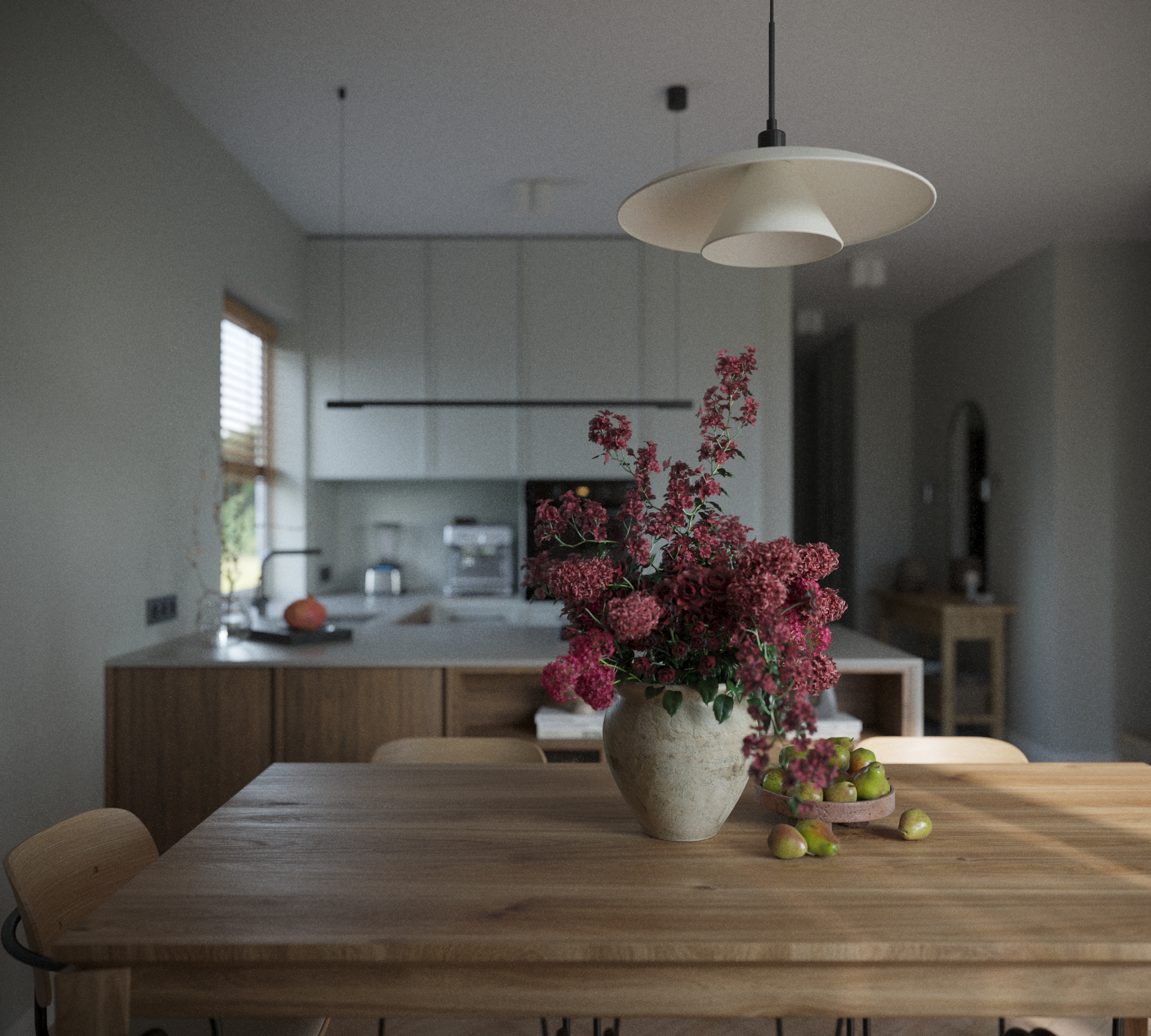

Depth of Field
Default settings - GI vs AA 16, LSM 2
Time limit: 10 minutes
Passes rendered: 19
Note the bad quality of areas where the depth of field is visible:
(click to enlarge)
GI vs AA lowered to 4, LSM 2.
Passes rendered: 37
Note that while the overall quality of the image is similar, the depth of field looks much better in this example:
(click to enlarge)
