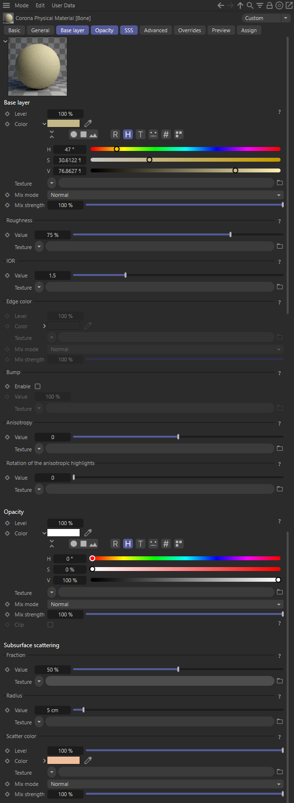

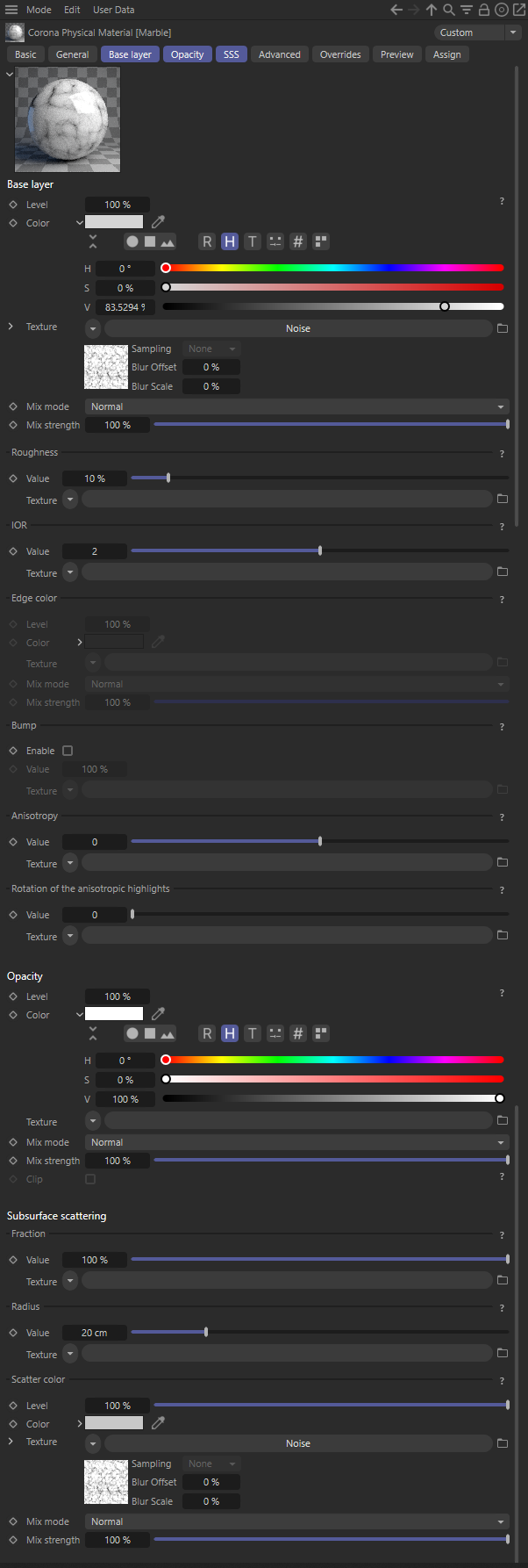

- Marble
[material setup]
- Bone
[material setup]

When using the “SSS” mode, translucency and refraction channels of the material are ignored and greyed-out:
Opacity can be still controlled; however, if it’s lowered, no volume will be visible inside the material, meaning that it is only controlling the visibility of the object’s surface:

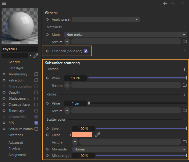

Below are the available controls, which define how the final SSS effect looks:
Amount
Controls how much the material’s color will be affected by the subsurface scattering as opposed to diffuse reflection. A value of 0 results in no subsurface scattering, while a value of 1 results in full subsurface scattering and no diffuse component.
Radius
Defines the subsurface scattering radius – how far a color will scatter from a place that was hit by a light ray.
Scatter color
Defines the scatter color of subsurface scattering – the color that can be observed in the shadowed parts of the material.

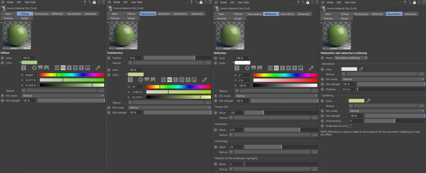

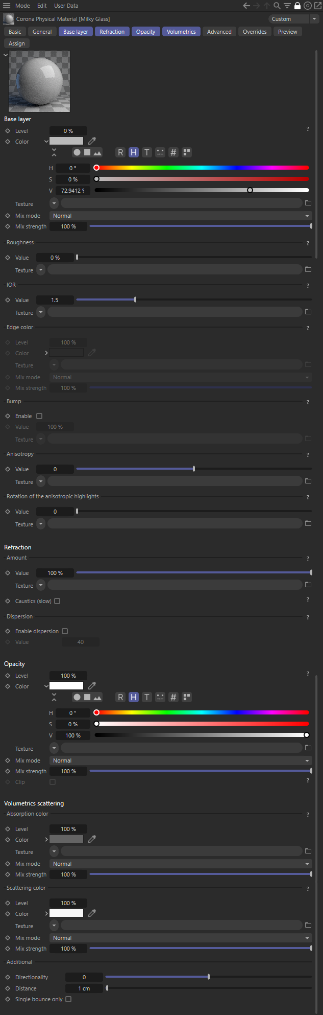

Volumetric scattering is suitable for materials relying on additional effects such as translucency, refraction, or opacity. Materials, which require this mode are usually very thin or refractive, and this includes:
- Translucent plastic (translucency)
[material setup]
- Fruit (such as grapes – translucency)
[material setup]
- Orange juice (refraction)
[material setup]
- Muddy water (refraction)
[material setup]

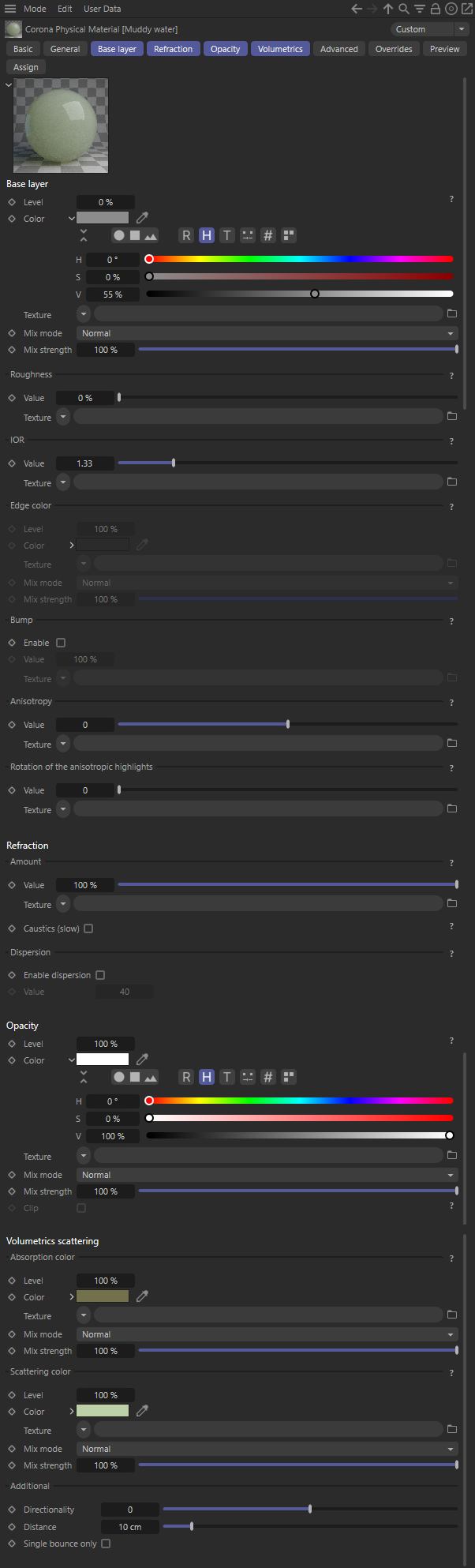

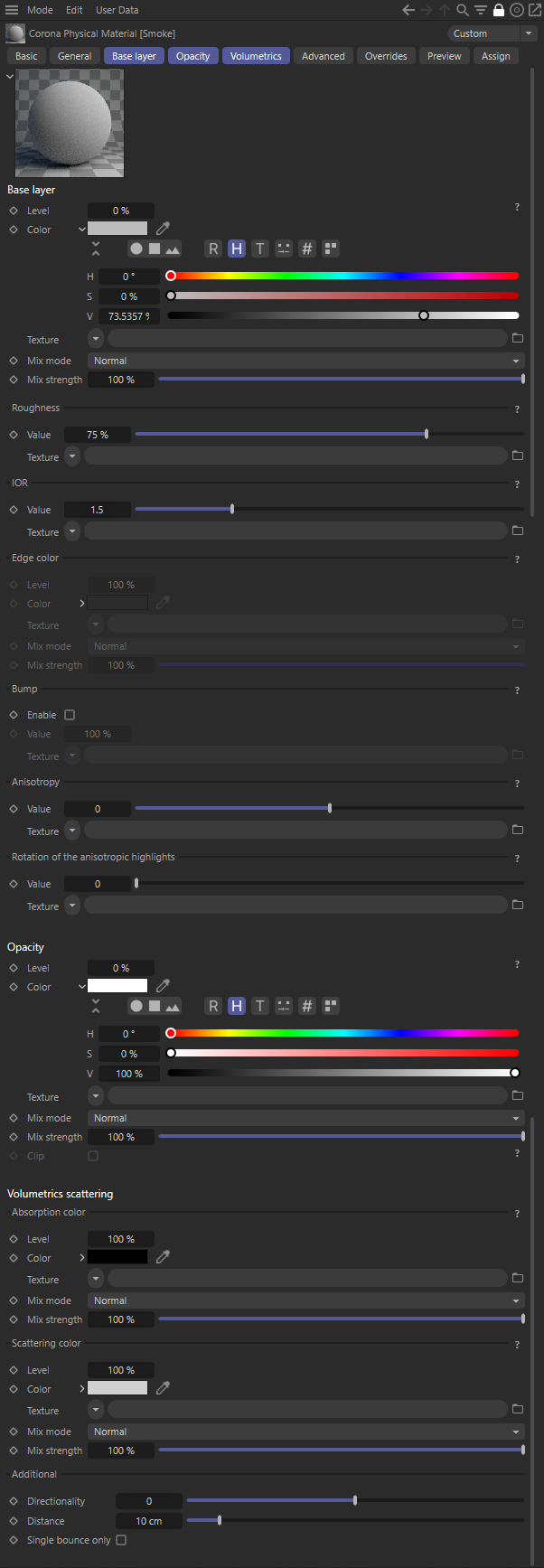

A good method for setting up a material using volumetric scattering is to make its surface completely transparent using Opacity set to 0. You can then adjust the volumetric scattering parameters to see their effect, without interference from other effects, such as reflectivity or translucency, and finalize the material settings once satisfied with the volume's look.

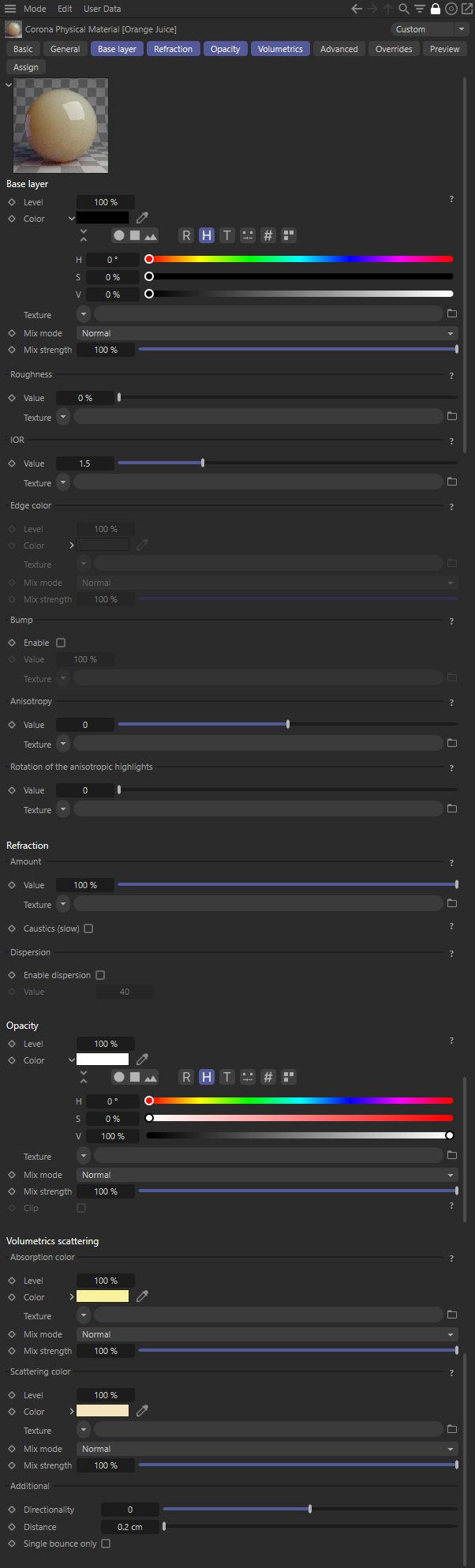

The available properties defining the volume of the material include:
Absorption
This defines the density of the material. It is controlled using two parameters:
Absorption Distance
Controls how quickly the light passing through an object will become colored and darker. The light will be very quickly absorbed with a lower value and appear more strongly colored and darker, even with thin pieces. With higher values, the light will travel farther through the material before these effects happen so that even thicker pieces of the material will not show so much coloring and darkening of the light.
Absorption Color
The color that the white light will take on after passing through the material by the “Absorption Distance”.
Scattering
The color of the scattering media. It affects the coloring of light bounced back toward the viewer by the volume of the material, in much the same way as Diffuse controls the coloring of light bounced back toward the viewer by the surface.
Three parameters control it:
Scattering Color
This controls the color of the light after it is scattered.
Directionality
This controls the direction in which light is scattered. The default of 0 means that light gets scattered evenly in all directions. Positive values mean that light gets scattered forward, along the same path it was already traveling. Negative values mean that light gets scattered backward, back along the path it was traveling.
Single bounce only
Once the light has been scattered, it is still passing through the volume and has a chance that it may be scattered again. By enabling this checkbox, light can only be scattered once, after which it will pass through the volume without further scattering (though it will continue to be affected by absorption), and this gives faster rendering with the trade-off being a darker result and potentially less realism depending on how much the scattering affects the result.
When using the Volumetric Scattering mode, to make the SSS effects visible, at least one of the following material properties has to be enabled:
- Translucency
- Refraction
- Opacity

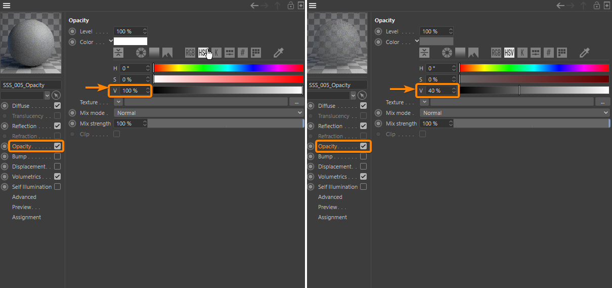

Lowering opacity when using the Volumetric Scattering mode will only make the object's surface transparent and will reveal the object's volume underneath:
[material setup]
