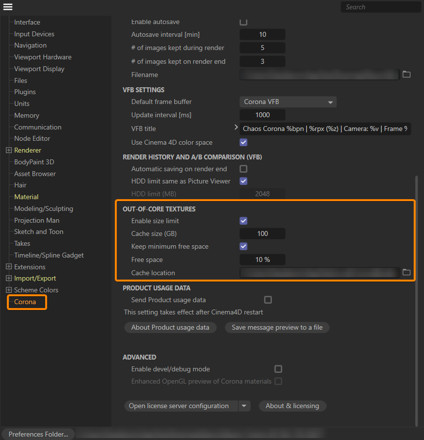

Out-of-core rendering for textures can be found and enabled in Render Settings > Performance:
The parameters for Out-of-core textures can be found in:
Menu Corona -> Preferences -> Out-of-core textures:
You can set the Cache size (GB) and the percentage of the HDD to be left free. If any of those limits are reached, no more offloading of textures to the HDD will take place.
The default texture cache path is "C:\Users\YourUserName\AppData\Local\Temp\CoronaRenderer\ImageTextureCache" and it can be modified to any custom directory.
Note: Out-of-core textures work only with CoronaBitmap.
You can use the "Scene Converter" tool to quickly convert all Bitmaps to Corona Bitmaps, to get the possible performance gains of Out-of-core textures.
