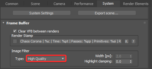

In 3ds Max, You can find the High Quality Image Filter in the System tab of the Render Setup window:

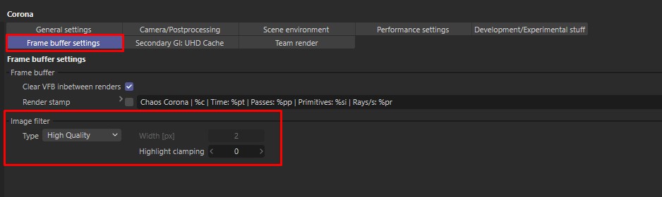

In Cinema 4D, you can find the High Quality image filter in the Frame Buffer Settings tab of the Render Settings window:

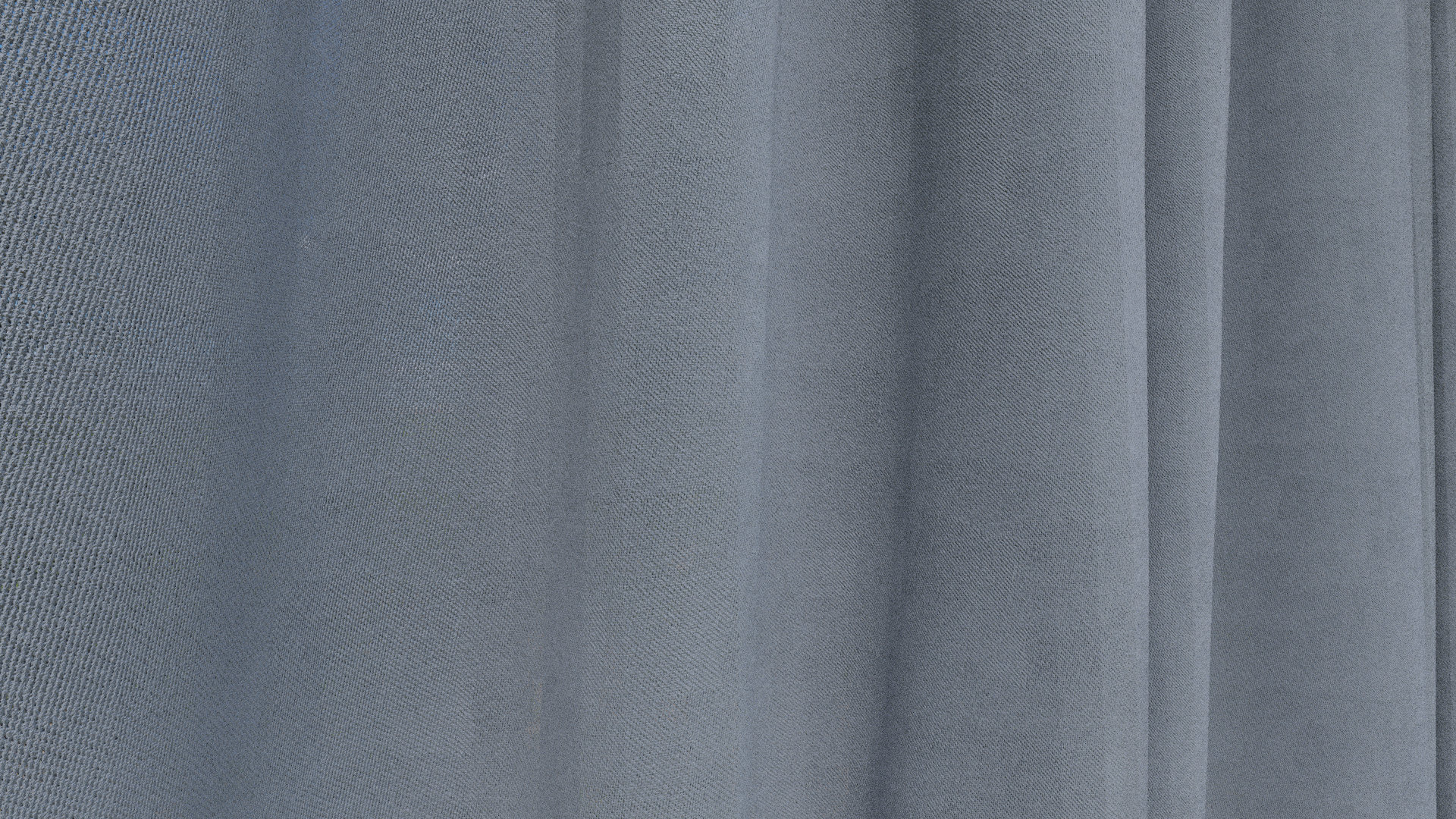

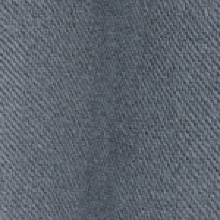

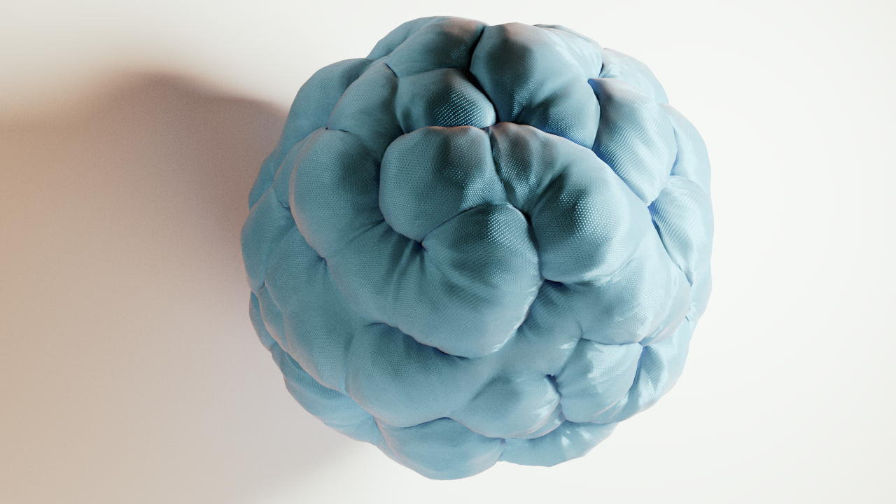

1. Fine Textures
High Quality Filtering
Tent Filtering (2px)
tex-hq30s7pass-crop.png30 seconds, 7 passes rendered
tex-tent30s5pass-crop.png30 seconds, 5 passes rendered
hq60s-crop.png60 seconds, 18 passes rendered
tent60s-crop.png60 seconds, 12 passes rendered
hq5min-crop.png5 minutes, 78 passes rendered
tent5min-crop.png5 minutes, 59 passes rendered
Note that:
  • With the High Quality Filtering, more passes are rendered within the same given time resulting in better overall image quality.
  • The pattern visible on the fabric is generally easier to see with High Quality Filtering.
  • There is less perceivable noise with High Quality Filtering.
  • As more passes are rendered, the differences between High Quality and Tent filtering become less obvious.

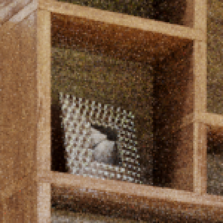

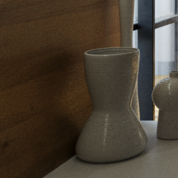

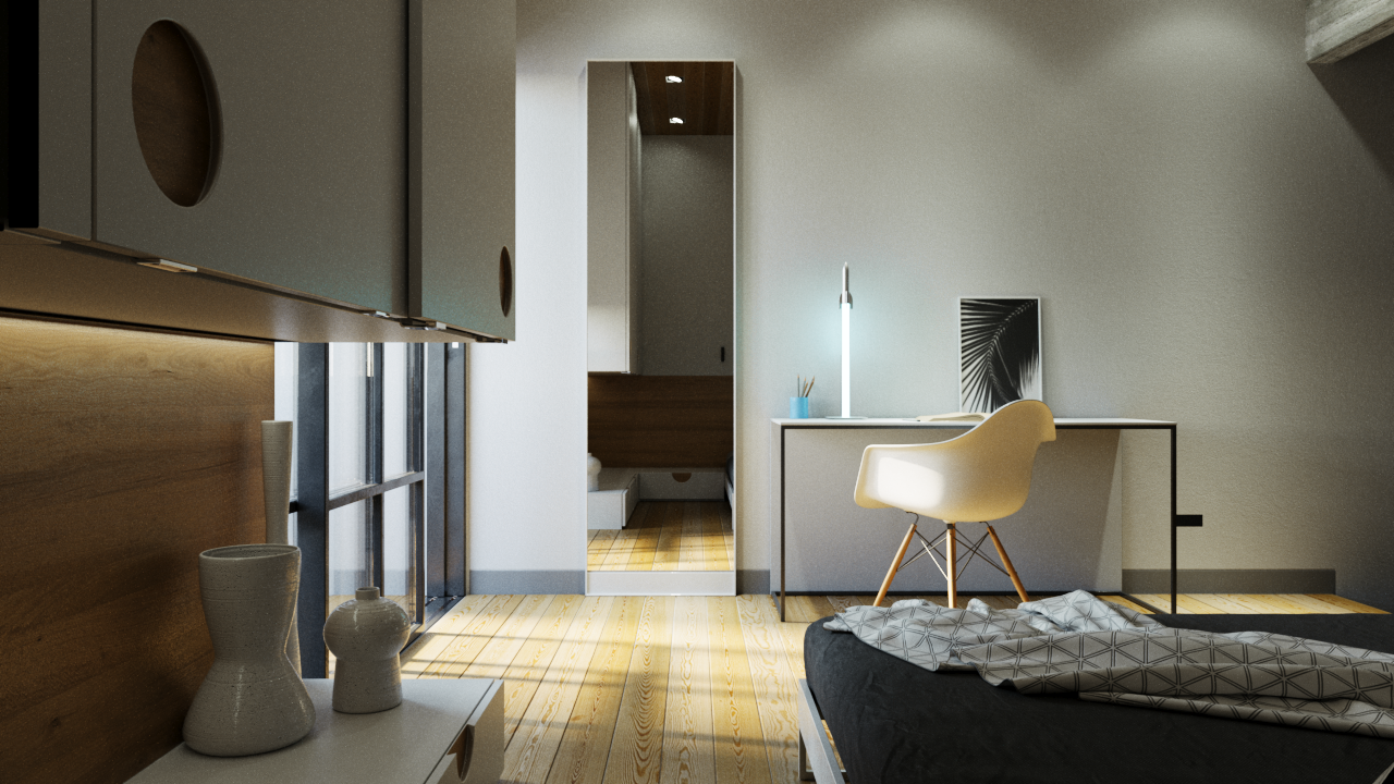

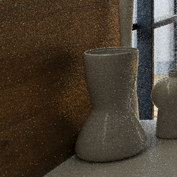

2. GI Noise
ihq30s-crop.png30 seconds, 3 passes rendered
itent30s-crop.png30 seconds, 3 passes rendered
ihq6min-crop.png6 minutes, 29 passes rendered
itent6min-crop.png6 minutes, 21 passes rendered
ihq10min-crop.png10 minutes, 50 passes rendered
itent10min-crop.png10 minutes, 49 passes rendered
Note that:
  • With High Quality Filtering, the noise is "softer" and generally appears more natural to the eye.
