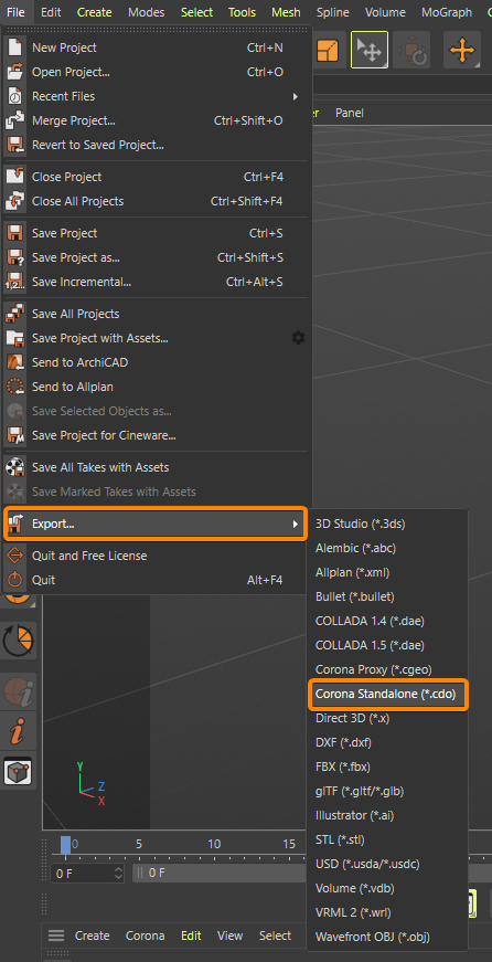

Start Cinema 4D and prepare your scene for rendering.
Once you're ready to render your scene:
In Cinema 4D, go to the menu File > Export... > Corona Standalone (*.cdo).
Then select the location where the scene file should be exported.
This will export the current scene into a .cdo file format
Next, launch the Corona Standalone application (you can also place a shortcut to the Standalone on the Desktop or in the Start menu to access the app easily)
When launched, the application will show a dialog asking for the scene to be rendered - select your .cdo file, and it will start rendering immediately.

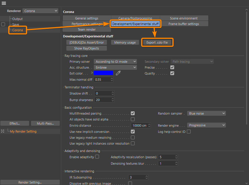

In Cinema 4D, go to the Render Settings > Performance > Development / Experimental Stuff and press Export .cdo file, then select the location where the scene file should be exported.
- Next, launch the Corona Standalone application (you can also place a shortcut to the Standalone on the Desktop or in the Start menu to access the app easily)
