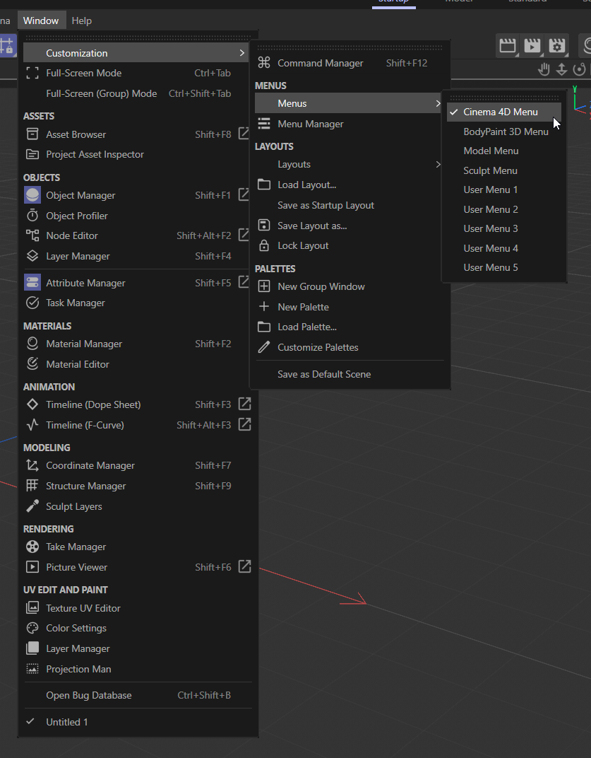

In the top menu, go to Window > Customization > Menus and pick a menu which features the Corona item, such as the main "Cinema 4D Menu":
This should bring back the Corona item.

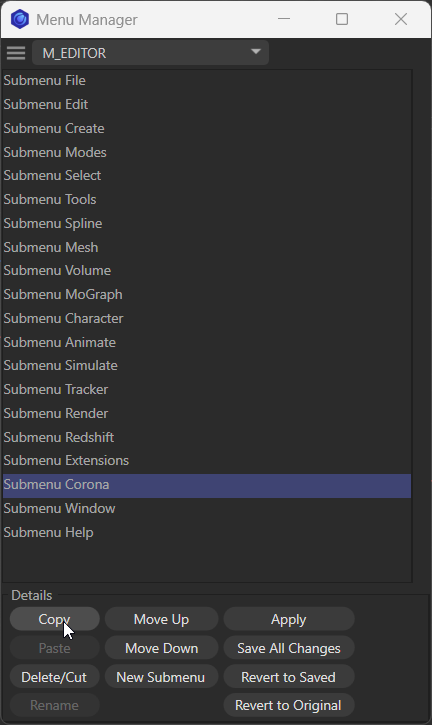

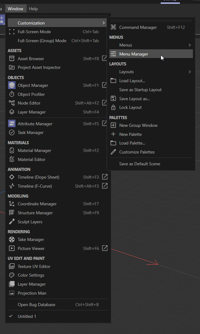

Alternatively, if you would like the Corona item to appear in a different menu layout, such as the "Model Menu" - go to Window > Customization > Menu Manager:
In the Menu Manager, make sure you have "M_EDITOR" selected in the dropdown at the top of the window. This is the main Cinema 4D menu. Locate the "Submenu Corona" item in the list, select it, and click "Copy":

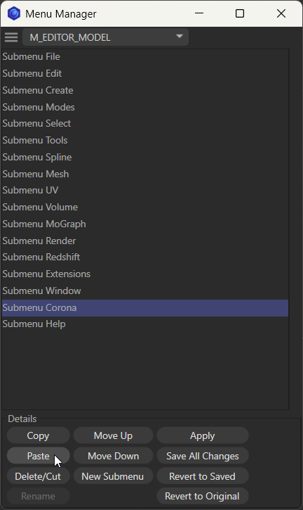

Using the dropdown at the top of the window, select the menu in which you would like to add the Corona item. For example, if you would like to add the Corona item to the Model Menu - select "M_EDITOR_MODEL" from the dropdown. Then click "Paste" to add the previously copied "Submenu Corona" item to the current menu:
Lastly, apply the changes.
