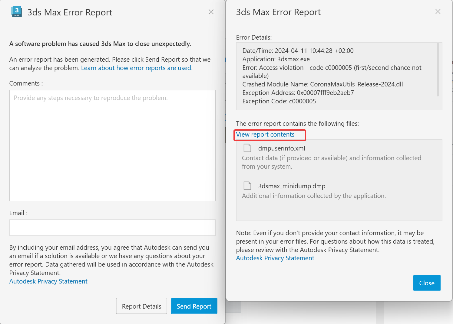

How to find the 3ds Max minidump file
  • When 3ds Max crashes, you will usually see a “3ds Max Error Report” window.
  • From this window, you can locate and access the minidump file:

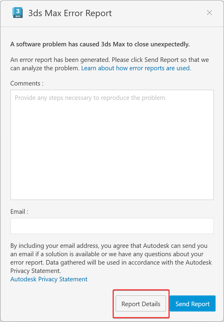

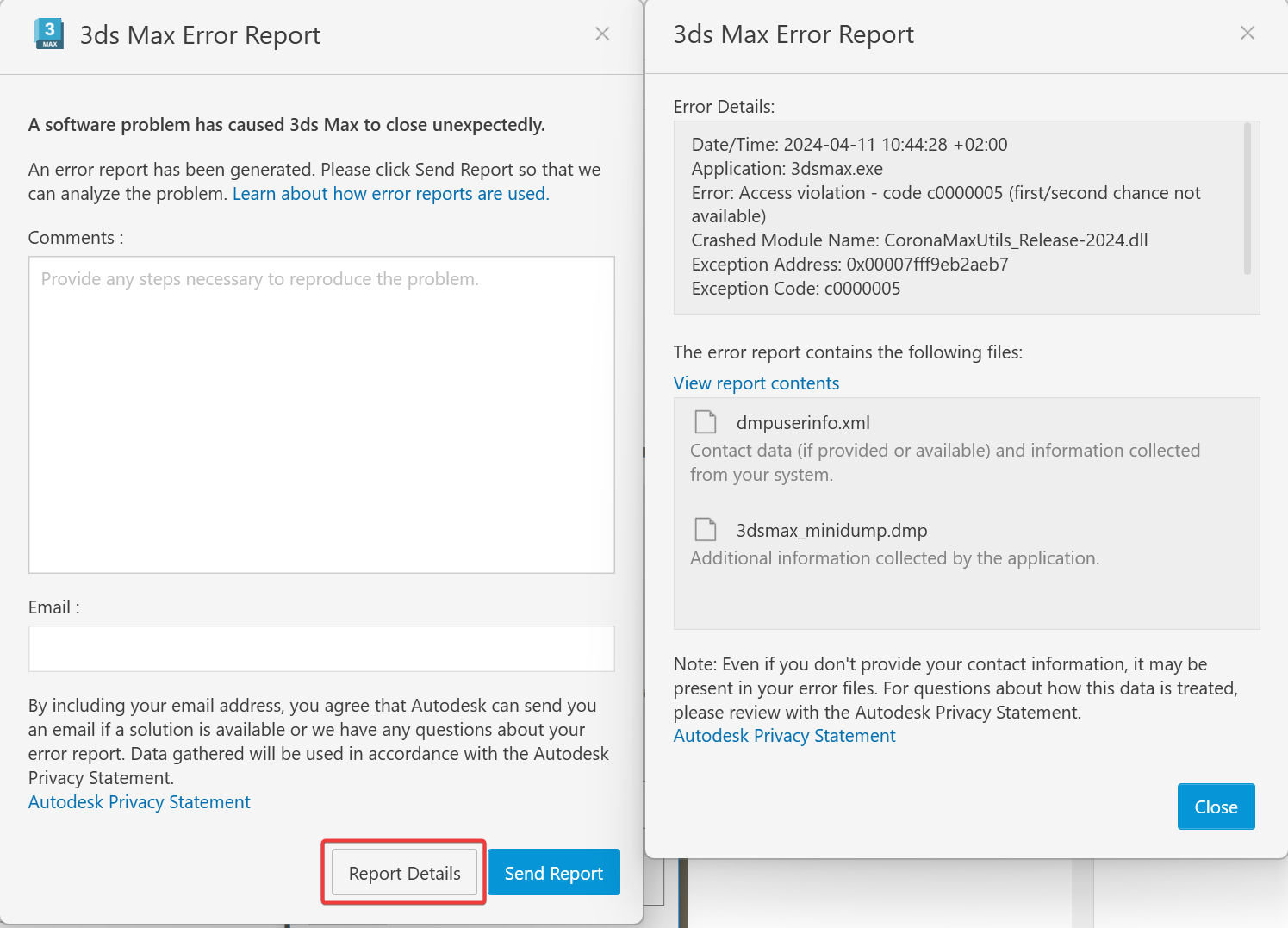

1. The 3ds Max Error Report window appears. Do not close it during this whole process.
3ds Max 2026 and newer
3ds Max 2025 and older
2. Click "View error details" (3ds Max 2026 and newer) or "Report Details" (3ds Max 2025 and older).
3. 3ds Max 2025 and older only: Click "View report content":

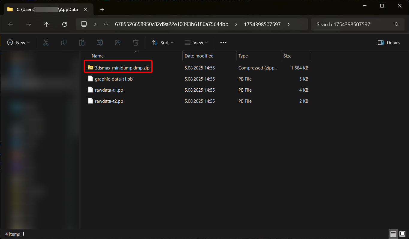

4. At this point, you should see a folder with either a 3dsmax_minidump.dmp.zip file (3ds Max 2026 and newer) or 3dsmax_minidump.dmp file (3ds Max 2025 and older). These are the files we need.

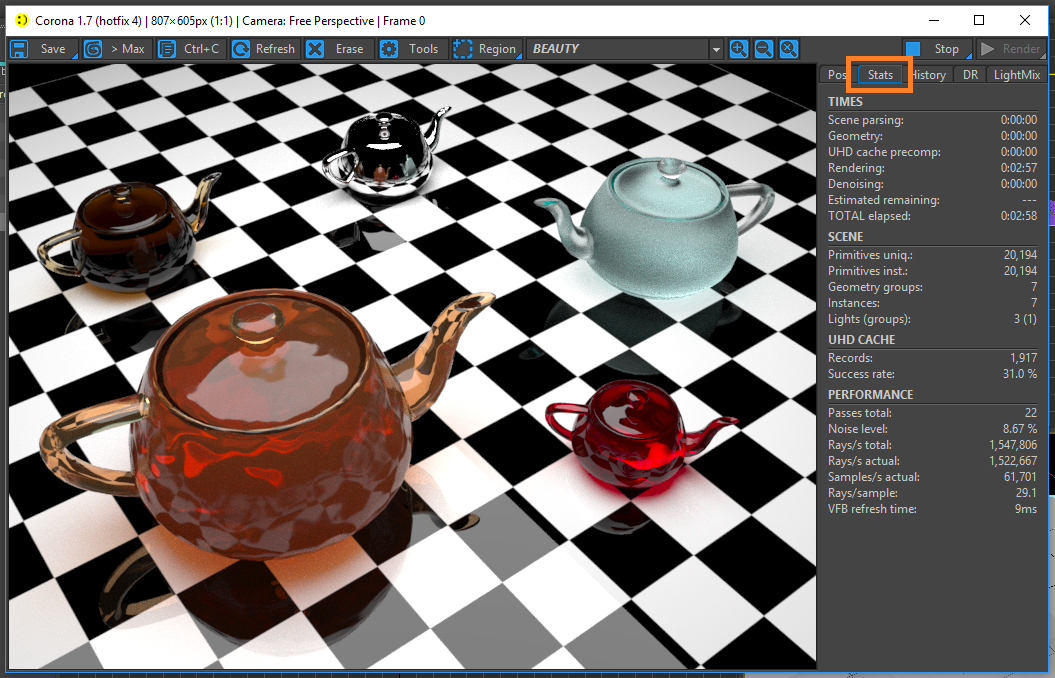

4. Exceptionally Slow Rendering
If your rendering is unusually slow
  • Please include a screenshot of the Stats panel from the Corona VFB when submitting your bug report.
  • The information shown there can be crucial for identifying the cause of slow rendering.
