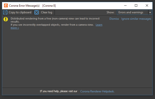

Note: the error messaging system will catch the known issues, and will warn you about any detected problems. This is often helpful for troubleshooting.
