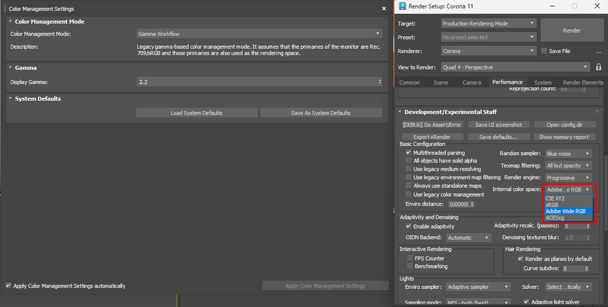

  • Previously used default - Gamma workflow - is supported as is, and will give the same results as before. When gamma workflow is used in 3ds Max, Corona defines its internal color space for rendering, found in Developmental/Experimental settings:
    Note: no need to change any default settings. This is how things have always worked.

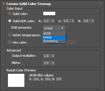

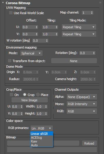

  • CoronaColor and CoronaBitmap can define the color space (RGB primaries) of the input:
  • Color Picker can now select color also in the current rendering space. Previously users could pick between sRGB and linear sRGB, now there is the extra rendering space option:
Note again: these are specifically useful for OCIO workflow, which will use Rendering color space (wider space) for shading evaluation. With Gamma workflow, the values are always converted to Linear sRGB to be used (mixed) with other maps.

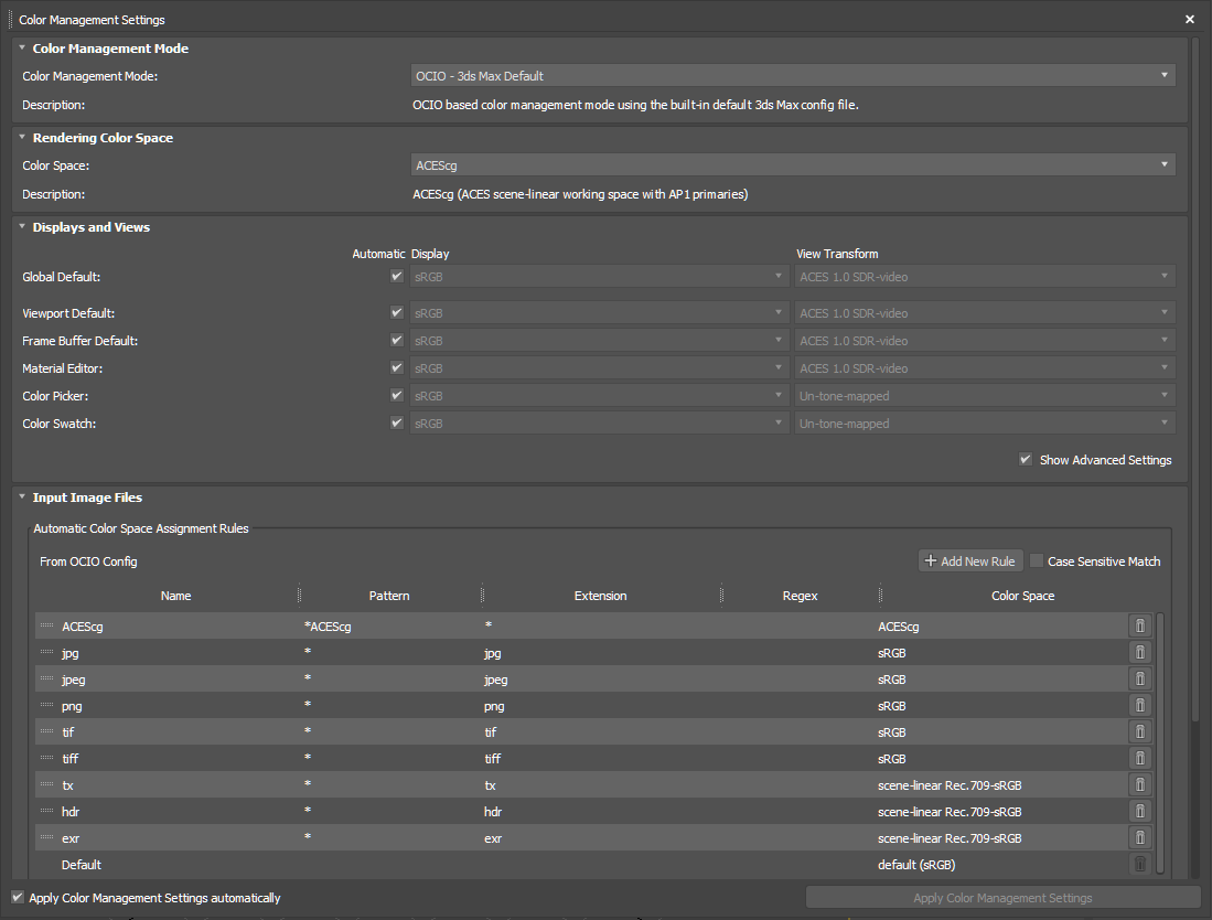

When OCIO modes are used:
  • Rendering Color Space defined in 3ds Max settings is respected by Corona.
  • These settings from “Displays and Views” in 3ds Max Color Management are respected:
      • Viewport Default - The colors in viewport are transformed to the display color space and then the “View Transform” is applied to them. When drawing, for example, a Corona Light in the viewport, its color is transformed to the “Display” space and then the “View Transform” is applied on it. In the legacy gamma mode, the “Display” space was linear sRGB and the “View transform” was simple gamma correction.
      • Material Editor - both options are supported, 3ds Max settings are respected.
      • Color Swatch - the same thing, the colors selected by color picker are displayed in the given “Display” space with the “View Transform” applied
      • Color Picker - does not respect the “Display” and “View Transform” settings, just the option to pick the color in the current rendering space is added. The reason is that it does not change the previous color picker workflow as much as if we made it more like the new 3ds Max color picker.
  • Selecting color space of saved image - when using the OCIO mode, the saving dialog has options to select the color space transformation or display/view transformation applied to the saved image. These settings are part of 3ds Max UI unrelated to Corona.
