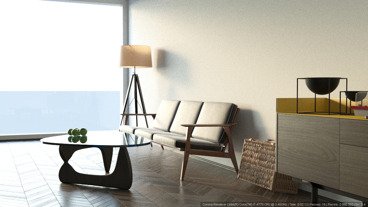

1. Clamping = 0 (default value)
No highlight clamping occurs. Bright highlights and "jagged" edges are visible (lamp leg).

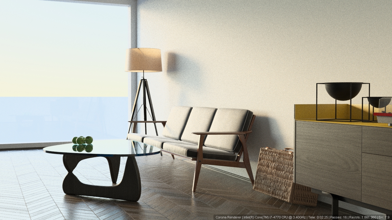

2. Clamping = 1
Very low value causes visible highlight clamping which makes the image unrealistic. Note that no "jagged" edges are visible on the lamp leg.
Click to enlarge

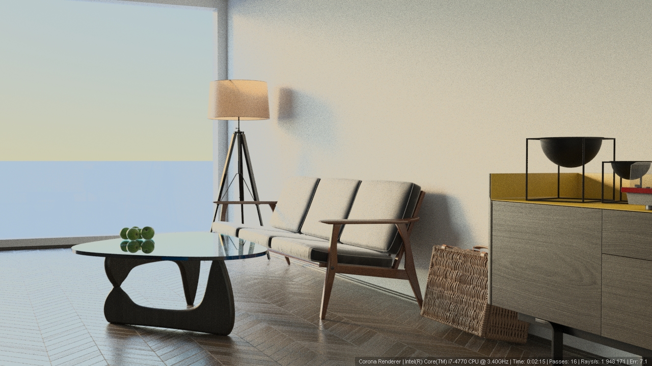

3. Clamping = 2
Clamping is still visible. No jagged edges visible.
