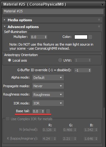

Where to find it?
The Base Tail parameters can be located in the ''Advanced'' settings of the Corona Physical Material:

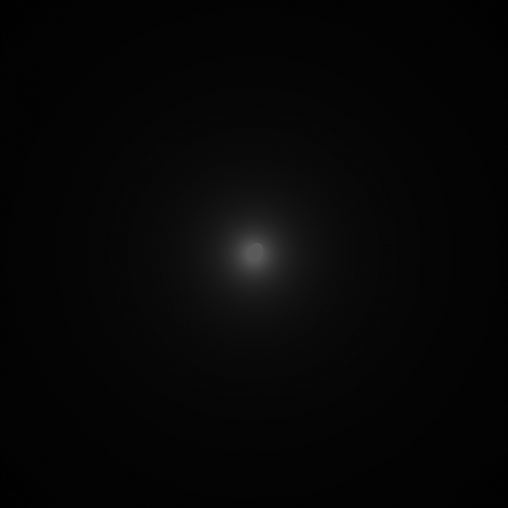

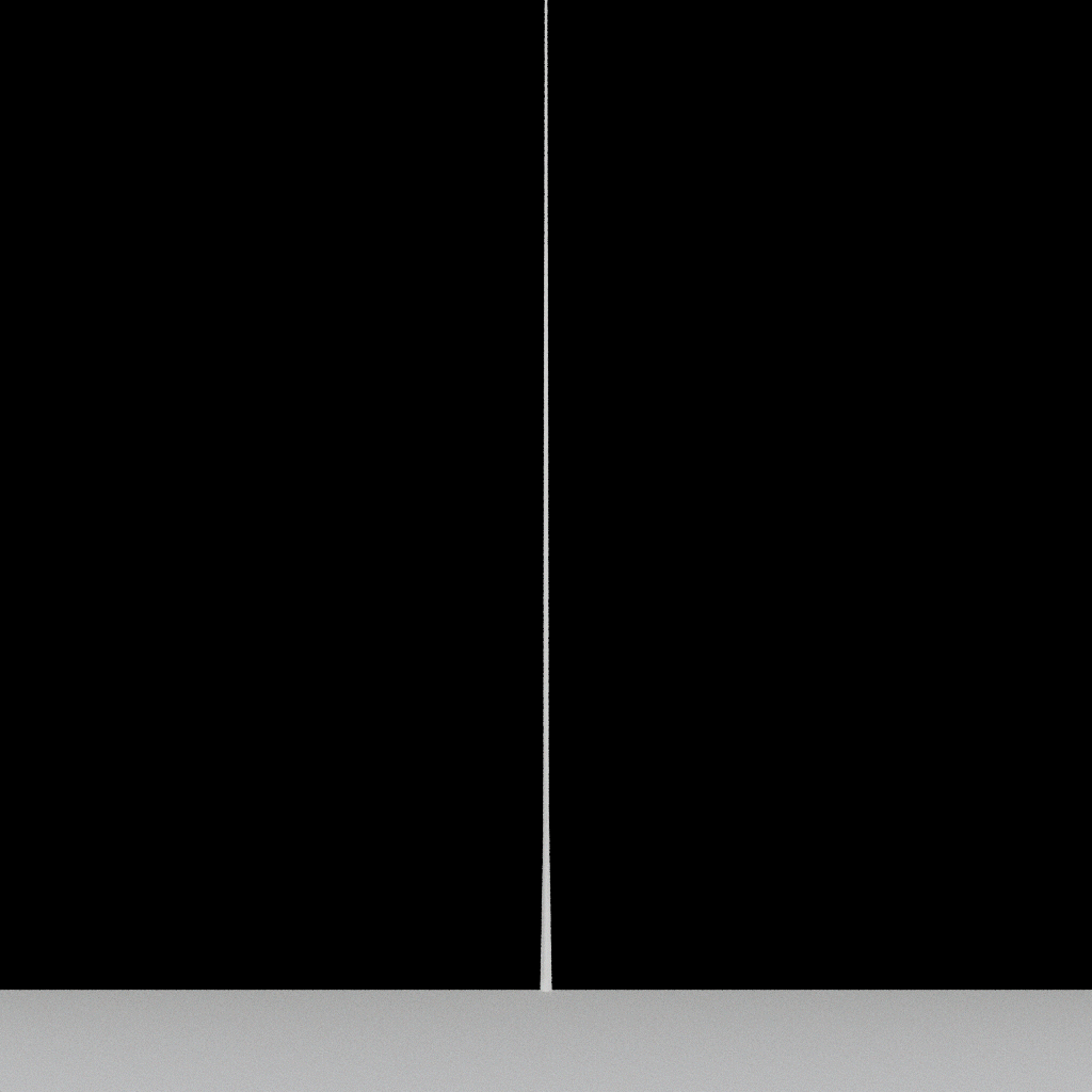

Base Tail animated from 0.5 to 1.0
Note how the peak of the reflection remains very high and mostly the base falloff is affected.
  "side view"

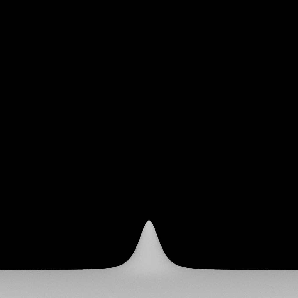

Roughness animated from 0.5 to 1.0
Note how both the peak and the base of the reflection are affected. The reflection is "blurred" in a more uniform way.
  "side view"

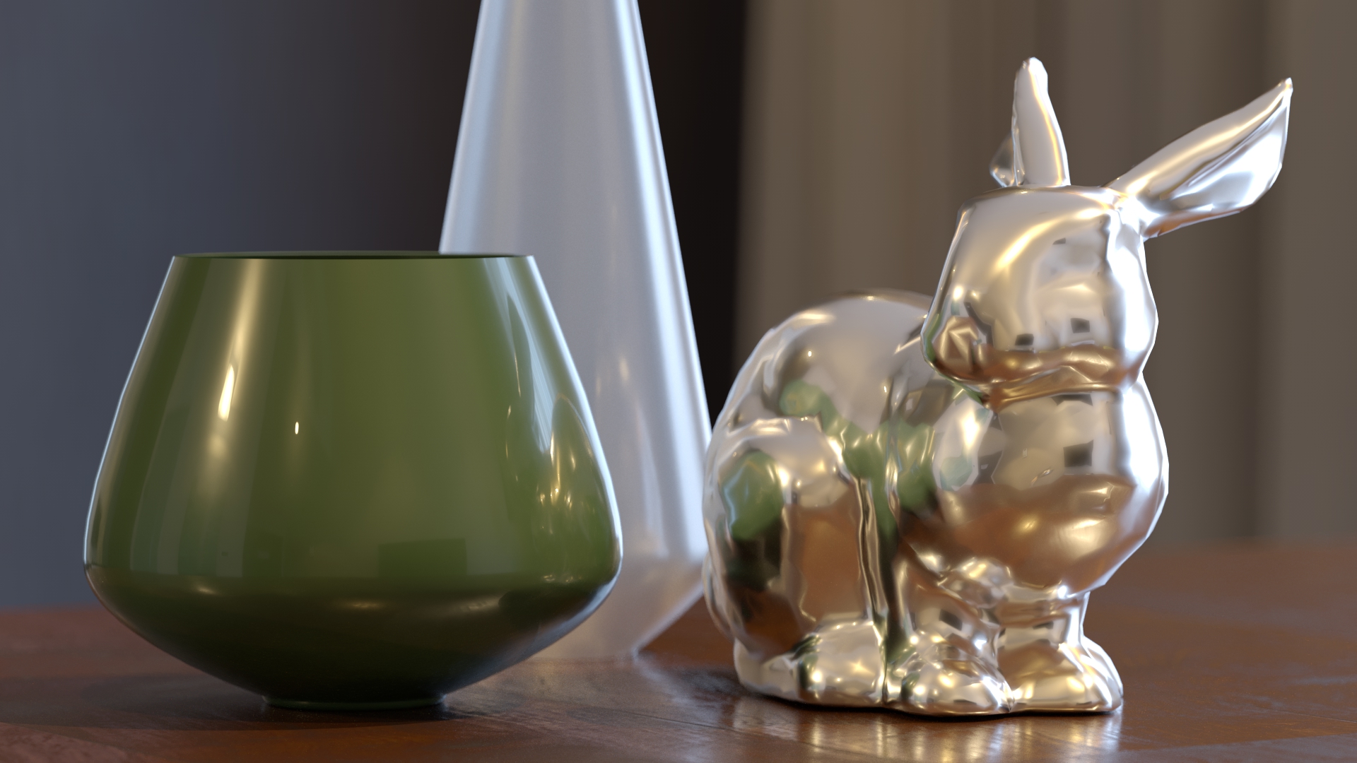

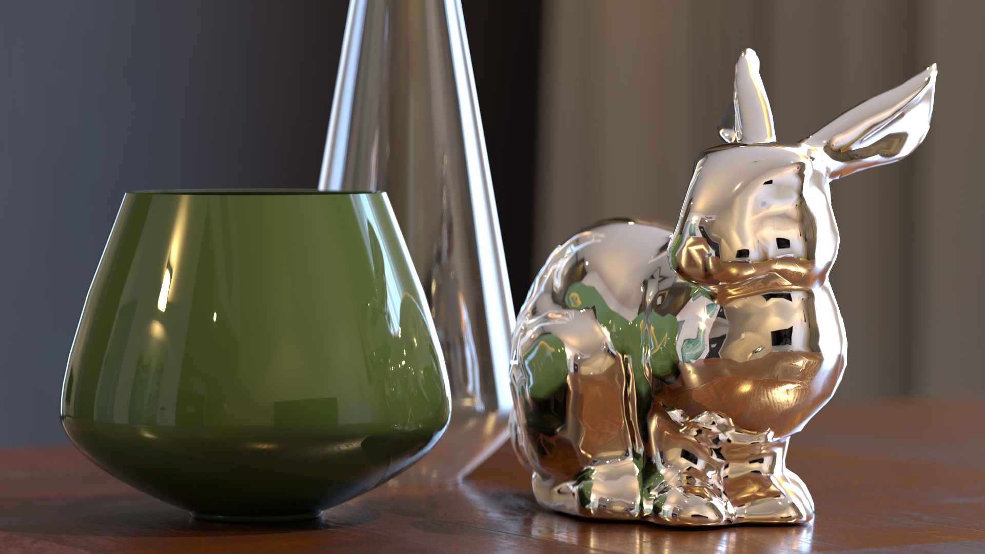

The image comparison below shows the difference between using Tail (left image) and Roughness (right image) to adjust reflections — with Roughness, the entire reflection becomes blurred, while with Tail there is less blurring of the overall reflections while highlights remain equally affected:

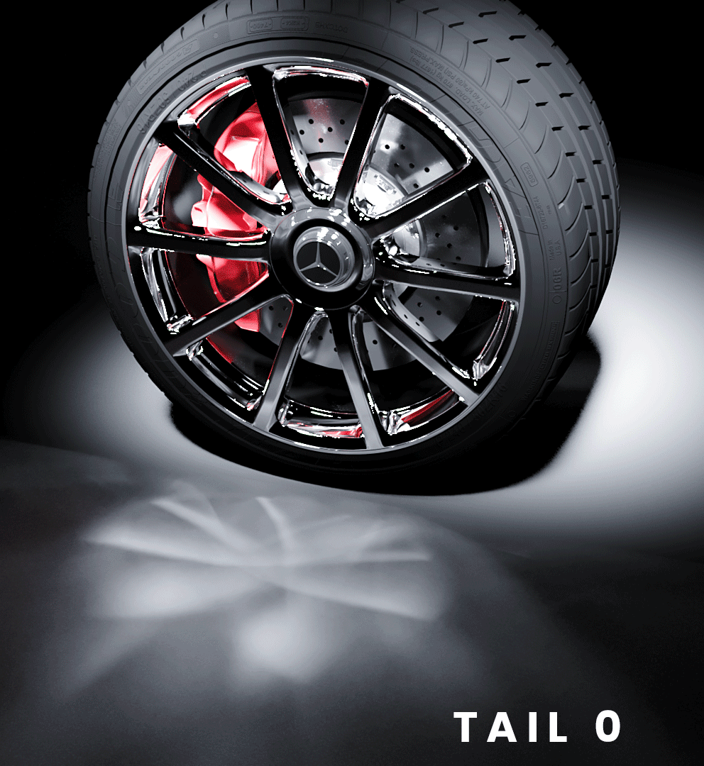

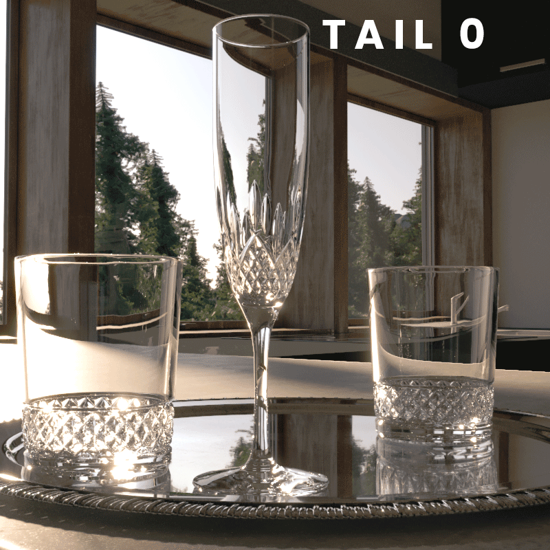

In this example, you will notice that the caustics are also correctly affected by the Tail value:

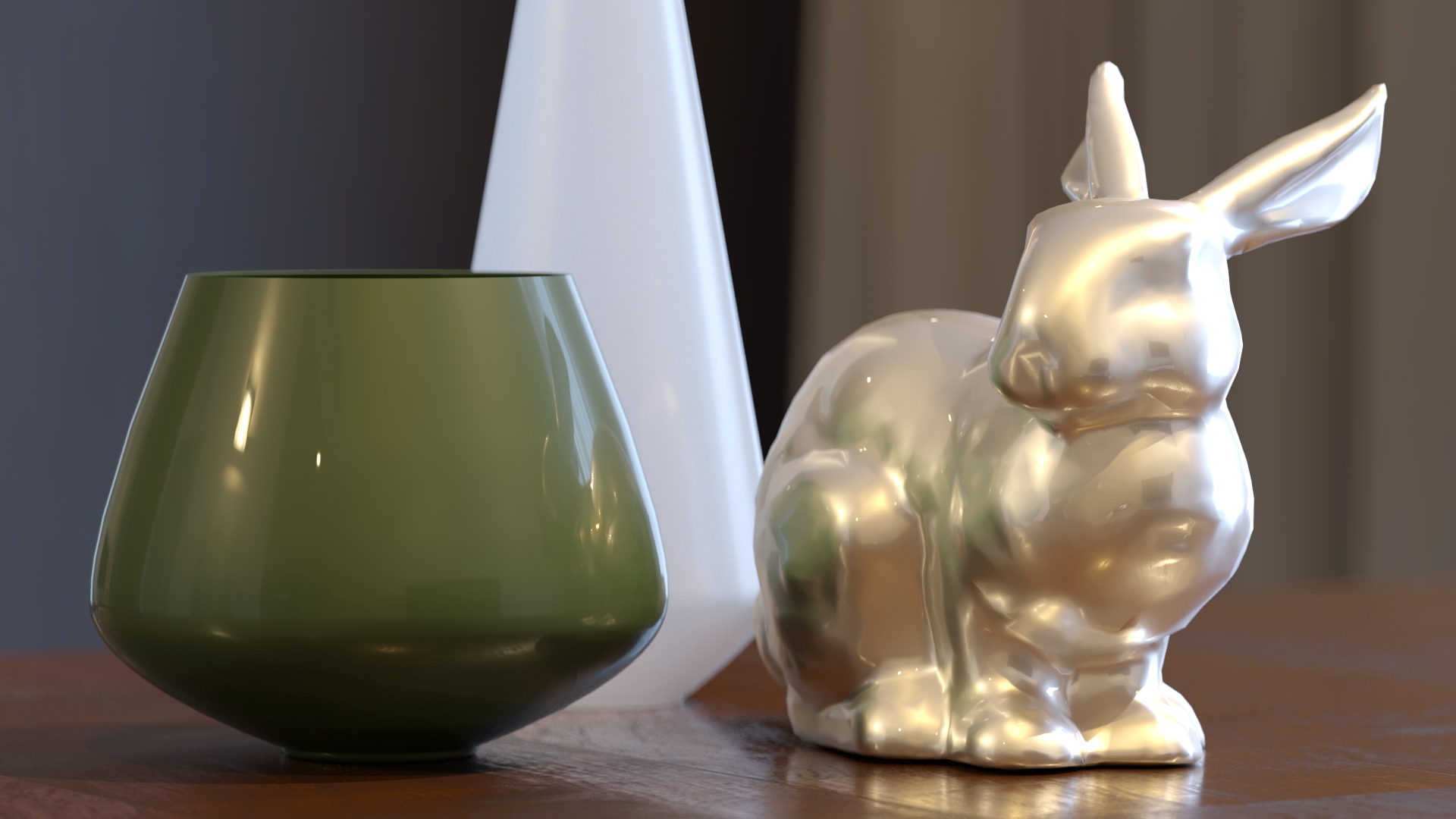

The Tail also affects both reflections and refraction:

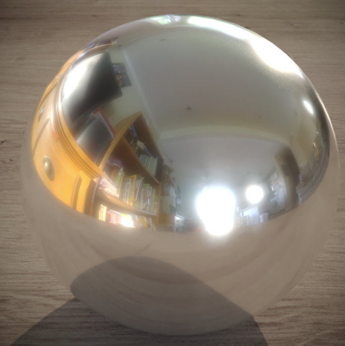

It can also be mapped, as seen on the metal tray (we varied the Exposure of the bitmap to change the effect, so the tray doesn’t specifically match the Tail values shown in the overlay text).
Base Tail of 0%:
Base Tail of 25%:
Base Tail of 50%:
Base Tail of 90%:
Base Tail of 100%:
