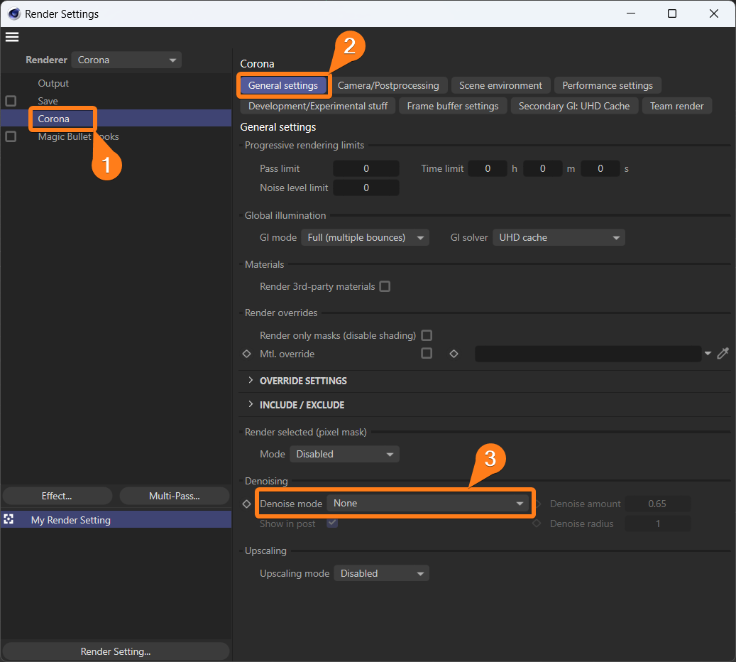

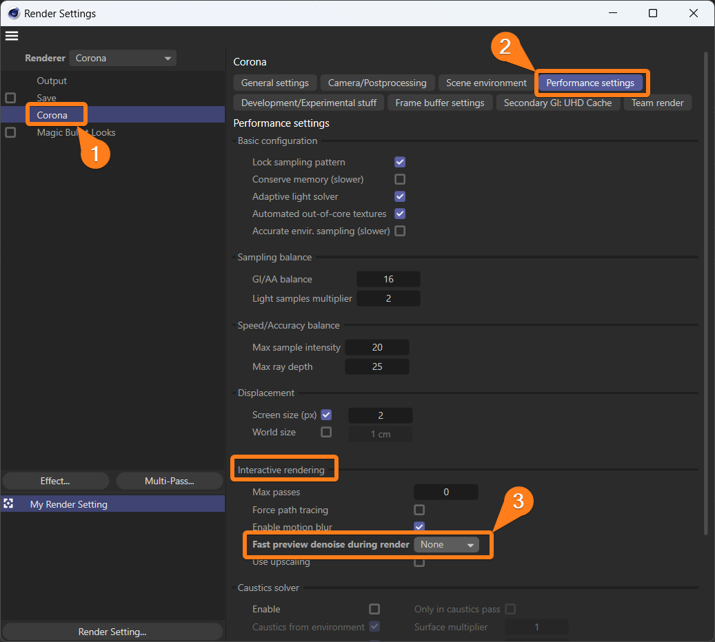

1) NVIDIA AI Denoising
Solutions:
Disable NVIDIA AI Denoising completely.
Note: it has to be disabled in two places to disable it for interactive and non-interactive rendering:
  • Render Settings > Corona > General Settings > Denoising > Mode (set to "None" or try other denoising mode)
  • Render Settings > Corona > Performance settings > Interactive rendering > "Fast preview denoise during render" mode (set to "None" or try other denoising mode)

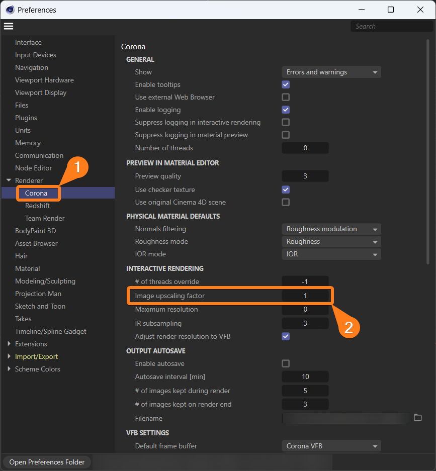

2) Image upscaling factor
Solution:
  • You can disable the image upscaling factor in the Corona menu > Preferences > Corona > Interactive Rendering > Image upscaling factor (set it to 1.0).

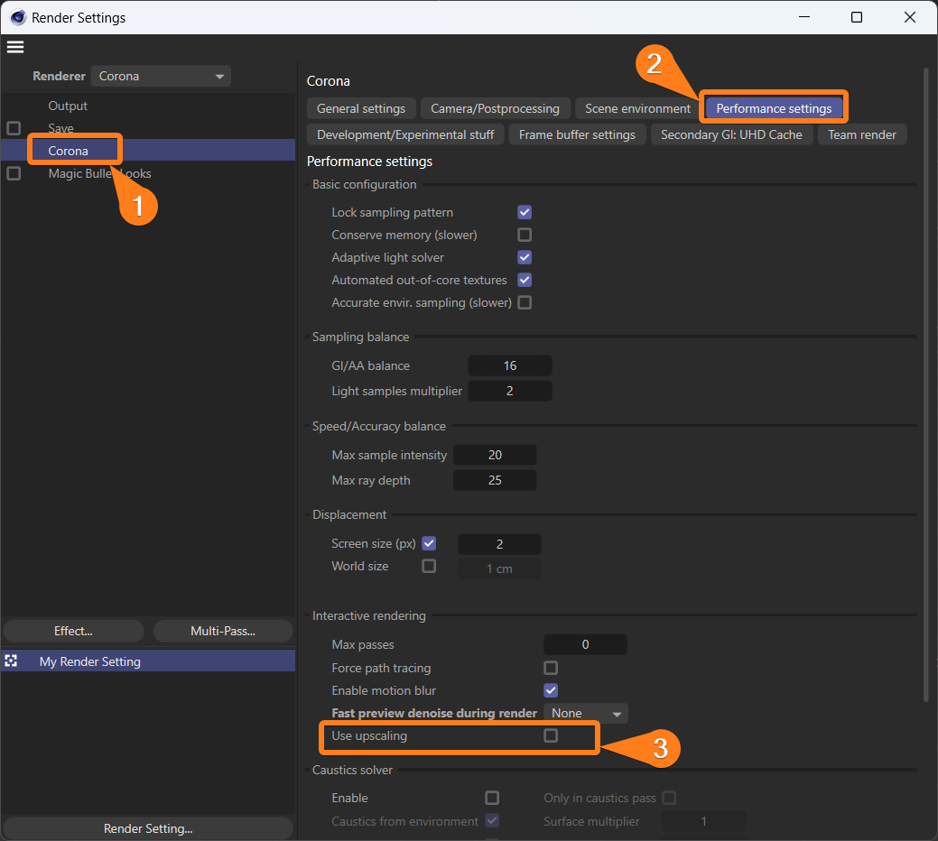

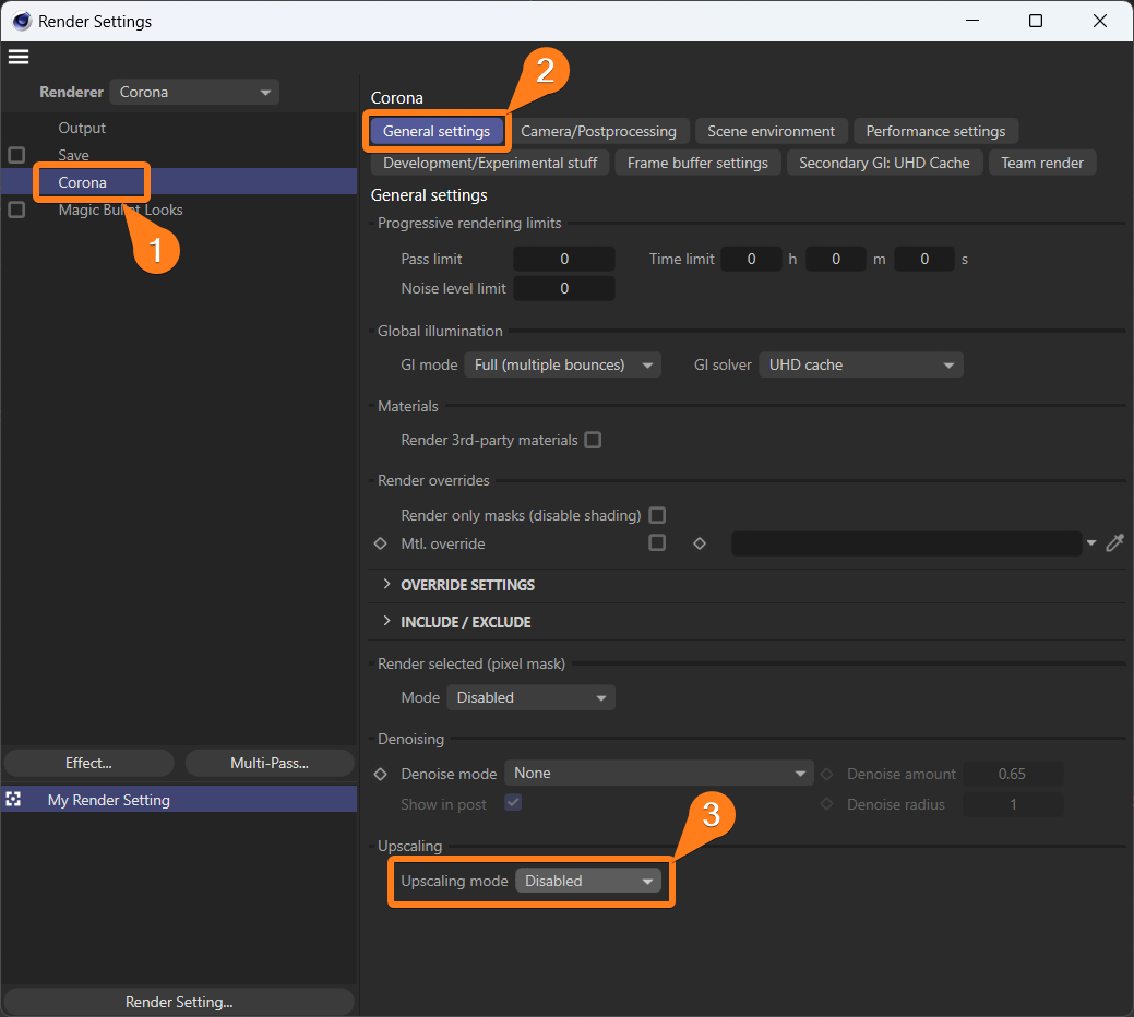

3) NVIDIA AI Upscaling
Solution:
Disable the NVIDIA AI Upscaling for production and interactive rendering:
  • Render Settings > Corona > General Settings > Upscaling mode (set to "Disabled")
  • Render Settings > Corona > Performance settings > Interactive rendering > "Use upscaling" (disable this checkbox)
