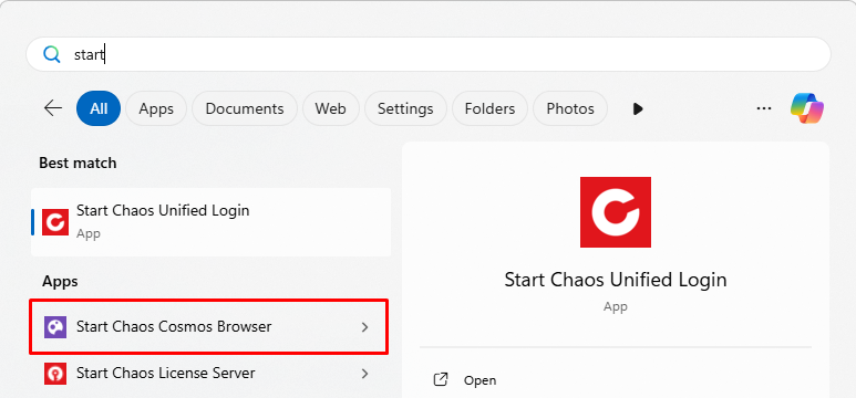

Solution 1: Restart the Cosmos Service
This is the quickest fix and often solves the problem:
  1. Click your Windows Start button
  2. Type "Stop Chaos Cosmos Browser" and click it
  3. Type "Start Chaos Cosmos Browser" and click it
  4. Go back to 3ds Max and try clicking the Cosmos icon again

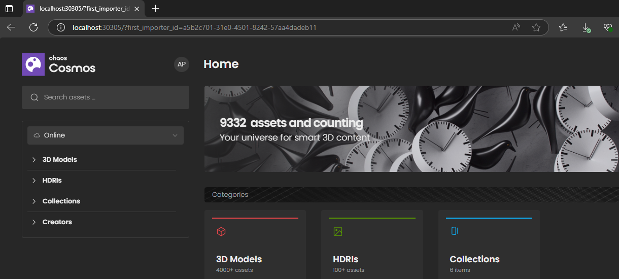

Solution 2: Check if Cosmos Works in Browser
Before continuing, let's check if Cosmos is running properly:
  1. Open your web browser
  2. Go to: http://localhost:30305
  3. If Cosmos opens in the browser, the service is working - the problem is just with the 3ds Max integration
  4. If it doesn't open, continue with the solutions below

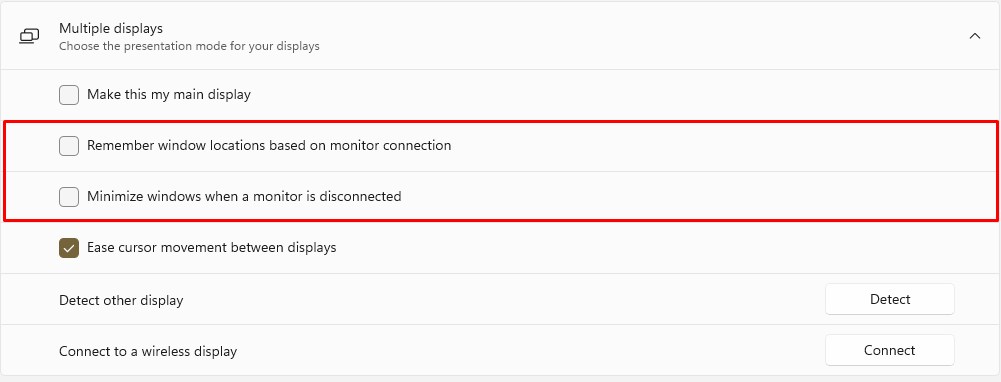

Solution 5: Cosmos Window Hidden Off-Screen
Sometimes Cosmos opens but the window is outside your monitor area. This can happen, for example, if you previously used multiple monitors.
  1. Right-click on your desktop and choose Display settings
  2. Turn OFF these two options:
    • "Remember window locations based on monitor connection"
    • "Minimize windows when a monitor is disconnected"
  3. Change your screen resolution to something different (you can change it back later)
  4. Close 3ds Max completely
  5. Reopen 3ds Max and click the Cosmos icon
  6. If it still doesn't appear, repeat steps 3-5 with a different resolution
Important: You must close and reopen 3ds Max after changing the resolution for this to work.

Workaround: Use Cosmos from Browser
If none of these solutions work but Cosmos opens in your browser (http://localhost:30305), you can use it directly from there as a temporary workaround:
  1. Open Cosmos in your browser
  2. Browse and download the assets you need
