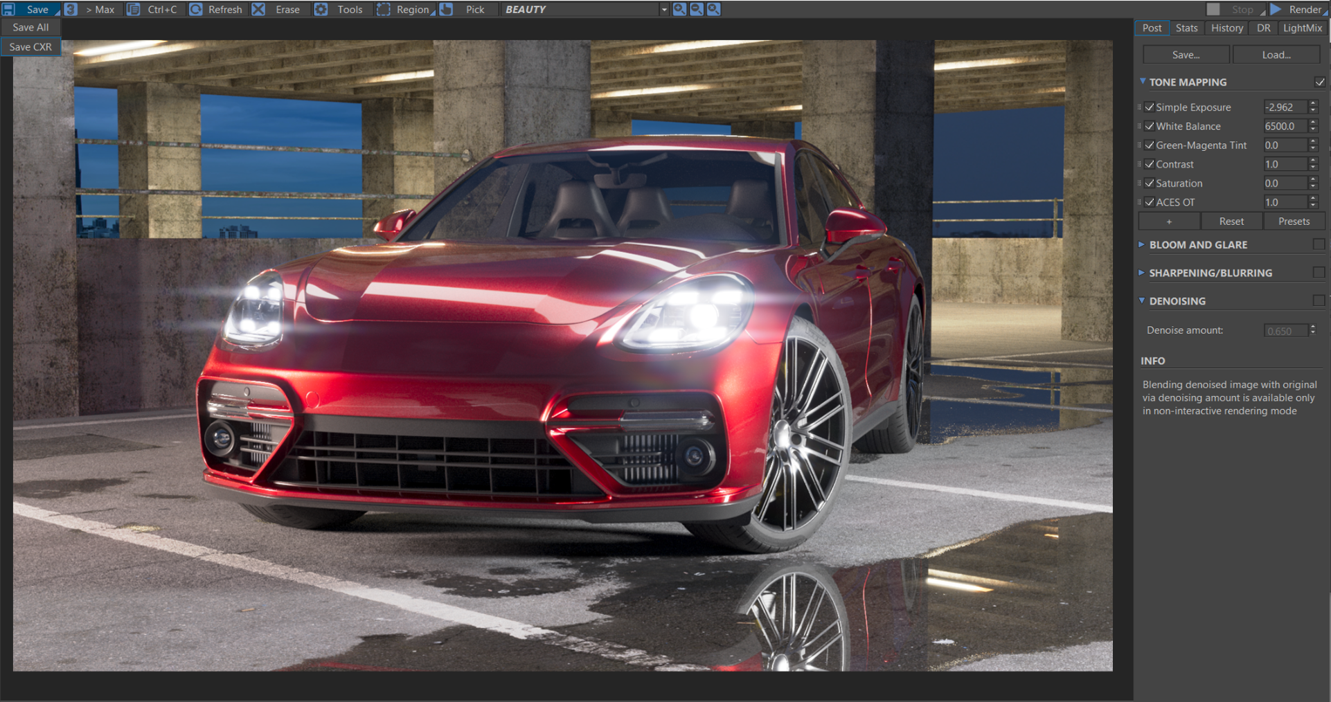

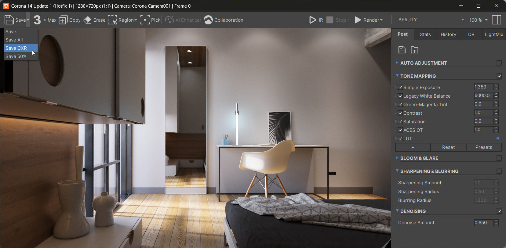

  • In both 3ds Max and Cinema 4D: click on the vertical arrow next to the Save button and select "Save CXR"

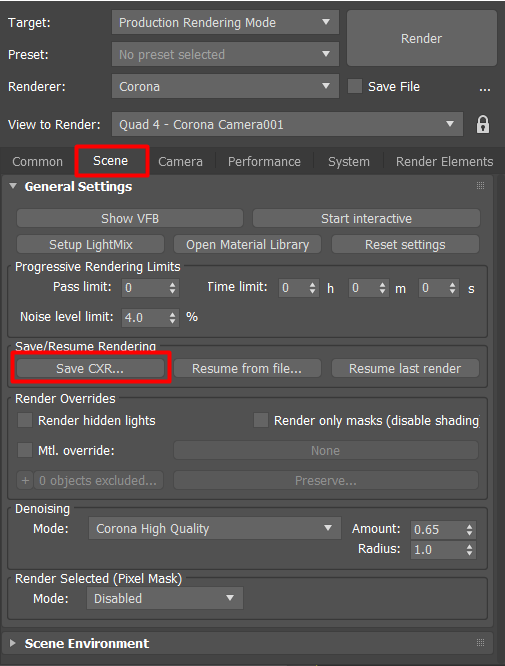

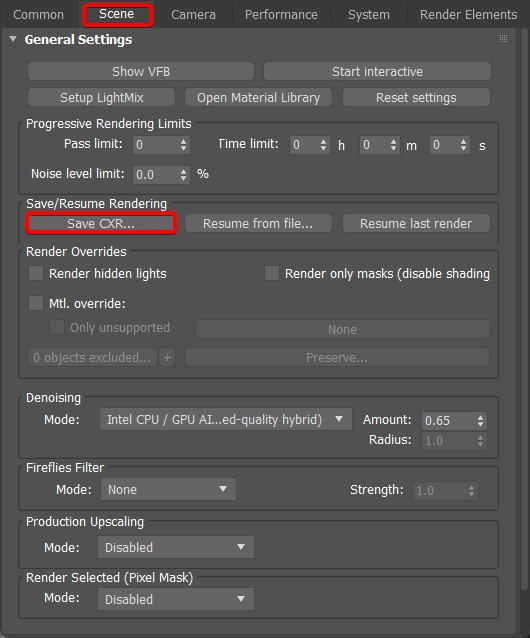

  • In 3ds Max: go to Render Setup > Scene and press the "Save CXR..." button:

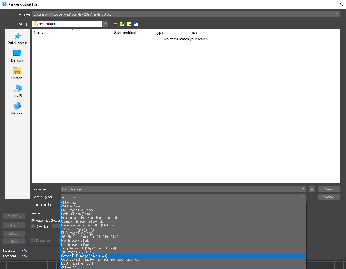

  • In 3ds Max: go to Render Setup > Common and set your Render Output to save in the CXR format. Then just render your image to have it saved automatically.

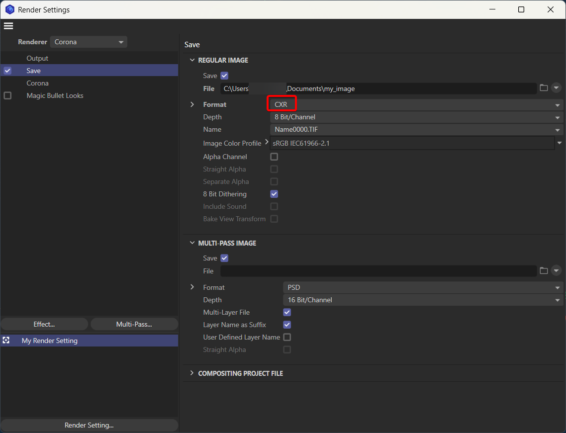

  • In Cinema 4D: go to Render Settings, configure your Output, and pick the CXR format under the Save settings. Then just render your image to have it saved automatically.
    Note: you can ignore other format settings such as bit depth and dithering - they are not taken into account anyway.

  • If you click the "Save" button in the upper left corner of the VFB, this will save only your currently visible render element ("render pass" in Cinema 4D) in the format of your choice. The exception is selecting the Beauty element and clicking "Save" - if you save to the CXR format, this will save beauty along with all render elements, such as LightMix, just like in the case of using the "Save CXR" option.
  • If you click on the vertical arrow next to the "Save" button and select "Save all", this will save each render element (render pass) as a separate file using the format of your choice.
  • If you click on the vertical arrow next to the "Save" button and select "Save CXR", this will store all the information from the VFB (all render elements, including the LightMix, tone mapping, denoising data, etc...) inside a single CXR file. This file can be used to resume rendering later, post-process in the Corona Image Editor, perform denoising later, and so on.

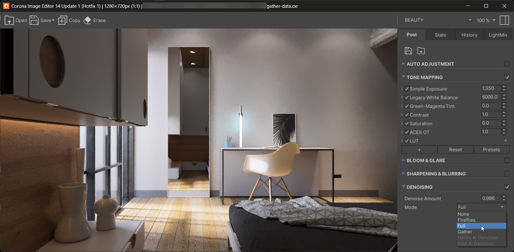

1. Denoising a CXR image
If you saved your image in the CXR format without performing the actual denoising, and with the "Gather data for later" denoising option enabled, you can open this image later in the CIE and perform denoising there. To do this, simply load your image into CIE, expand the "Denoising" rollout in the "Post" tab, and choose "Full" from the "Mode" dropdown.

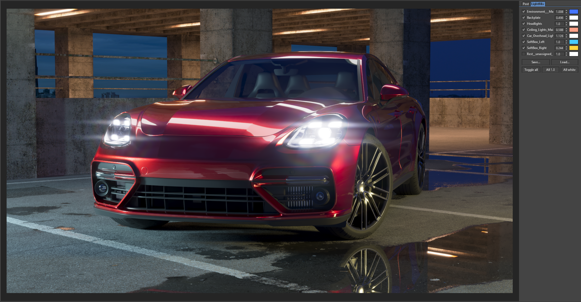

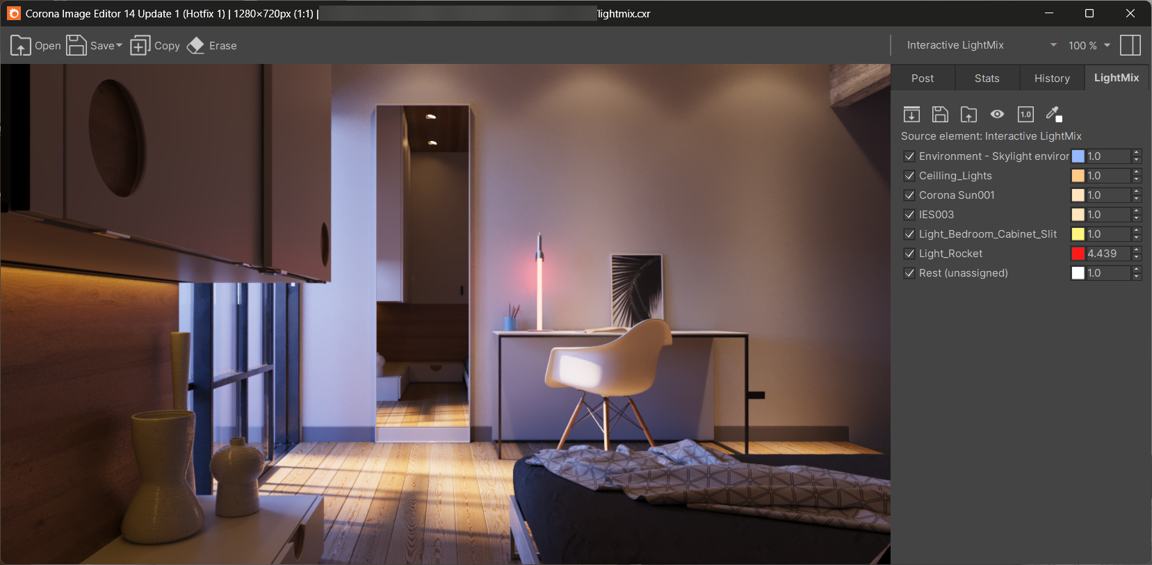

2. Using LightMix
You can save an image with all LightMix layers included and then adjust the LightMix settings in CIE. To do this, simply load your image and select the "LightMix" tab. You will see exactly the same settings as in the Corona VFB, including the options to save and load LightMix presets:
