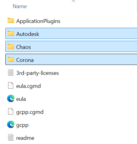

For example, the content of the "Autodesk" folder in the unpacked directory looks like this:
Go back to the root folder where the Corona installation files were unpacked, copy the folders Autodesk, Chaos, and Corona, and paste them into your Program Files folder. Usually, it is: C:\Program Files\

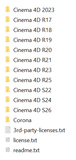

For example, the content of the unpacked directory looks like this:
The content of the Corona folder looks like this:
To install the software, move the content of the folder corresponding to your Cinema 4D version to the root folder where Cinema 4D is installed on your computer (usually C:\Program files\Maxon Cinema 4D XXXX for newer versions or C:\Program files\MAXON\Cinema 4D XXXX for older versions, where XXXX represents the installed version of Cinema 4D). The reason for 2 different Cinema 4D paths is due to a change in the way MAXON are now installing their software in the most recent versions.

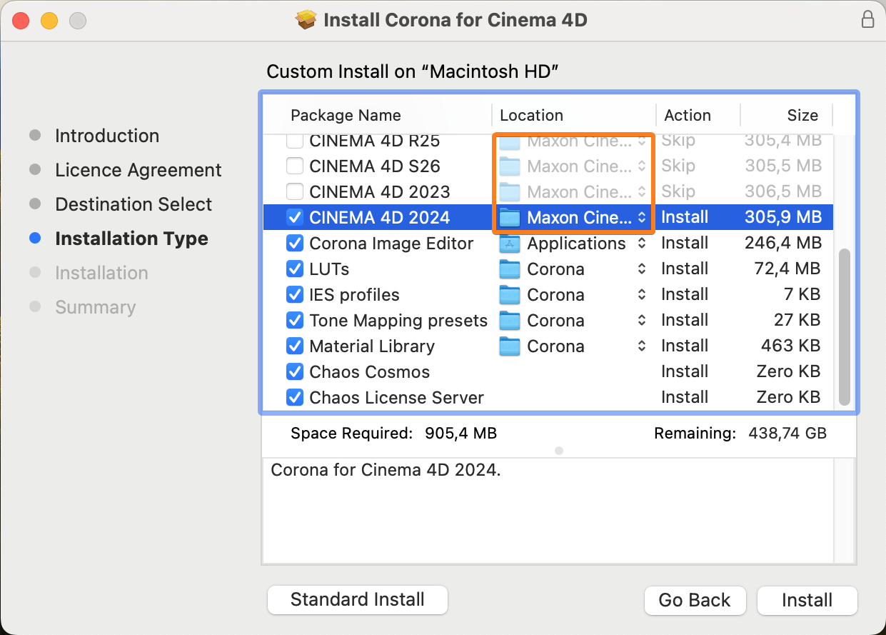

  • Enable all the checkboxes corresponding to the Cinema 4D versions installed on your system.
  • When prompted, change the "Installation path" for each Corona for Cinema 4D version that will be installed.
    Note: Define different unpacking folders for each Corona for Cinema 4D version.
  • Complete the Unpacking process.

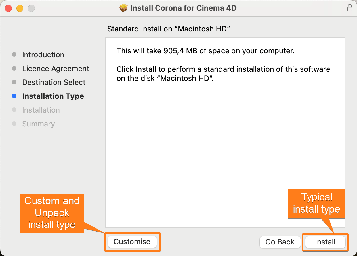

2.2 Older installer:
  • Run the Corona installer
  • When prompted, choose the "Customise" option:

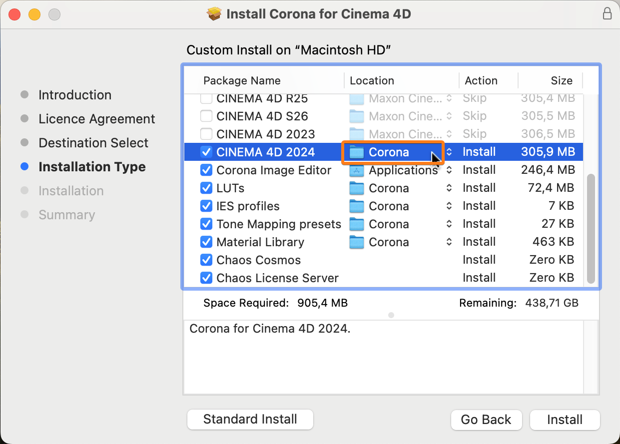

  • From the list, enable the appropriate C4D version and then change the destination folder for them, using the "Other" option:
  • Create a folder where the files will be extracted (e.g., you can create a folder named "Corona" on your Desktop) and click on the "Choose" button:
  • Click on the "Install" button to continue with file unpacking:

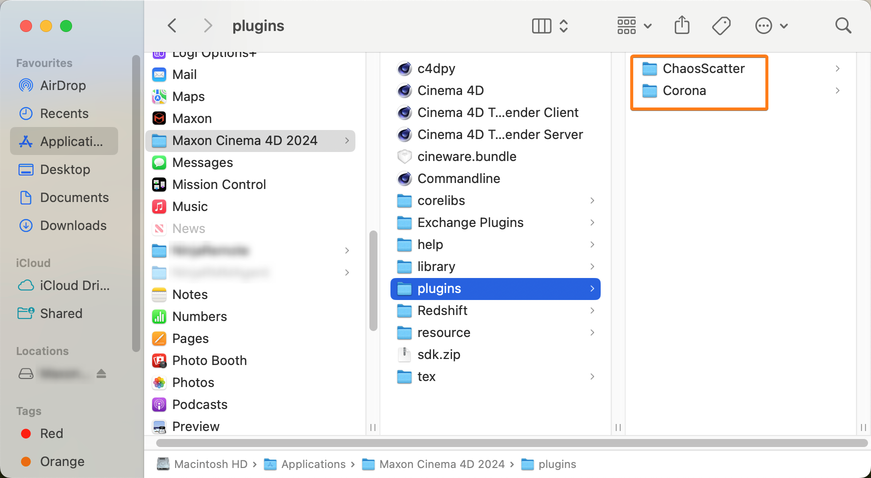

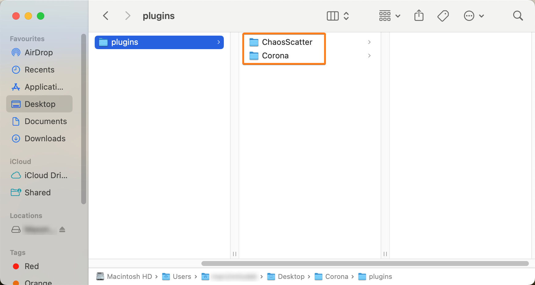

3. Installing the files:
  • Once the unpacking process is complete, a new folder named "plugins" will appear inside the newly created folder (for this example, the "Corona" folder is located on the Desktop):
  • Next, copy the contents of the "plugins" folder to the appropriate path:
    ~/Applications/Maxon Cinema 4D XXXX/plugins/
    (where the XXXX represents your installed Cinema 4D version)
  • Run Cinema 4D, and if successful, you should now see the Corona menu right in the app's menu bar.
