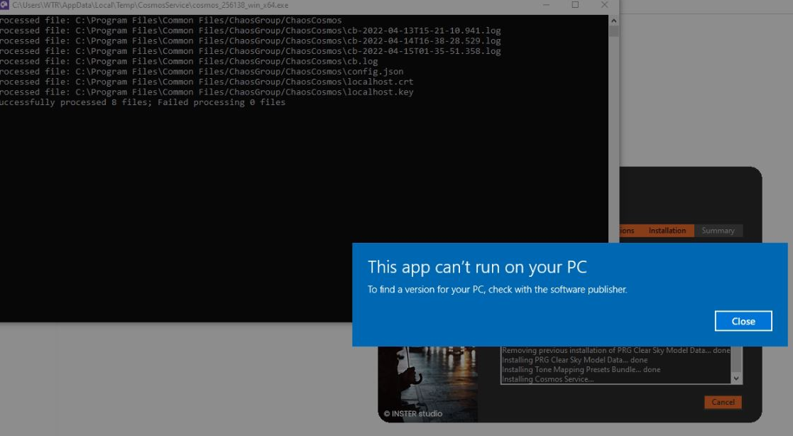

When running the Corona installer from a Network/Shared location, an error may appear:
"This app can't run on your PC. To find a version for your PC, check with the software publisher".
This may be caused by an operating system limitation related to UNC paths.
Solution:
Place the Corona installer on a local drive (C:\..., Desktop, Downloads, etc.) and re-run the installation.
